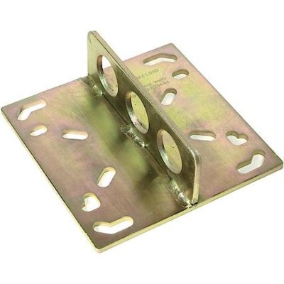

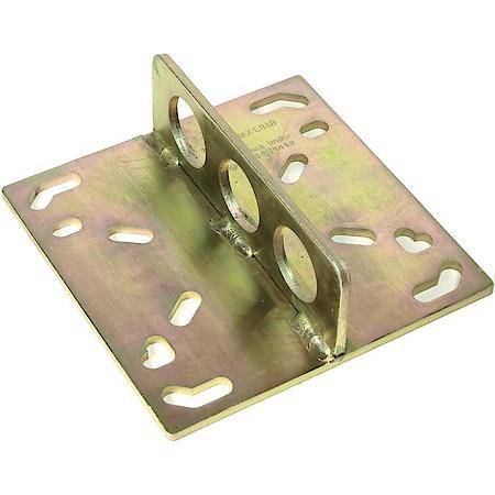

Go to local auto parts store and get one of the plates that bolt to the intake. That’s what I use.
I have that. How do I then use a load leveler with that?
Doesn’t your load leveler have a hook on the end? My plate has 3 holes on the top for the hook. My load leveler is from harbor freight and it has a hook on the end

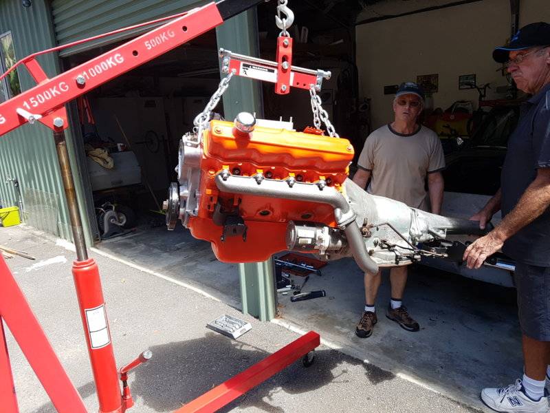

I would buy/borrow a different sort of load leveller. Mine was about $40 USD equivalent. You can slowly angle the whole lot in without stopping and unhooking.
