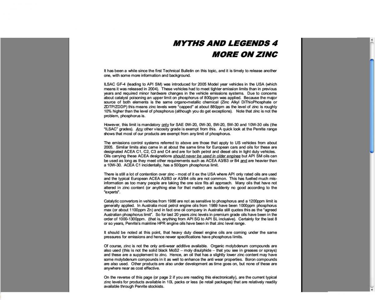

Here is the emails I have gotten from PENRITE Oil.
Thank you for the enquiry.
We recommend HPR 30 (SAE 20W-60, API SM/CF) in your engine if it is in good condition and not using a lot of oil.
You don’t need to be concerned about using HPR 40 or HPR 50 (which is the 40 w 70) unless the engine is burning a lot of oil.
I replied:
Hi thank you for that. I have been advised by charger/challenger owners that if the oil does not have a SL rating (only SM) to stay away from the oil. I have flat tapped cam and I need alot of zinc in the oil or else its useless.
They replied back:
The API SM limits on phosphorus levels (and therefore zinc) are only applied to viscosity grades of SAE 0W-20, 0W-30, 5W-20, 5W-30 and 10W-30 oils. Any other grade is exempt from this limit.
Hence, HPR 30 is our recommendation for your engine. This product actually has 1580ppm of zinc, so please be assured that there are no problems using this product. HPR 30 meets more than just API SM. It meets API SM/CF and ACEA A3/B3 – this does make a difference.
Please find attached the technical bulletin on zinc levels for your perusal.
Is that good enough oil and zinc? 1580ppm?
Read attached files and chart. Notice HPR 30 (20 w 60) has more zinc than HPR 40 (25 w 70) by near 500 and HPR 50 (40 w 70) has the most zinc by near 200 over HPR 30.
Mechanic told me to still use HPR 50 because it will mean less friction which then means more horsepower. Hes done half million dollar cars with that same stuff and even got offered to work for the big Rolls Royce company down here. So is there a chance that hes found soemthing that others just by using logic think wont work well?

Interesting where it says "only applied to viscosity grades of SAE 0W-20, 0W-30, 5W-20, 5W-30 and 10W-30 oils. Any other grade is exempt from this limit."
So theoretically Pennzoil 10w30 would have low ZDDP, and straight 40w or 50w COULD HAVE high levels of ZDDP.
So the question is, if the oil companies have to remove it from most of their product, WOULD THEY continue to add it to the rest of their product?
Dont know. All I know is their HPR 30 does have a 1580ppm level of zinc however they measure/label their stuff.
is 1580 zinc enough for the 383?
is too much zinc bad since 1200 is "recomended" or its better if there is more just not less?
