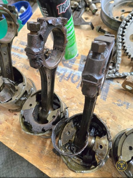

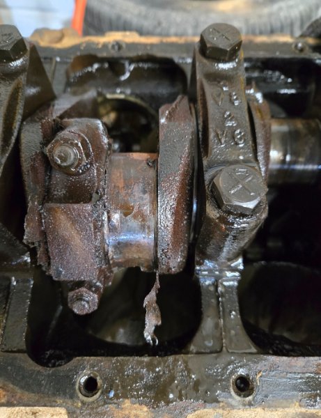

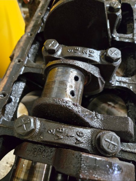

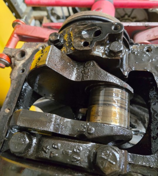

That depends....So the engine is apart. #3/4 rod bearing were spun and melty. Journal on the crank looks like you would expect it to look. Also, #8 rod journal is grooved and catches a nail.
View attachment 1945617View attachment 1945618View attachment 1945619View attachment 1945620
Also, there is a tight spot when turning over the crank with a wrench. I haven't pulled the caps off yet but they are loose.
Block looks fine.
I can get a remanufactured short block for $1059, or do I have this machined and worked on?
Do you trust the rebuilder?
Do you have a competent local machine shop/crank grinder that you trust?
Does it look like you'll need to bore it, or just re-ring?
In the old days, I would have just bought a crank kit from a rebuilder shop, and sized a couple rods (or bought a couple already done).
