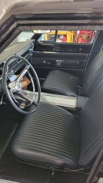

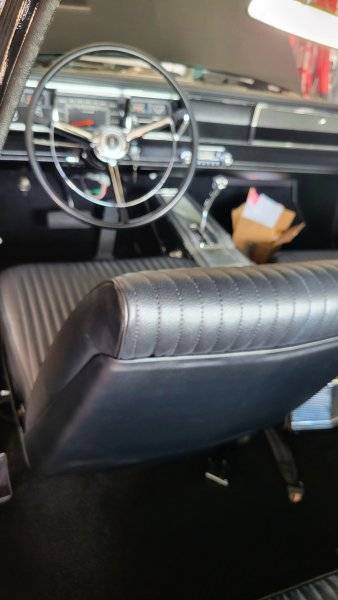

I don't do it for the money. That's for you purists. I build something because i like it. I do it for my enjoyment. Everybody has seen roadrunners, gtx's, coronet superbees/r/t's etc. I'm sure people would be intrigued by a 1967 4 door belvedere, with a big block, with a 67 GTX interior. Btw, the back seat will be a gtx rear seat with the seat surround. The bezel is being rechromed, trim holes will be filled. I contacted yoast fabrication ( yofab.com) i'm having a belvedere emblem made 1.2 inches tall, 5 inches long. It will go where the gtx emblem goes on the bezel. I won't use gtx, or satellite because i don't want to catch **** from the cool kids

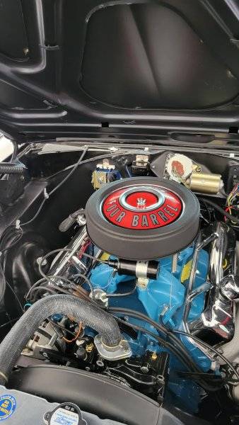

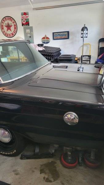

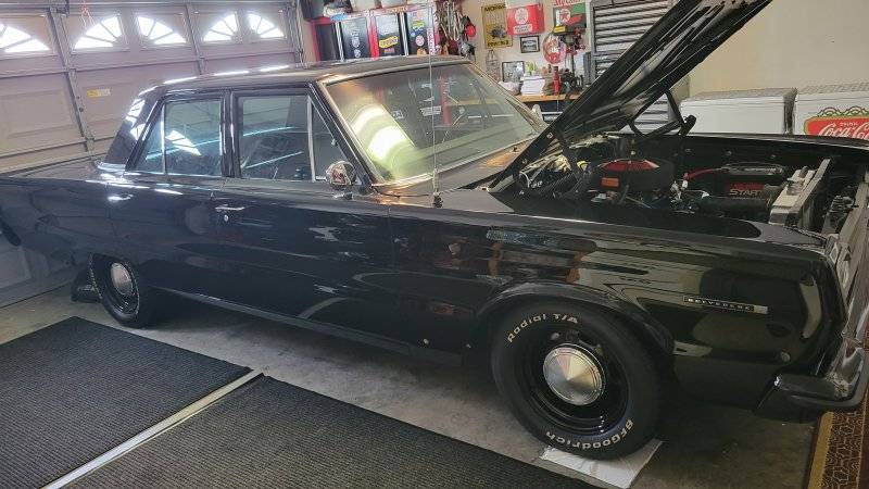

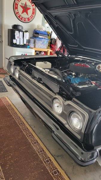

375 horsepower black 4 door 1967 plymouth belvedere

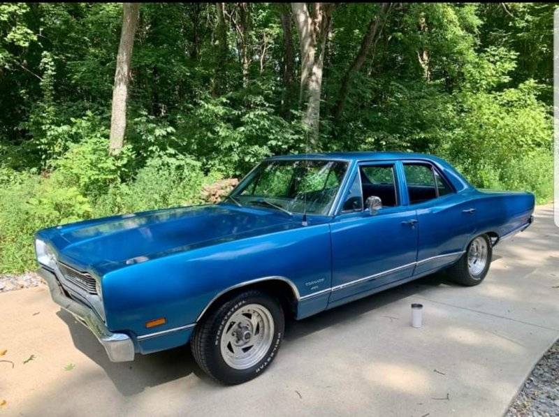

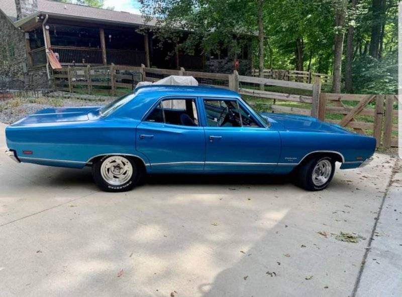

Wow. I want to thank you all for your input. I'm not a secret millionaire or a 16 year old newbie. I chose 69 because it was the year I was born. I refuse to pay the inflated prices on a Charger. I should have gotten one a few years ago before they blew up. I looked at other Mopars from 69 but as one person said, you always see them. Then I came across the 4 door Coronet. It's got the look without the price tag.
Since I'll only be doing cruise nights and the occasional short distance road trip, I'll see what I can get out of the 318. That'll free money up to spend on suspension, interior upgrades, and wrap.
Oh, here's a couple of pics.
Since I'll only be doing cruise nights and the occasional short distance road trip, I'll see what I can get out of the 318. That'll free money up to spend on suspension, interior upgrades, and wrap. Oh, here's a couple of pics.
Nice color on your car. Looks great too.

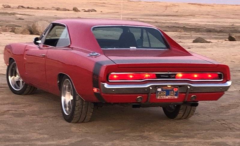

I see this frequently....A guy buys an old Mopar and says that he intends to swap in some aftermarket front suspension kit in it.
These guys rarely seem to have thought it through. They often think that if it is NEW, it must be better. Their old car is all over the road, the tires squeal when turning and since it needs to be rebuilt, why spend the money on restoring old technology?
Here is why:
When the car is rebuilt to mostly stock specs and aligned to modern standards, the ride and handling are amazing. Mopars had better geometry and durability than most other American cars of the same era. The Mopar torsion bar suspension is designed for these unibody cars to keep the weight low and toward the rear. Coil over kits move weight forward and up. Their manufacturers brag about weight savings but the comparison isn't apples to apples. They weigh a power steering equipped stock setup to a manual rack and pinion coil over setup. Of course their kit weighs less. Try comparing your stuff to a manual steering car and the weights are not that different. The coil over kits do have better exhaust clearance but so what? TTI and Doug's make headers to fit any chassis anyway. The coil over kits are not as durable. The suspension travel is less than stock. The turning radius is often wider than a stock torsion bar car. The coil over kits often cost upwards of $4,000. A stock rebuild can cost half of that and provide a great ride, durability and handling while saving a bunch of money.
If they were better, I'd be happy to endorse their use. I'm not married to everything that Mopar did. I support aftermarket brakes and transmissions in the classics because they do provide actual improvements over stock stuff.
I run larger torsion bars in my cars along with big sway bars and good shocks. I also went with the improved Borgeson steering box in my red car. The car drives and rides quite well.

You can make your car ride and handle like mine on a modest budget. From the driver's seat looking forward, It will look and feel like a Muscle Car.
A great recipe:
Stock replacement lower control arm bushings.
Moog K 7103 offset upper control arm bushings.
Urethane strut rod bushings.
PST 1.03 torsion bars. Helwig 1 1/8" front sway bar. HD leaf springs, 3/4" rear sway bar. Bilstein shocks.
You can have decent handling with a 15" tire but it will not be as responsive as it would be with 40-45 series rubber.
