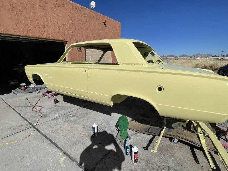

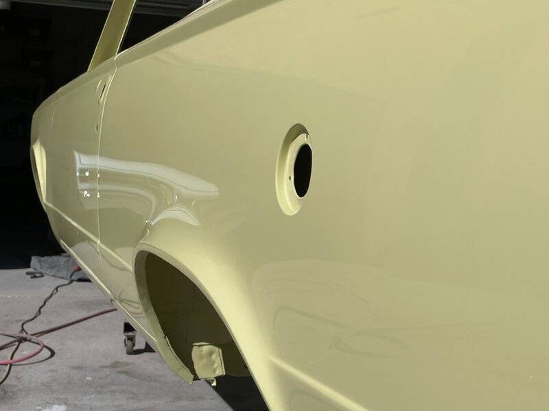

Epoxy first. It is what seals the metal. Filler on metal can get moisture behind it (think rust pinholes). Of course here in Az you would likely never notice! Make sure you follow any recommendations by the epoxy manufacturer on windows or sanding grit for adhesion for the filler over epoxy. My current project.
View attachment 1246983 View attachment 1246984
Jim nice proj. Is that a Duster? What coating are we looking at? I see a gloss type finish there.
Beautiful job
66 Valiant. Motobase yellow base and SPI Universal Clear following Barrys “Perfect Paint Job” directions
