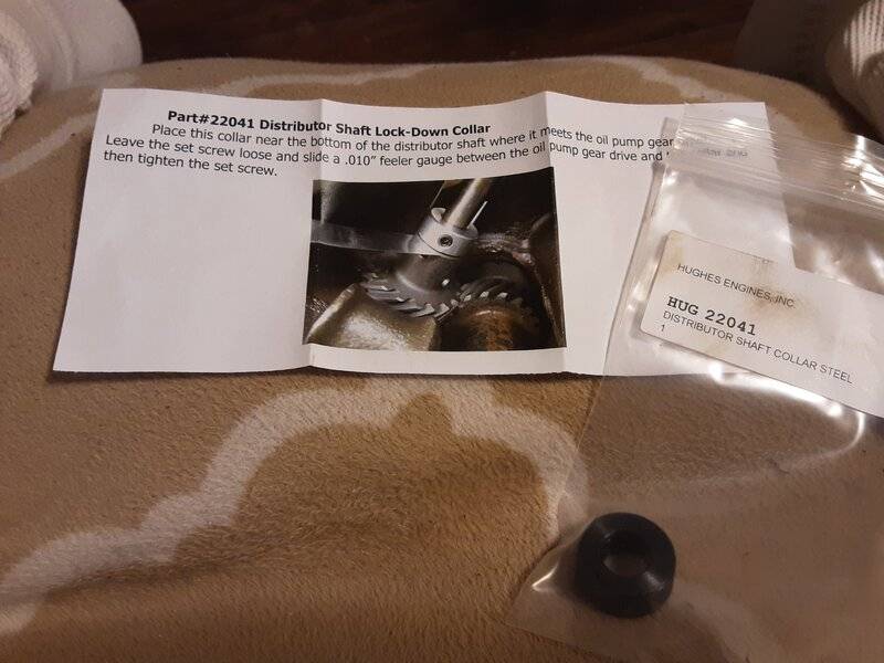

    Hughes sent this with the cam kit i I bought for the reason you're describing, I called to check what its purpose was for, maybe is the reason why you have the problem of the shaft moving and fluctuating timing

      Had that exact problem on a new big block build last year. The guy who built the motor had me ship it back to him in California. He tore it apart, changed parts to lower the compression because he thought that was the problem. Put it in the dyno, and it still detonated above 2500 rpm. That is when they found out the dist shaft was riding up and adding 10 degrees of timing. He put one of those collars in and solved the problem. Expensive education for him.....

        I’m not sure but I’s deffinitely not anything new. Looks like it could be original to the block or there about. So I guess that could be potential cause of my problems
