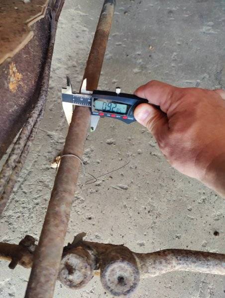

I'd rather have .092 bars than .090 bars, same with the leaf springs.
So numbers matching show pony you will not have. Cool road going Charger is never a bad thing.

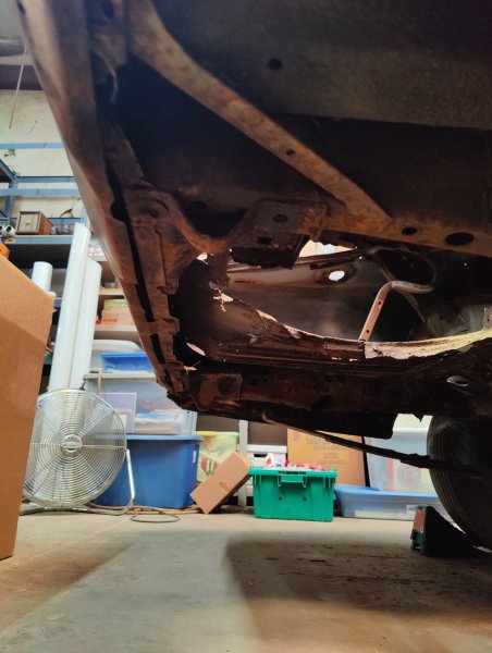

440/727/8.75, A/C Column shift, power drum brakes, folding buddy seat.. Not much doubt it's an R/T but missing the VIN tag so how do you prove it... How do you go about getting a VIN assigned in Illinois? Can you get an assigned VIN without getting the car impounded? I wonder if the VIN tag & Fender Tag sold on Ebay... The car doesn't look bad for being in the Chicago area & I don't see why someone would have separated the numbers from the body...
The dash and tag are probably cruising around or at a carshow right now..
But the rear pic of the car... are there R/T holes in the tailpanel?
I think so, but it's not a great shot to determine that..
From the few pics you have posted, I would agree it sure looks like a R/T. Not that it really matters, because you can't prove it. How exactly are you going to get a title for the car without the VIN tag? Definitely don't stick a penny in it until that is squared away.
