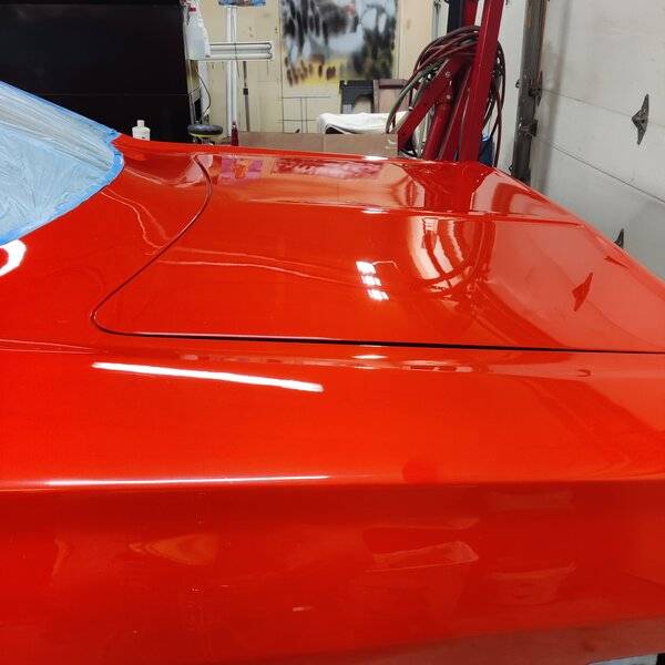

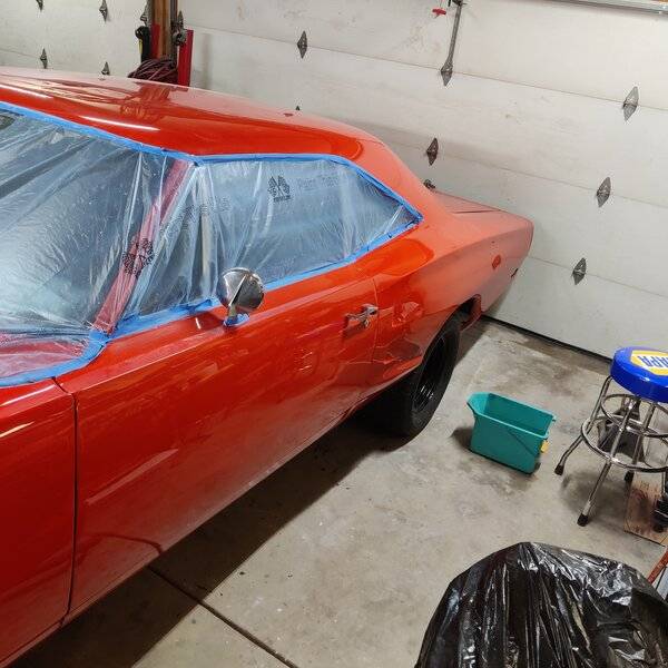

For sure!! It takes talent to do any kinda work yourself from scratch, or you're doomed. But keep in mind, thinking of a guy who's worked at a body shop and is considered a pro....... he was taught the quickest, most economical ways to make a living, and make money for the shop...not necessarily in that order lol. And certainly not necessairly what's best for the job (CAR). A talented devoted amateur can pull off detailed work like Chongo_68 has shown above. Research and some practice on less important pieces will go a long way towards a great job.

I learned a lot from Kevin Tetz videos. He did a series a few years ago using Eastwood products and he shows exactly what he used and explains why. Whether you use Eastwood products or not, he shows a lot of techniques and product tips that are very helpful.
My thought is, if you’re going to spend the time, effort and money to strip and prep, don’t skimp on the paint.
