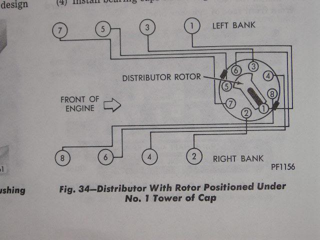

Well I started the car for a Sunday show and it was excessive back firing thru the carb. I mean really bad. Looked at the plug wire positions on the distributor cap, they did not match the shop manual. The plug wires are in the position they were when I got the car two months ago. I moved all wires to match the shop manual, now the damn car will not start. PLEASE HELP!!
Did your timing chain jump? is a possibility Thinking spark plug wiring is not correct.....B/RB/Hemi engines have a CCW distributor rotation....Firing order on 440 engines is 1 - 8 - 4 - 3 - 6 - 5 - 7 - 2...Pull dizzy... Crank Motor over #1 is on compression cycle..Rotor should be inline with the #1 spark plug wire..
Firing Order
For all engines 1-8-4-3-6-5-7-2
Left side cylinders are numbered (from front) 1-3-5-7
Right side cylinders are numbered (from front) 2-4-6-8
Thanks Pops. Will do tomorrow.

It sounds like it's way too retarded. Don't forget the famous KISS. It's not likely anything suddenly changed in your valve train if it was OK before. The dist may have been installed incorrectly. It's OK to move the wires around the cap as long as the order is correct. That may have been what was done in order to get enough advance before and you just put it back with less advance. Loosen the dist and increase the advance when you try to start it. The idea about finding TDC is your best trouble shooting bet. But to get it going just try putting the wires where they were and advancing it.
Easiest way to find TDC is pull the driver's side valve cover and turn it over until both valves are closed, and piston is at the top of it's travel. Then the rotor should be pointing at number one on the cap.

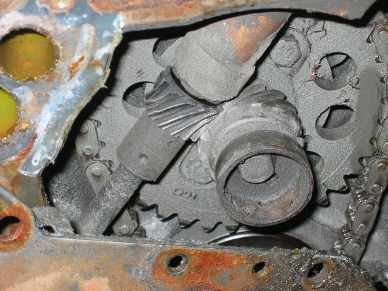

I had a 472 Cadillac engine jump time after 15 minutes of running due to a stripped distributor gear, from lack of oiling. When I got it at TDC as described, the rotor was pointing a couple terminals off from TDC. Assumed it was timing chain until I saw the tomb.......
:eek:ccasion17:
So it's safe for me to assume all is steel with the gear, chain and distributor?

Thanks to you good folks and these guys. I did the finger set for # 1 TDC. Hit 10 degrees, set the number 1 by the rotor location. Relocated all the wires. She fired right up and no BF through the carb. Will complete the rest tomorrow.
Thanks guys!!
Did a short test drive last night. Felt a little sluggish and slow restart. Bumped the timing to 14 degrees BTC. One more time around the block. Bumped her to 17 degrees. Last lap and she is strong. Restart just by leaning in the car and turning the key. Gave her some gas to about 4500 rpm, no back fire and she sounds awesome. Thanks all. Now where did I put that kick panel insulation? :icon_scratch:
