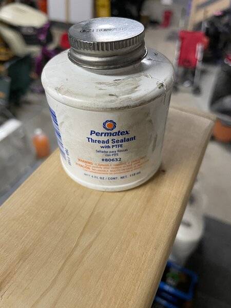

I have one bolt on the passenger side and one on driverside that are leaking coolant. I’ve tried the stuff in the white jar. Is there can I use the stuff in the tube or what is a better option.
Seal them. They screw into water jackets. Like @padam suggested, use high temp because of the close proximity to the exhaust ports.
I used the stuff in the white jar but it’s still leaks. I let it set up before putting water and heat back into the motor
