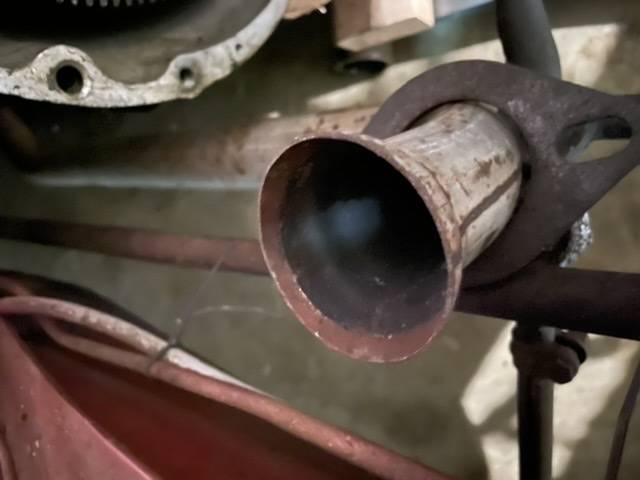

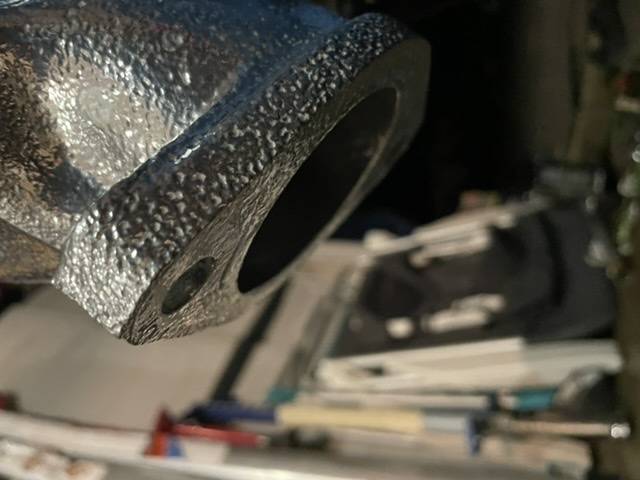

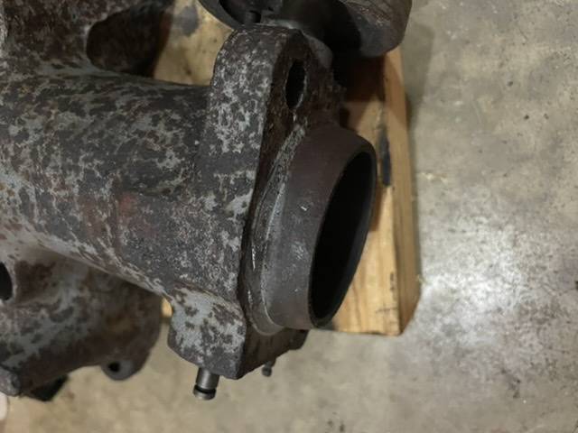

Changing out my log manifolds for HP manifolds on a 383. The head pipes to my exhaust are flared. The log manifolds have what looks to be an insert in them to mate up with the head pipe and the HP manifolds are flat. What do I need to get the HP manifolds to do the same? My googling skills are failing me.
Casting numbers determine head pipes sir. HP manifold have a different angle so getting the old pipes to fit is not going to work.
TTI exhaust makes head pipes to match HP manifolds, you need to have the casting numbers for the correct pipes.
Mark
Its either that or a trip to your local exhaust shop
That's where I'm headed, thought there might be a tapered insert or something I was missing. Looks like that's what I have in the log manifolds that came out. Thanks all.

ECS has exact factory correct 383 HP head pipes. I know because they used mine OE's to make their jig !
The outlet diameter is MUCH larger on HP manifolds requiring different manifold to pipe gaskets and head pipe / flanges
