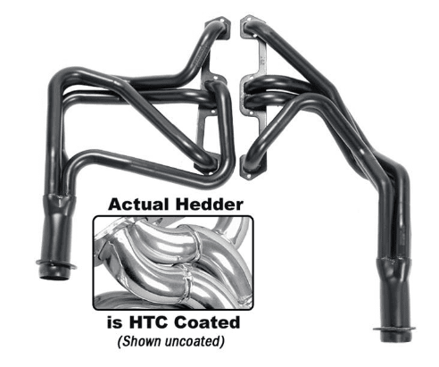

MANY small block headers route three of the driver side tubes below the steering linkage. See picture below:
I DO NOT recommend headers like this, as the three tubes below the steering linkage sit really low, create clearance issues and regularly smash into the ground. Find headers that route differently than the picture above. Also, for your 318, if you have a choice, pick headers with a smaller rather than larger primary tube size.

Thanks for much for the detailed response. Do you happen to have an example of the headers you are talking about?
The headers pictured in my post above (and again first picture below) are Hedman Street Headers 78056. I suggest you avoid those headers due to clearance issues. But there are many other headers that route the tubes the same way. Use the picture as a reference, and if the driver side three tubes look similar (where I circled in red), then stay away. With these headers, your steering linkage sits above the three tubes, so in turn the header tubes have to hang down really low.

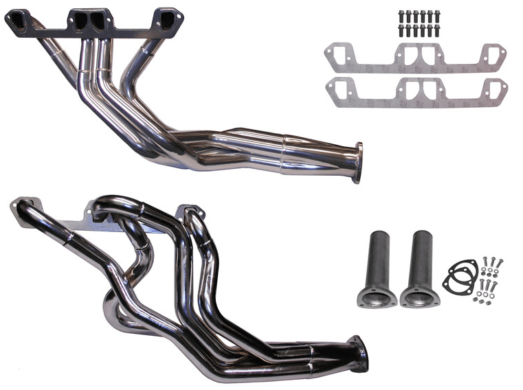

Below is a picture of TTI headers for your application. Note the difference in the routing of the driver side header. TTI headers are, in my opinion, the best headers you can get (although they are expensive). But there are other brands of headers that will route the tubes above the steering linkage similar to the TTI headers.
Bottom line is avoid headers that look similar to the first picture. If you start looking at some headers on-line, you'll easily notice the difference.
