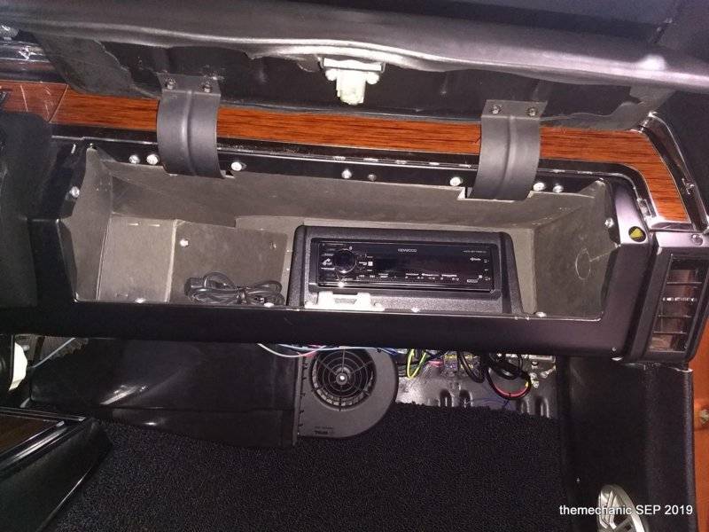

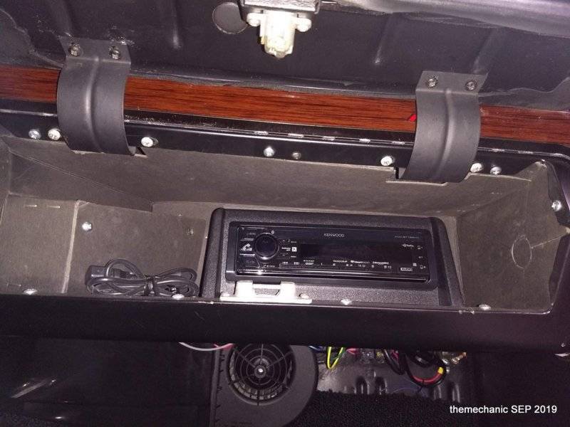

Did you post a thread somewhere on how you installed your radio in the glove compartment? Looks like something I would like to do in a couple of my cars.
Nope. I just used an under the dash plastic enclosure. I had it mounted under the dash but decided later to hide it in the glove box. I had to cut out a portion of the rear cardboard glove box for clearance and wires. One drawback to mounting it in the glove box is the IR remote does not work when closed. I've been looking for a RF remote solution.
Here's one like I used
