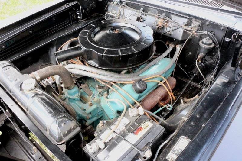

sorry for multiple blank replies- my computer keeps deleting the post before I can reply. I had to re install the brake line I made- I can't do a replica of the factory line with the engine in it. I couldn't tell if the covering on the brake line was coil wire or heat shield, I do recall the coil sections over the area where rocks may damage. thinking of getting spark plug wire heat shields and put them over the brake lines in critical area's. the disc brake changeover looks tempting but $$ is to tight to do that now. the new brake lines with painted? covering turned out to be the leak issue on the Dodge, when I flared the line the paint covering stayed and paint chips allowed it to leak .done over I scraped all the painted surface off at the flare.my goal now is just to get it back on its feet

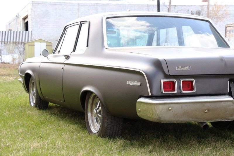

I think?? I sent you a PM. my only and last project is my '64 Dodge 330 sedan, having real steering issues though. the drag link is in a bind when the idler is hooked up? VERY hard to turn the wheels, even off the ground.

No not the steering box, I just put a new one in. the problem seems to be in the idler when it is tightened it locks the steering, with the fittings loose it does not want to align with the tapered hole in the drag link and in the cross member- I ordered a new idler- hoping this one is bent , if it isn't that means the cross member is bent at the anchor for the idler.
the idler on this car has a single point taper anchor point, .I may have to get a new cross member.

I don't think I'll need that but thank you. it looks like the former owner mixed and matched parts, wrong oil pan, with tie rod rubbing on it, -many other details, but I'll get through it, I enjoy the chase..
