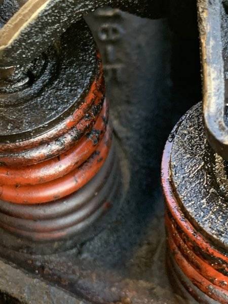

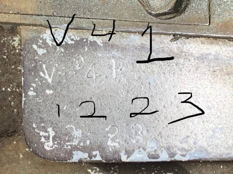

Hey wheatdog, I recently picked up a 64, 413 and thought I had the 518 heads just like you thought, but that 6 looks like and 8 and really takes the wind out of your sail when you realize they are 516 heads.
Im looking to put aluminum heads on it, just a fun/reliable street machine that won’t break the bank any suggestions
thanks

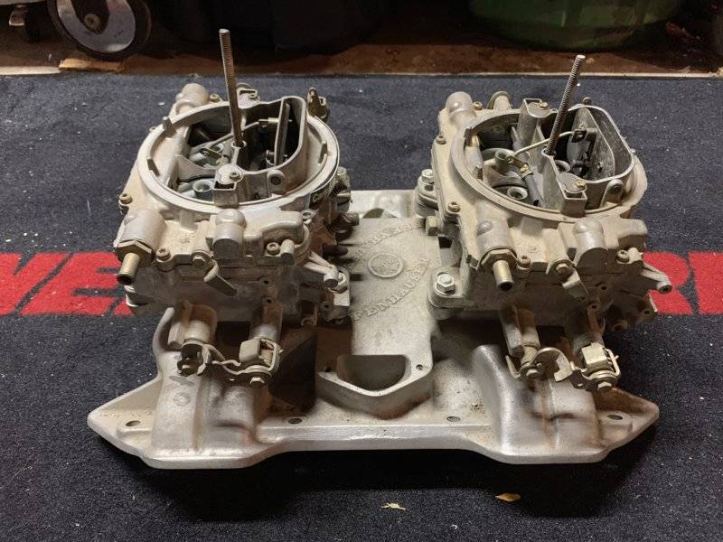

I was going to have my 516s done with harden seats but their talking $750 to $1k around my area. I saw the heads at 440 source $1k and I think that’s the best route for me. I have a dual quad setup to top it off, which I think will work better with the aluminum heads.
Very cool carb setup! Looks like a vintage manifold. Get them jetted right and it'll run great. There's a couple of pair of 452s with the hardened seats on ebay. One set looks pretty clean for $375 but shipping's high due to weight. If the 1K for the stealth's don't hurt the budget too bad, stick with them. Far superior heads. I may rebuild my 413 and put it back in the polara. I went way overboard on the 512 I built and it makes insane power but I'm not racing and 650hp is a bit much. Changed out my 3.73 rear end to 2.76 to get the rpms and fuel consumption down. Besides, I had to be real careful with the throttle with the 3.73. Back end would break loose every time I pushed a little too much on the gas.

Thanks wheat, yes that offenhauser was a swap meet treasure I found. I’ve seen the 452’s on Craiglist and all said 45k miles lol... you know how a budget works when you want it bad enough you’ll find the $$.. if it’s between 350/450hp I’m happy, no more 650hp animals for me. I’ll have some fun with the 3.55’s in it now and then see about the 2.76 on the shelf and do what you did. But a 50mph burn out is always a sweet thing hahaha...
