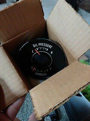

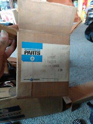

Anyways my factory gauge like the box picture was used with Tach/Clock option
75 psi = 4th line pointed at U in Pressure
25 psi = 2nd line pointed at R in Pressure
