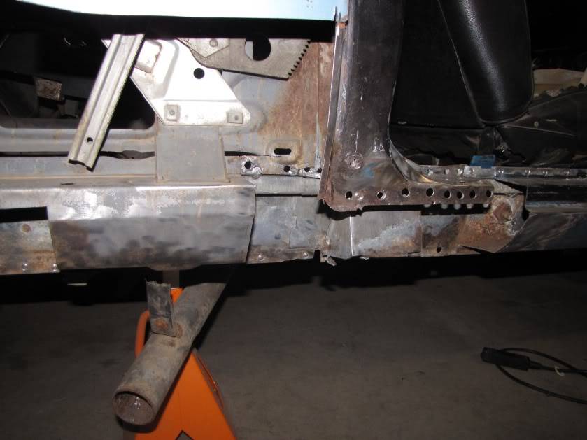

Started sectioning out the rocker. I'm not lying when I say it is a real pain in the rear to remove the rocker area from the jam back. The upper lip of the outer rocker is sandwiched in between the interior rear panel and the inner rocker panel lip. it's spot welded, double spot welded and goober welded from the inside out...Tons of grinding, cutting, and drilling just to get the small area I removed. And trying to remove it without destroying apposing metal is another treat.

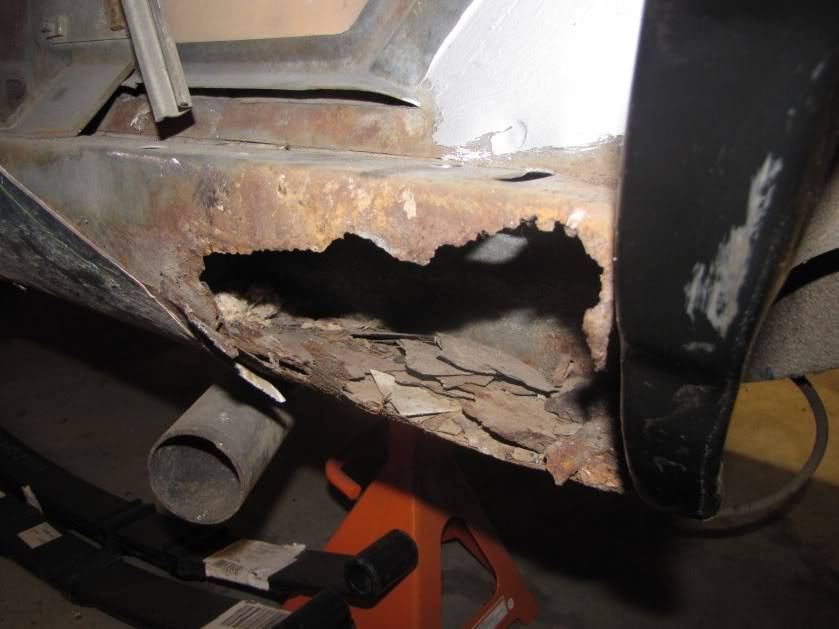

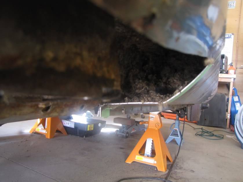

After opening up the rocker, looks like this was quite a "mouse house" for a while. Filled up almost half of my 30 gallon shop vac getting it out of there.
I decided to avoid the whole sandwiched area and cut out on the side edge down to the bottom seam on the rear repair. The rotten chunk removed typical to "rustbelt rot" came out pretty easy
The section cut out forward of the rear was the pain in the rear......Since the outer rocker is good north of this section, I will acid etch inside the rocker, rust proof, coat with rust bullet and then undercoat inside and call the right side rocker done as soon as the fresh metal is in.

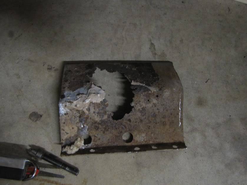

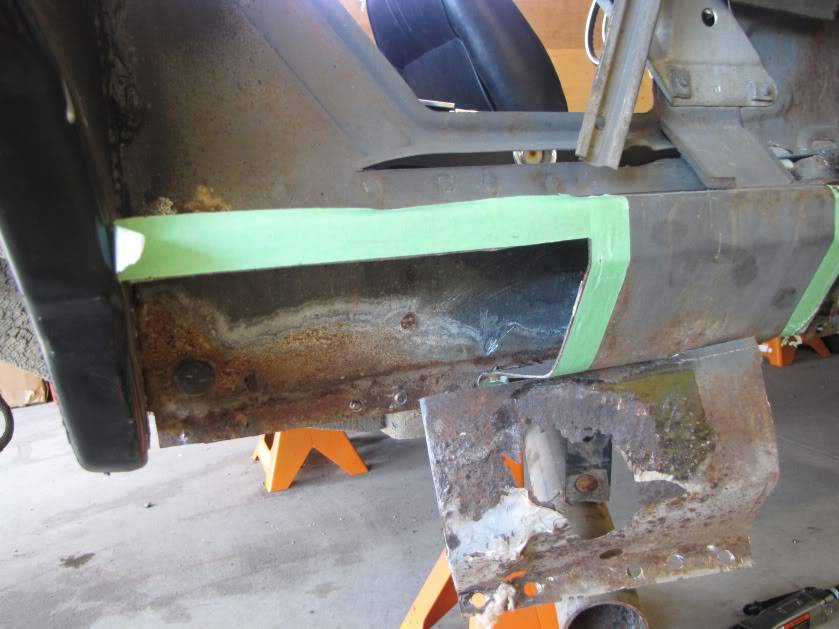

This is the old rear chunk of the rocker I cut out.

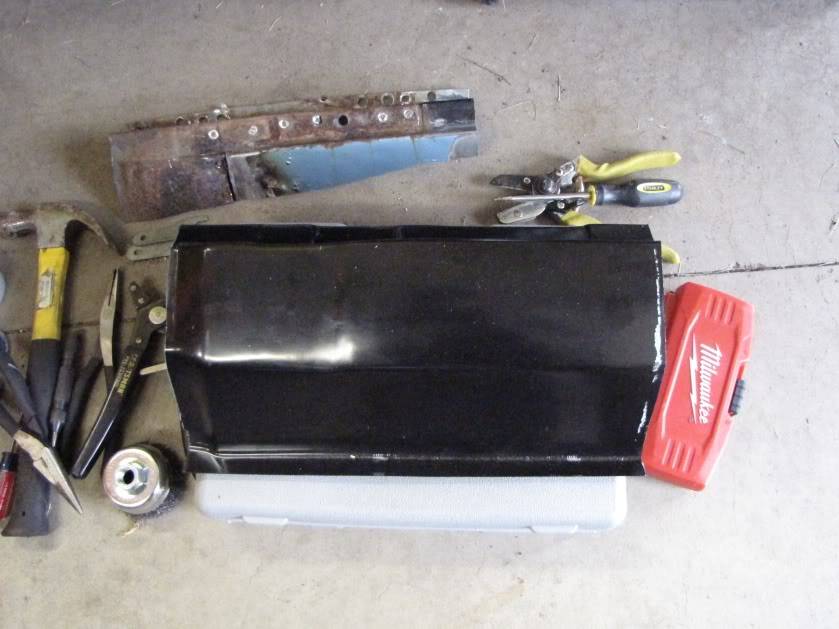

After cleaning up, treating, and coating rear repair section area, I cut out a section of new metal from a AMD set of new rockers. Still trying to save as much "original metal" as I can.
Rough finished product for rear repair area
Done Deal!

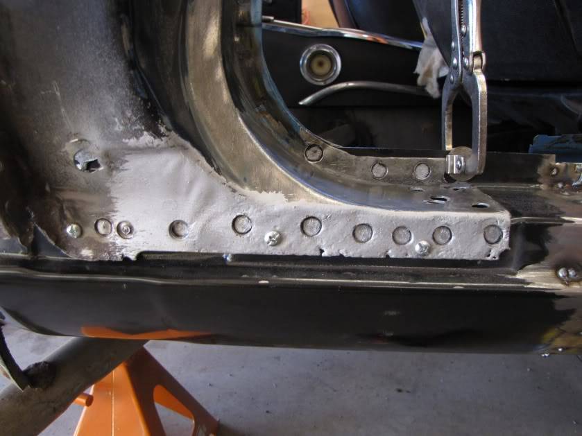

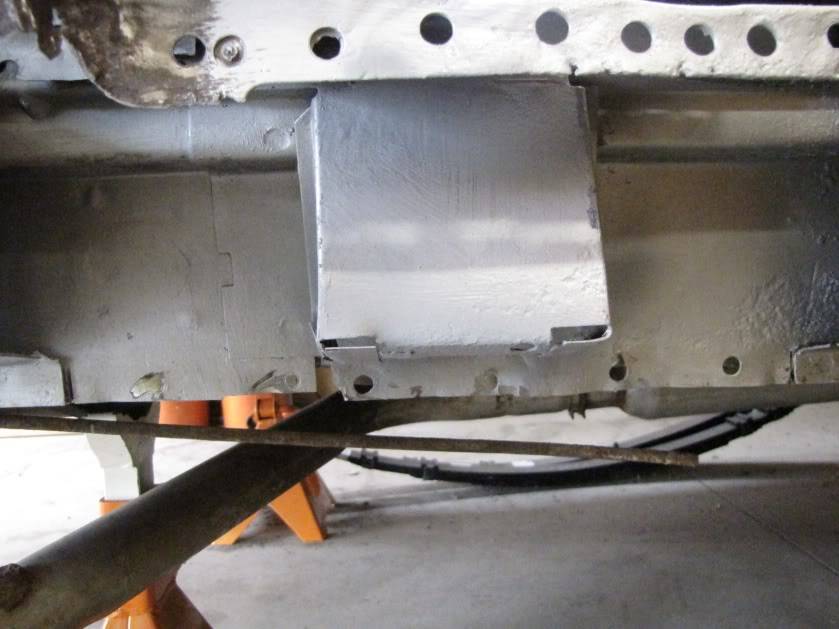

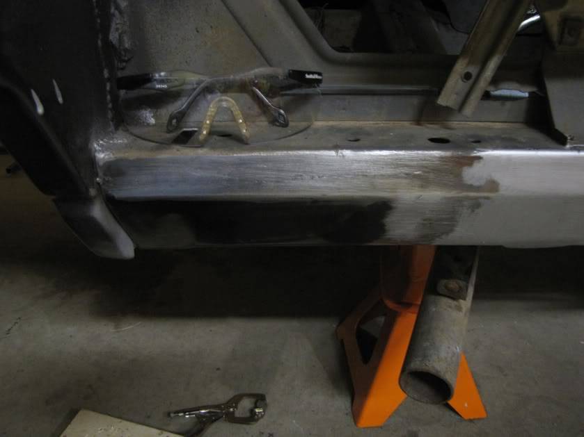

Some pic's of tossing in the forward patch section:
The little torque box that's tied into your interior panel structure and on the bottom side, welds to the rocker panel.. Used a plum bob to the floor to mark location for the mating surface. Temporarily installed the patch, used the marks off the floor and the plum bob to mark locations on the patch where I need to drill the holes.

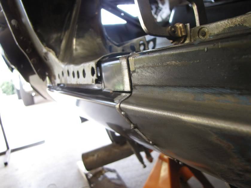

Fit up was going good, 75% perfect line up with the AMD section until I noticed on the 90* down the side, the AMD patch section is not quite 90* like the factory and the step down from that has a little too much of a pitch as well
I used a Dremel and a very small cut wheel to cut in a relief cut so I could work the metal a bit closer to interact better with OEM.
After tenderly working the metal/cut with a body hammer, dolley and a vey small screw driver, I got the new to old to line up

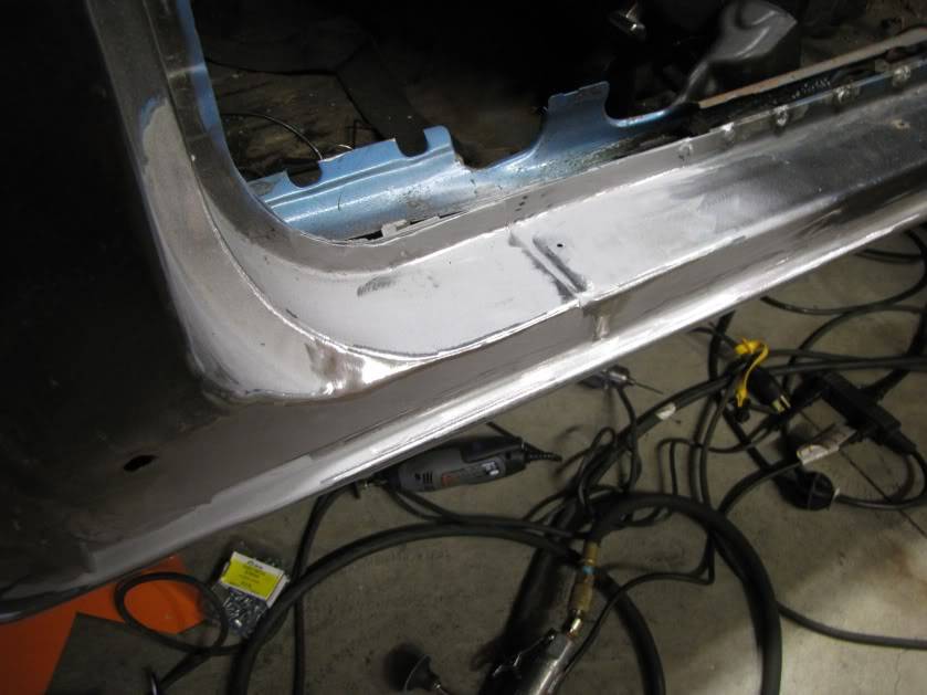

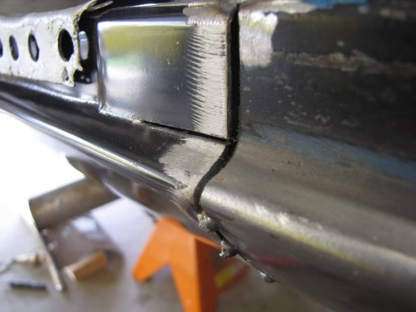

Just a pic of getting close to metalwork completion. Front weld ground flush, then a few tac's to fill in a several pits. Back needs to be ground down flush yet.

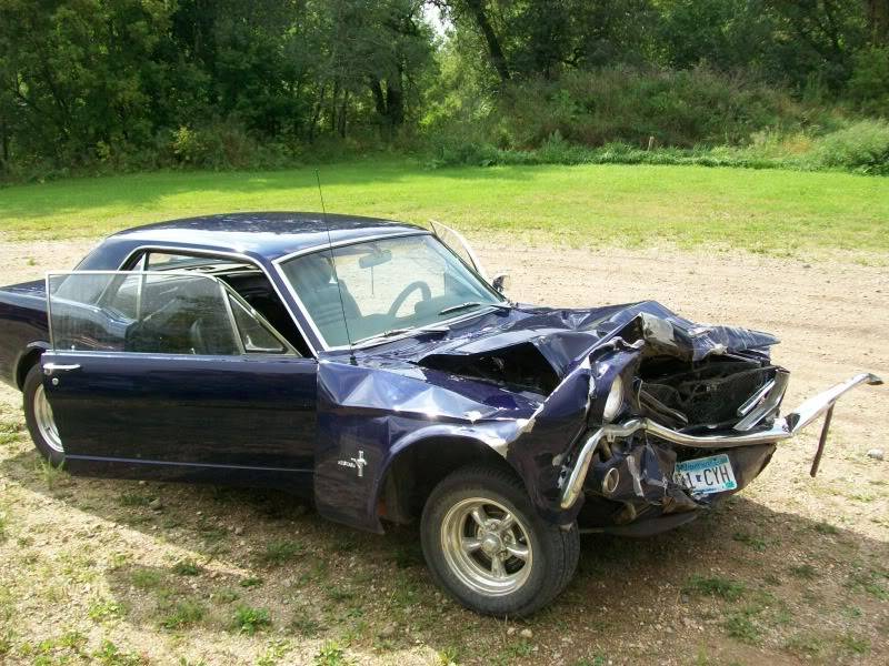

Yeah prop, my daughter was driving. She rear ended a grain truck on the hwy with it. Goofy accident, I'm not going to go into details other than to say harvest season can be dangerous.
Subframe is bent behind the strut towers, firewall pushed back... the salvage "buy back" amount came back too high for me. I gotta let it go. :(

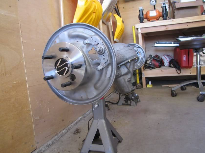

Finally got my rear end back from the speed shop. Fresh Detroit Locker, Auburn 3.91's, Strange Engineering 35 spline S/S axles, Green seals/bearings and a 1350 series 10 spline pinion/yoke.

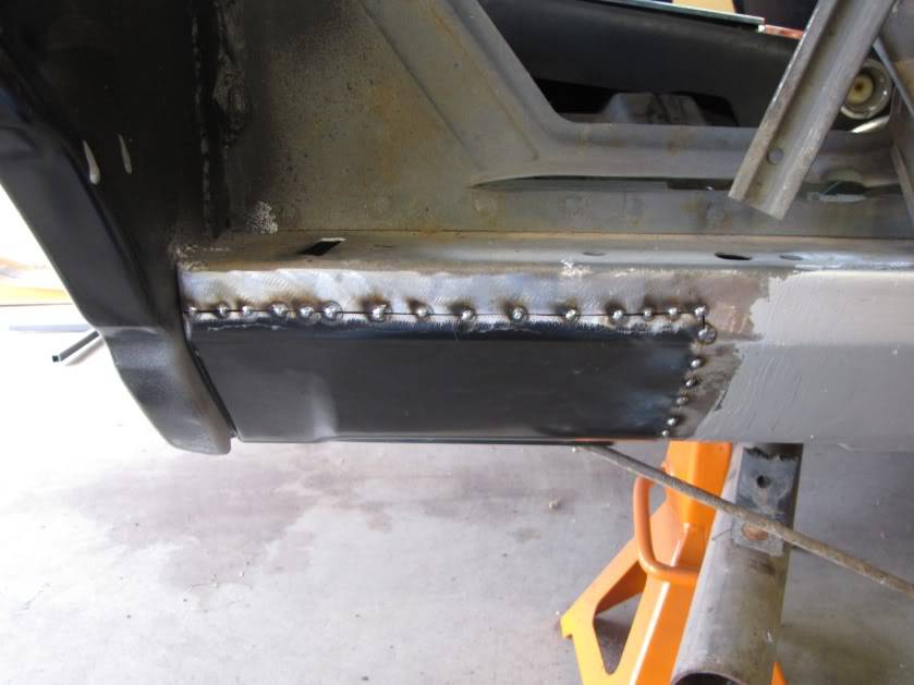

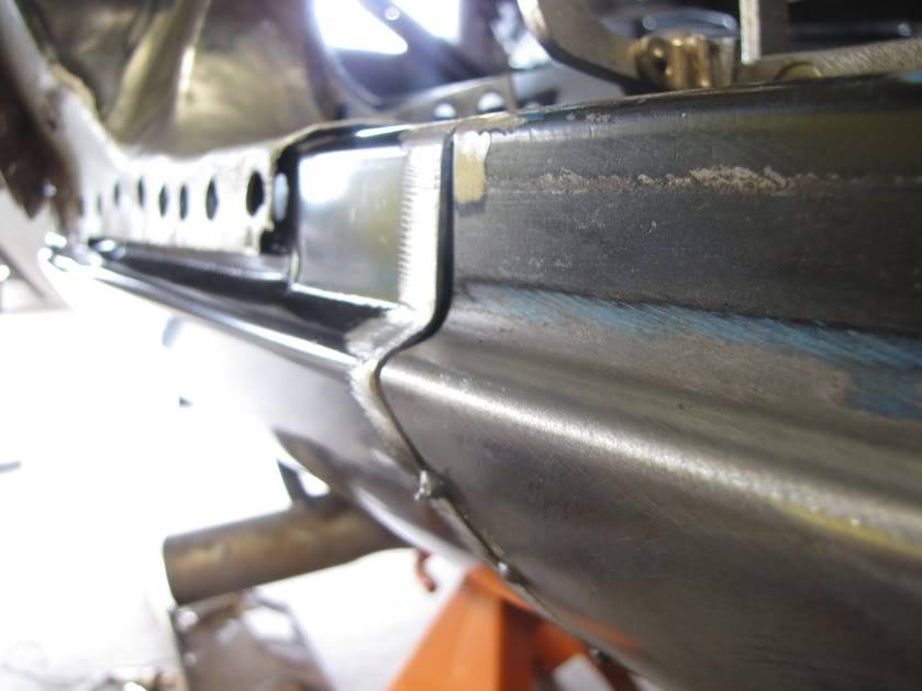

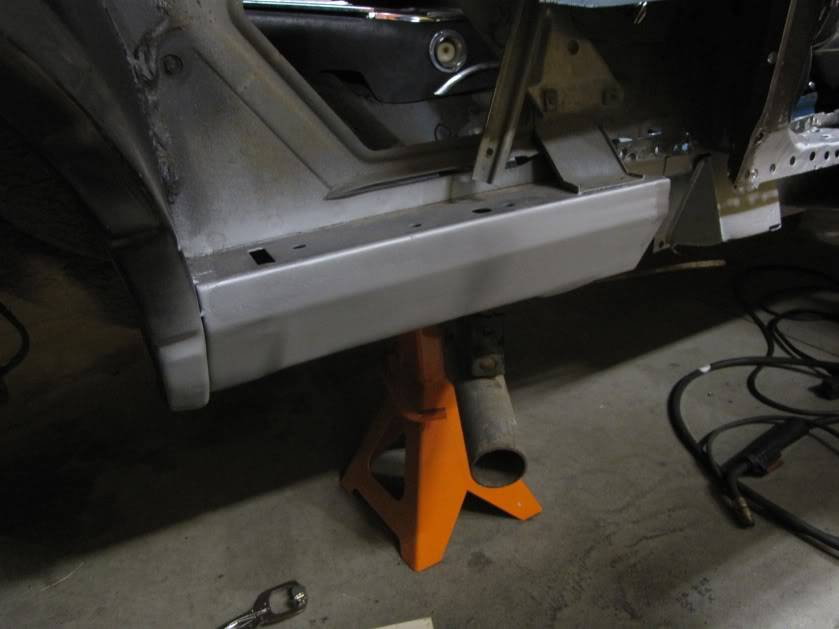

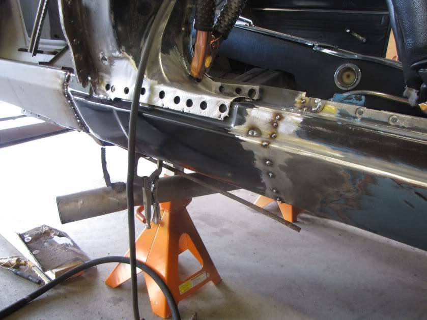

After some tedious work, got the lower jams welded up to the rocker.
Looking good.Someone local do the rear?Got some gears coming and looking for a good place to get them put in the carrier correctly.
Jay,
Wouldn't recommend the place I took mine.. Not gonna waste our time going into it, but let's just i'd go somewhere else. Automotive Supply on Lynnwood St. in appleton use to do a great job for gear changes for a really decent price. You might want to call first though, they downsized a bit back and i'm not quite sure they still offer that service. I'm guessing they still do.
