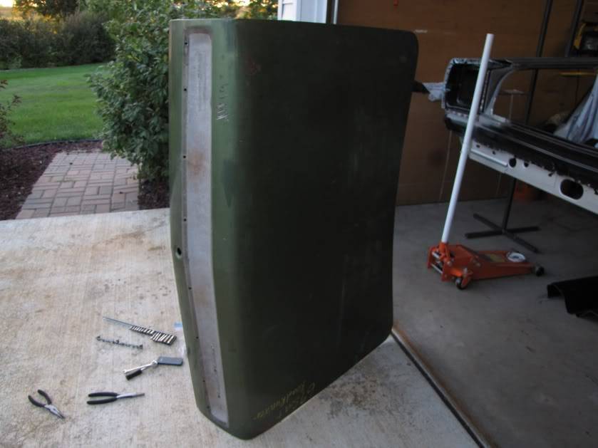

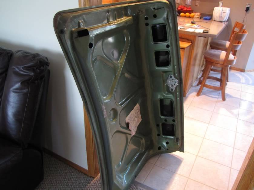

I don't know if I can really call this progress guys, but I got the trim, lock, linkage and latch stripped of my trunk and dropping off tomorrow to have it media blasted along with a couple other odds and ends.. Quoted me $35 bucks when all said and done. I can't even buy media for my blaster for that so......have at it!
Just wanted to post some "Before Pic's"
One question for you guys......The trunk lid is from a 69' satellite which still had the "Plymouth" emblem still on it where there would be a Roadrunner emblem otherwise. Is that plymouth emblem the same one they used for the front hood lip on the Roadrunner? It's about a 1/16" under 9" from the edge of the P to the edge of the H.
Have a good one fella's!
Hey Will to answer your ?? the plymouth logos are the same on the satellite and runner on the hood and trunk for the 69 cant believe the progress u are making Roger and I are in the same boat,I am beginning to think this my satellite will never run.

Thanks for answering my question. That works out great considering I was missing the front emblem.

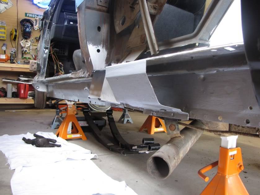

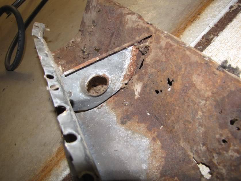

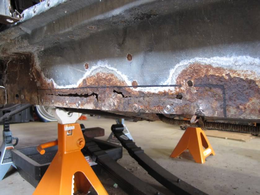

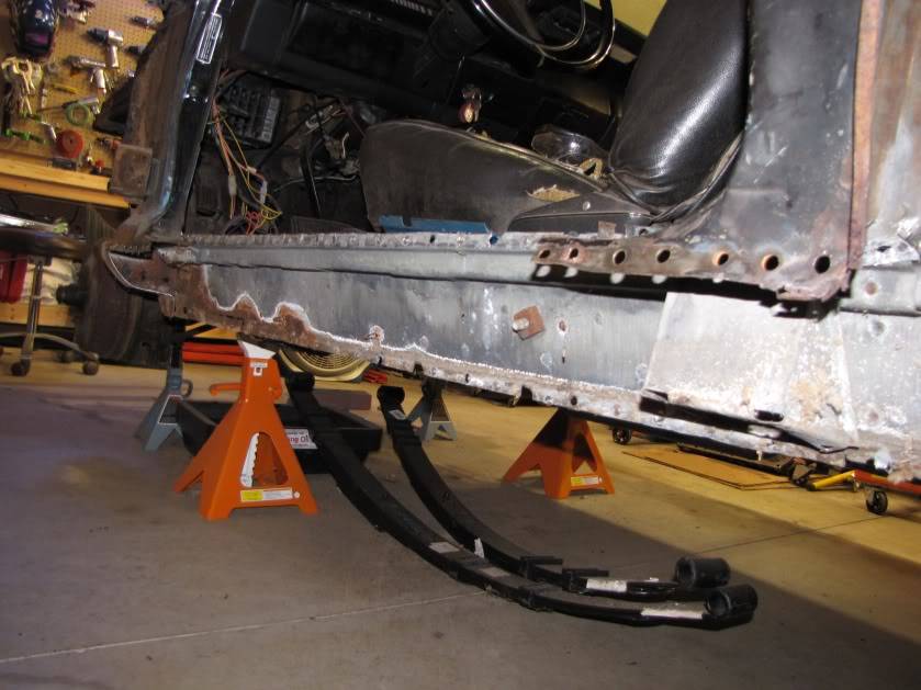

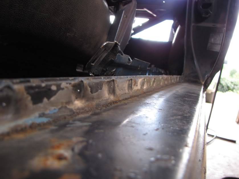

After Spending half the day tearing into my buddies new toy, finally got a chance to completly rip out the drivers side rocker. I'm not going to go into every aspect of the drivers side seeing I already posted on the passenger side.
A few things I'll toss on here.....

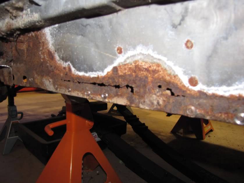

First off for those who haven't tackled rockers, be sure to have your spot weld cutter handy. You're looking at 50-60 to drill out at least, including some that tie in the internal supports and where the quarter bends in to join up with the rocker. Also make sure your cutter bit is attached to a longer arbor. With your drill chuck getting hung up on the edge of the rocker down below, it's not very fun drilling out a spot weld at an angle, unless you enjoy watching your bit walk all over your sheetmetal.
The inner rocker is not too bad for a majority of the space. There is a section I will have to patch towards the front, but will be pretty easy compared to some of the other hurdles i've been running into.
Just a heads up to you guys that choose the AMD rockers. There is an internal structual support towards the front in the factory rocker. The AMD rockers do not come with this support. Either you will have to cut/drill out the old one if in good enough shape or fabricate a new one. I know AMD does not have them.

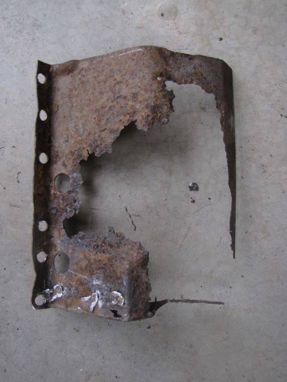

A bit more work done today....

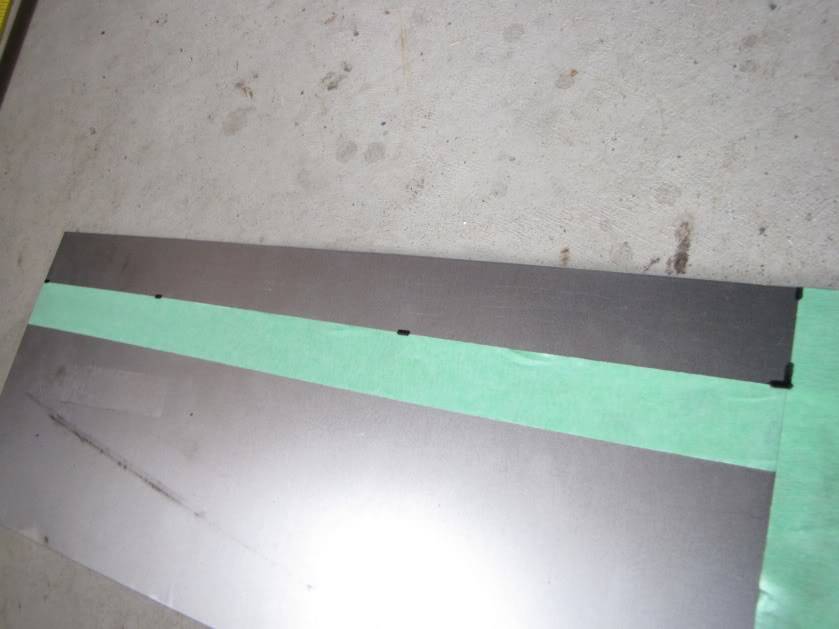

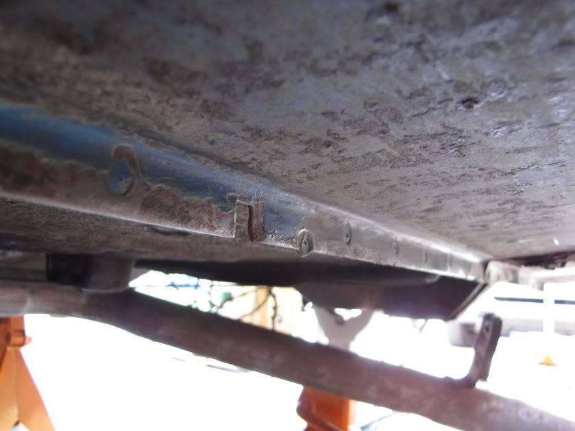

Sectioned out an area that needs replacement on the inner rocker. Replaced with a fresh chunk of 18 GA. sheetmetal.
I didn't spend a whole lot of time making the repair look cosmetically appealing since this is probably the last time I or anyone else will see it again. Just smoothed the weld down enough to keep deposits from settling on any kind of edge.
Cleaned up all the metal via grinding/wirewheel and tossed on a couple heavy coats of rust bullet.
And I thought the passenger side rear rocker was rotted bad..Geezzz. More cancer out the door!
Wow, yep once again I'm very impressed. I knew I could open this forum, come right to this project and I'd be impressed.

Nice work on the inner patch, sure makes a lot of sense to patch like that where you can.
