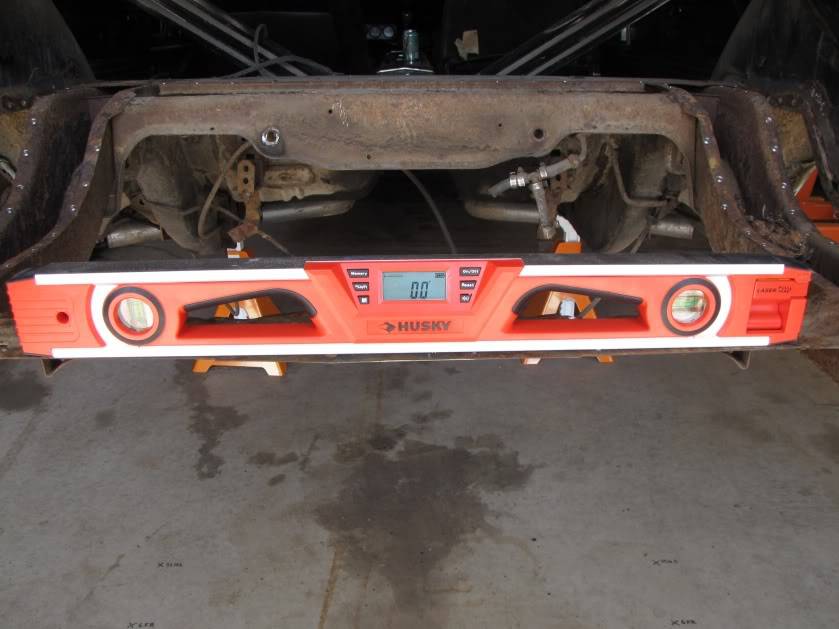

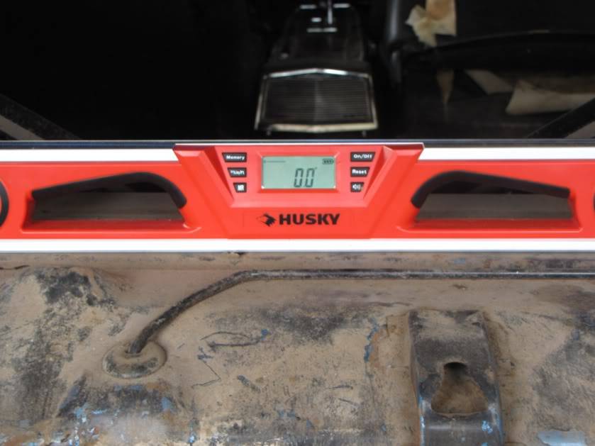

Next it was time blance out the car from front to back and left to right so i can properly make measurements from the bottom of the car to the ground. I used a digital laser level in the jams for the front to back and across the hump for side to side.
I had to use rubber shims between the jack stand and the car in several places to tweak the balance to 0.0 degrees.

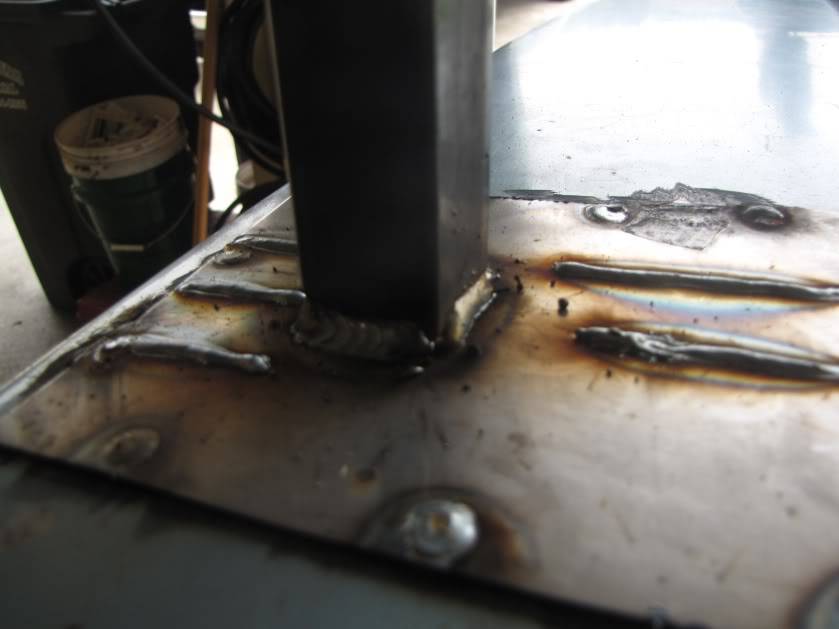

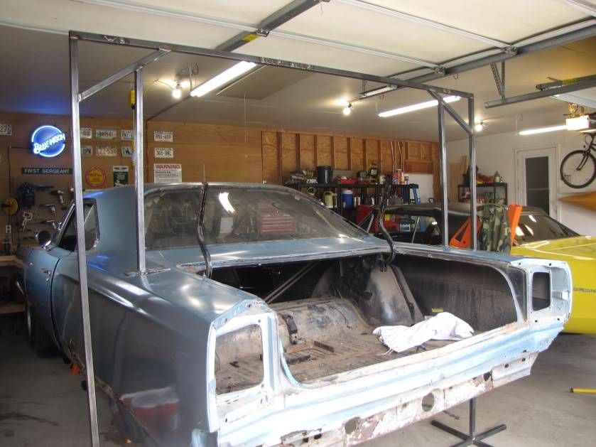

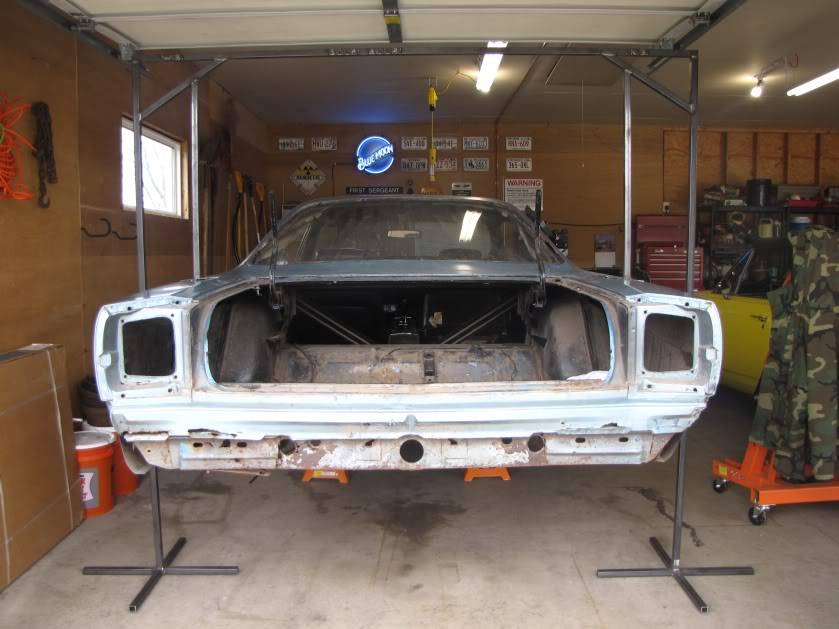

Next it was time to weld up a support jig for the rear end seeing I am replacing most of the metal from the jams back. This is by no means a primary support for the rear of the car, but gives added support for when the integrity of the trunk pan/extension, and frame rails are removed. I used 1"
10 Ga. C/S square tubing. I went with the main supports arms coming down from the gussets so I would have Vertical and Horizontal structual support for the down legs, and would not have to worry about the main horizontal beam taking a bow. I attached the support legs to a piece of 16 ga. steel then used a punch in sporatic areas to spot weld it to the top of the quarters. I also cranked up my AMPS a bit to burn in a few stringer welds. Plus a little added bonus, when i am finshed with the rear of the car and no longer need the jig, it will double as a nice sturdy stand to hang panels/parts for primer work, and it only cost me $31 bucks for the material.

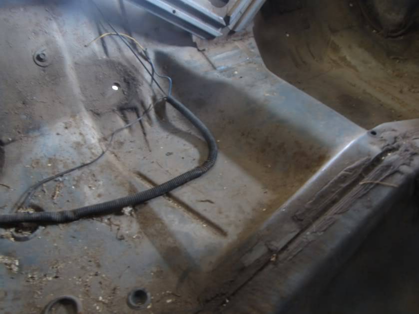

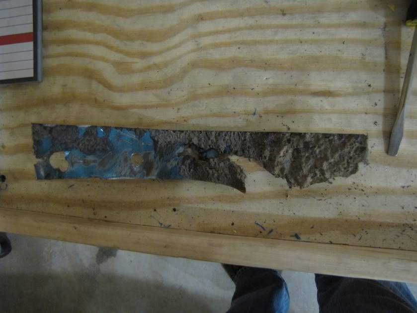

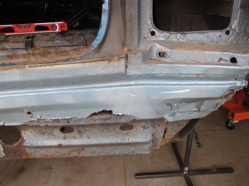

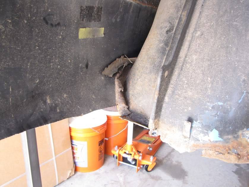

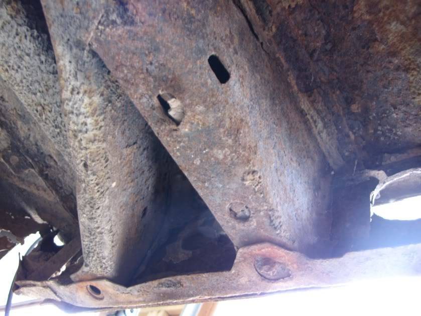

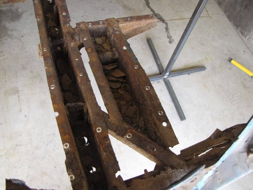

After pulling out the rear seat, I was pretty happy of the floor underneath. another area that is not too bad is the rear rails. The one in the pic is the better of the two, but both need the shackle rails replaced, so it is all coming out and getting replaced

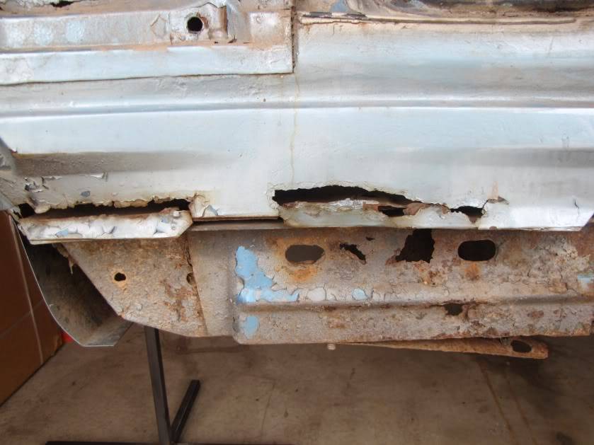

As you can see below, my rear crossmember and filler panel have seen their better days. The left tail light bucket is dead as well. They are about to go into retirement.

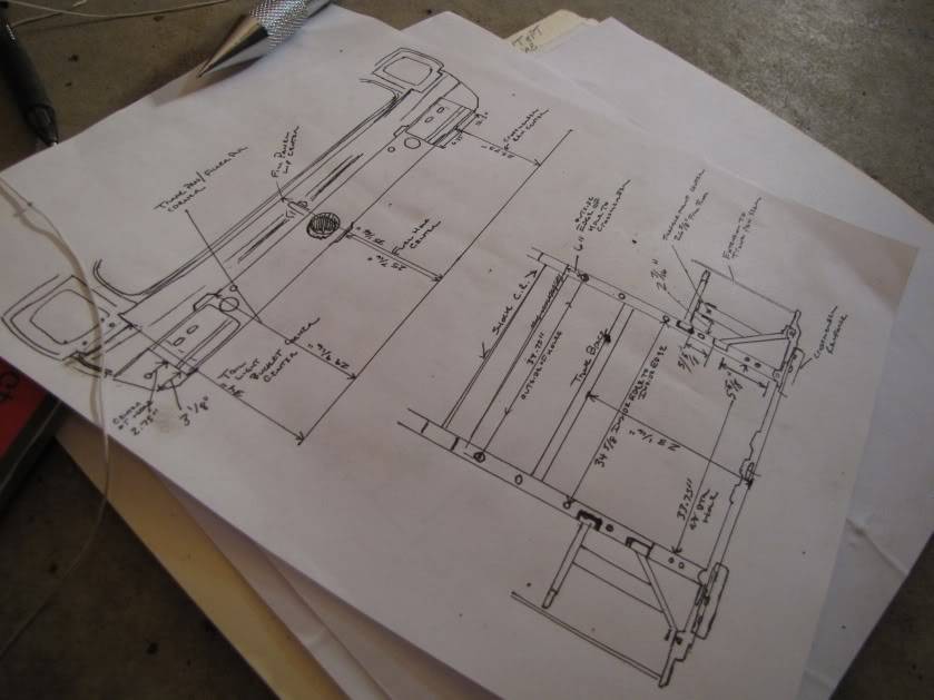

As far a measurement and documentation, obviously that is the key factor in having a job turn out. I took an 6 foot laser level to the garage floor to insure it was level (which it was by +/- .0032), and began using a plumb bob at every reference point possible. I measured at the centers to get my accurate readings and marked them on the floor with a magic marker. I also ended up with a few pages of rough draft drawings for reference as well, which i will put into AutoCAD to help pin point any areas out of wack or areas needing more measurments/review.

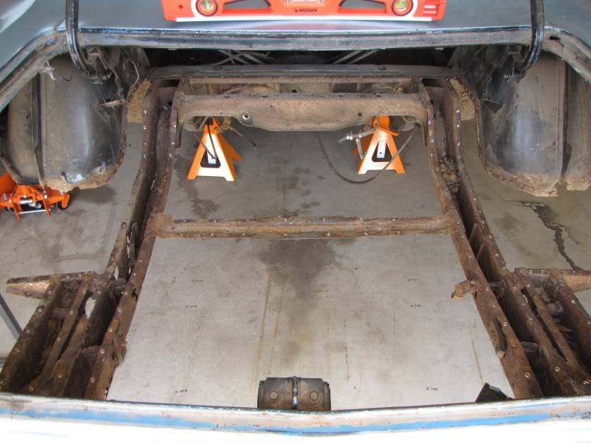

Finally got some more time to work on the bird today. Started off by sicking the ingersoll die grinder with a 1.5'' wire brush on all the spot welds in the trunk.
After a tediuos adventure of drilling out 60-70 spot welds and with the help of a Milwaukee saws-all, the rusty old trunk is history.
I again double verified the car was still sitting level and the original metal was box/square

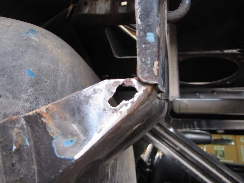

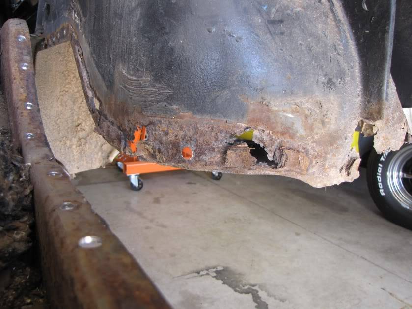

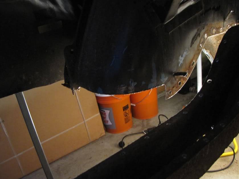

After the trunk was out, I noticed the passenger side inner wheelhouse was not as stable as thought. Instead of a hand fabed patch, I have a inner wheelhouse I'll section out to fix this area properly.
I still plan on hand fabricating a patch for the inner on the driver side. Obviously the custom outer wheelhouses on both sides will be removed/replaced.
The shackle mounts are not too bad but are pretty degraded on both sides at the mount up to the rear crossmember and willl be replaced along with the rear frame rails
So, with a level car, all my measurements, drawings, photo's, and other references in place, the frame rails, shackle mounts, and trunk braces will be on the way out the door as soon as I get a few more parts in early next week.

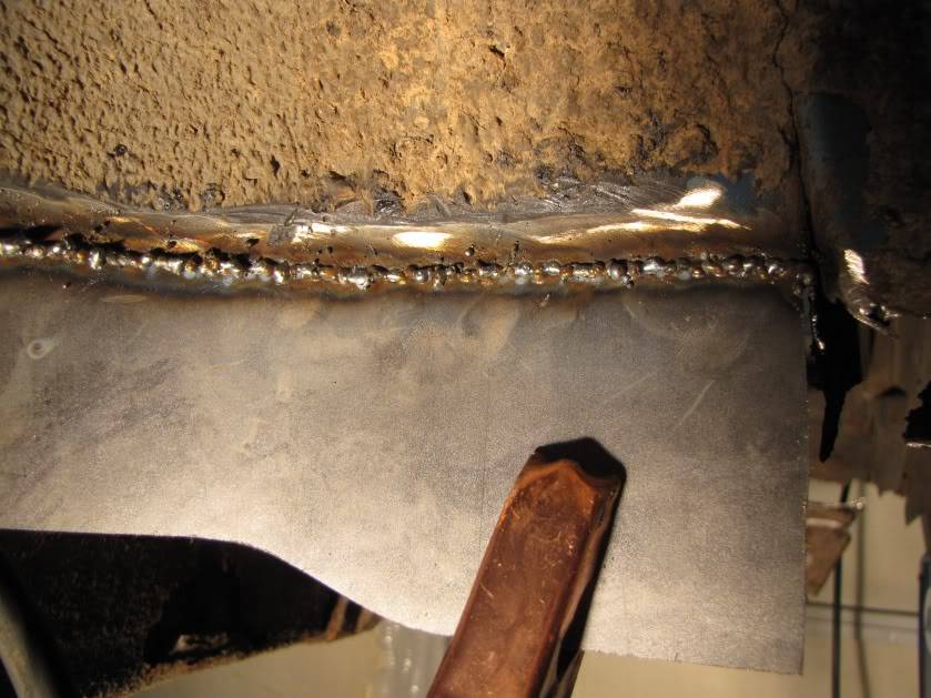

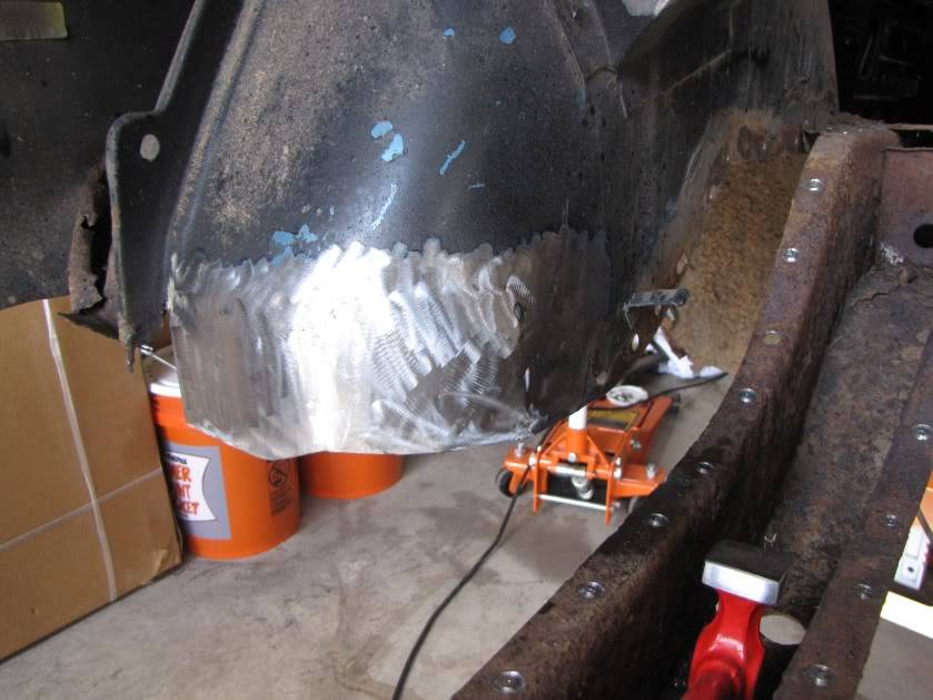

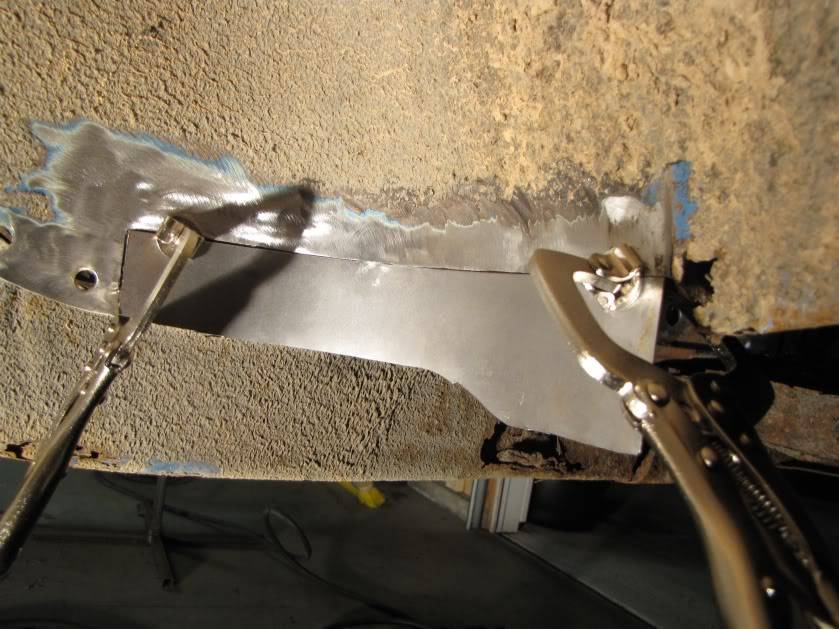

Throwing on a few picks of the patch installed on the drivers side inner wheelhouse. I used what I could as far as a template from the old chunk I cut out. I also had to partially template with what was left of the passenger side for the notch that dips down a couple inches before joining up with the outer wheelhouse.
After a couple hundred very small tack welds, finally the weld across was complete and ready to be ground down.

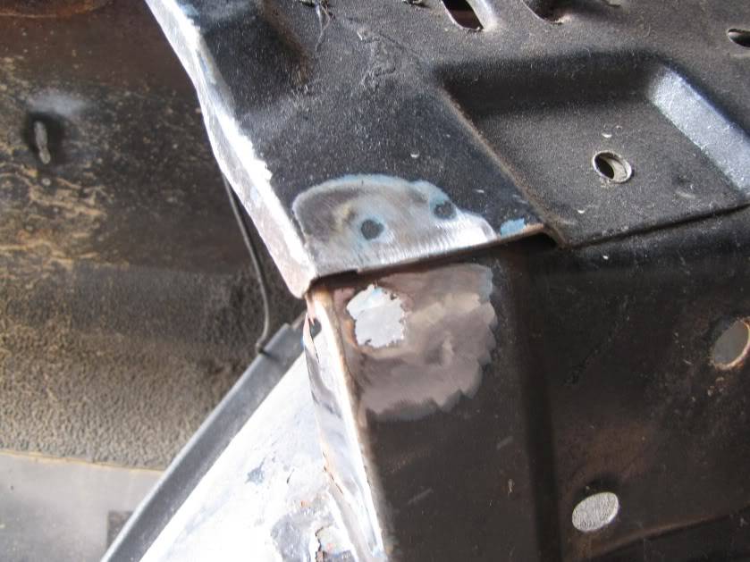

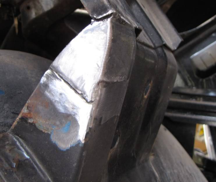

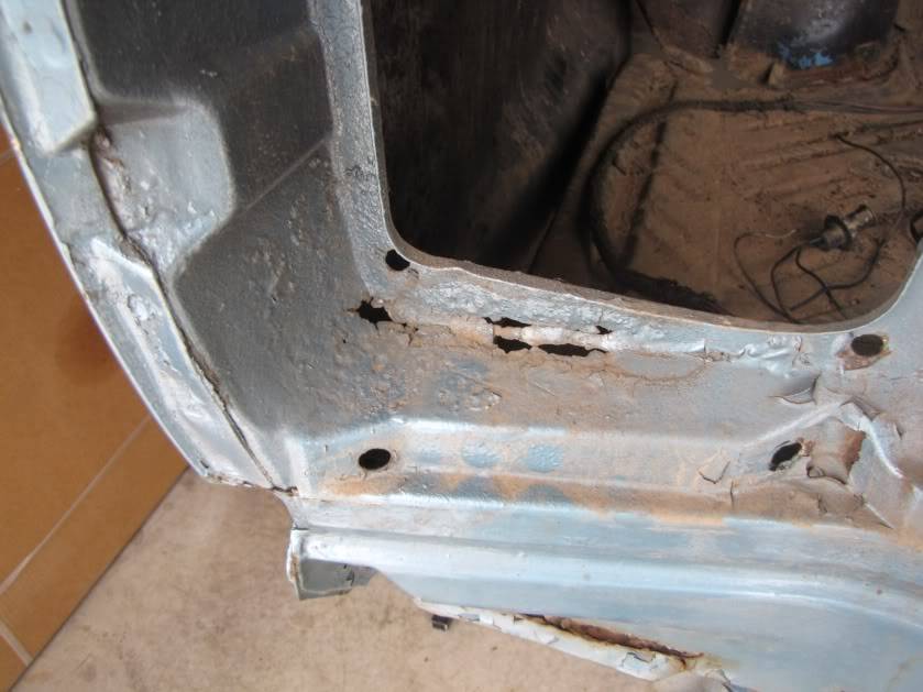

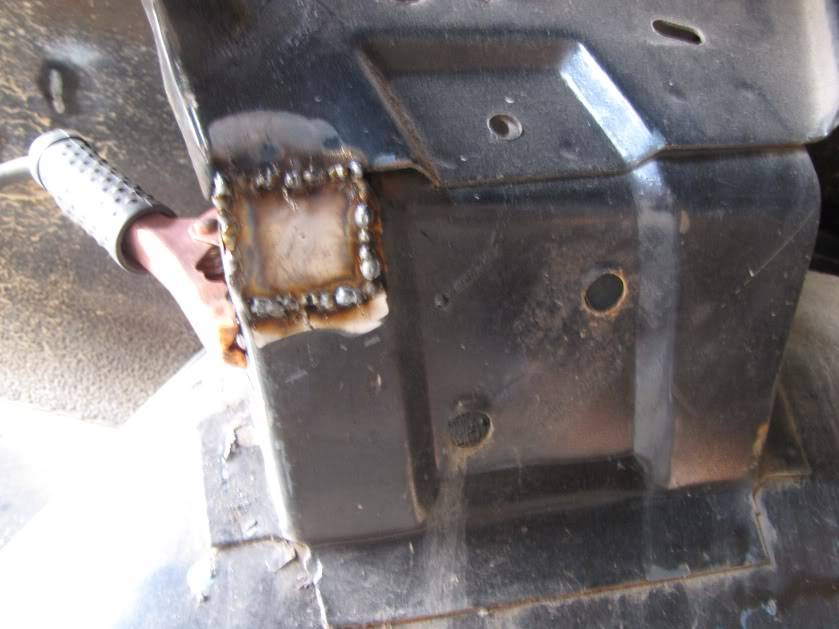

While messing around with the inner wheelhouse I noticed a couple small holes at the corner of the driver side torque box/rear dutchman support. After grinding down on them they obviously got a bunch larger. I ended up fabricating a couple small patches, tacking and welding them in and gringing them together as a single patch.
