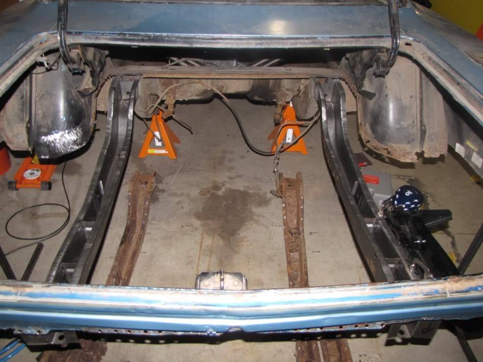

Well, after getting a few hours to work on the roadrunner, I finally got a chance to weld in the new rear frame rails. I used all the previously marked areas on the floor along with the drawings to get everything in place. I also used 3/4" oak dowels with the known old measurments to jig them in place before welding. Everything went into place fairly easy and most measurements after install pretty much came in exact. The worst offset i have is about 1/32" which can be manipulated when I install the crossmember and the trunk pan.

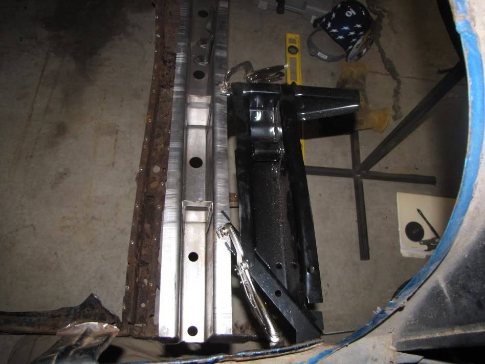

I started to jig up the right shackle mount when I noticed that the housing in the mount that the shackle bolt/bushings go through is set back a 1/2" further than the factory measurement. Anyone have any ideas if this will be an issue if that housing sits 1/2" further back than factory? Will the shackles still bolt in and fit properly? :confused:
The rest of the shackle mount ligns up pretty good everywhere else. If I do move the whole mount 1/2" forward to accomodate that offset, the rear of the mount will not mate up flush with the rear crossmember, so..............
kinda at a stand still I guess

Hey prop, looking good brother!. I'm suprised to hear your having an issue with your parts. I don't know if the 1/2" will create any problems or not, but I would get on the horn on Monday with AMD and talk to them about it. If there is that big of a discrepincy, they need to know about it and tell you how to deal with it. I will assume that your rails aren't a 1/2" long, where did they come from?. I am making that assumption based on the fact that I know you would not have welded them in if they were sticking out a 1/2" past your measurements. In fact, I wouldn't be suprised if you had some how rigged one of those invisible fence systems to work with all your original measurements and when you are installing your new parts your just getting a shock until it's positioned properly!:rolling::rolling:.

I got the 50 1/2" rear frame rail replacements from AutoBody Specialties. Don't know the MFG., but I know they were made here in the states. They are pretty close to the factory set, but by no means the same. There had to be a little "tweaking" to make them line up up/down, and left/right. The holes on the bottom side of the rails on the new vs. the old do not line up, so that through a bunch of my measurements out the window. :edgy: I was still able to have pretty good line up for total legnth and the rear height. The top of the rail outer lips are not the same, and I will have to weld in tabs for the shock crossmember to mount to. The beginning one inch of the new rails are crimped/flanged in, so there is some leeway fore and aft.
Invisible fences...LOL. I could almost see myself doing that. "Why the hell are you wearing a dog collar?" With Plumb bob's and Oak dowels, i'm starting to feel a bit Amish! Just call me "Jebadiah" from here on out:tiphat:
I wil definitly be giving AMD a call on this tomorrow. Wonder if this is a stamping flaw? I can't really imagine someone over at AMD made an executive decision Engineering wise to move the mount housing area back 1/2" because the Chrysler Egineering Department had it all wrong 40 some years ago. I'm sure this question has risen up before to AMD seeing this area is definitly a more popular cancer area.
