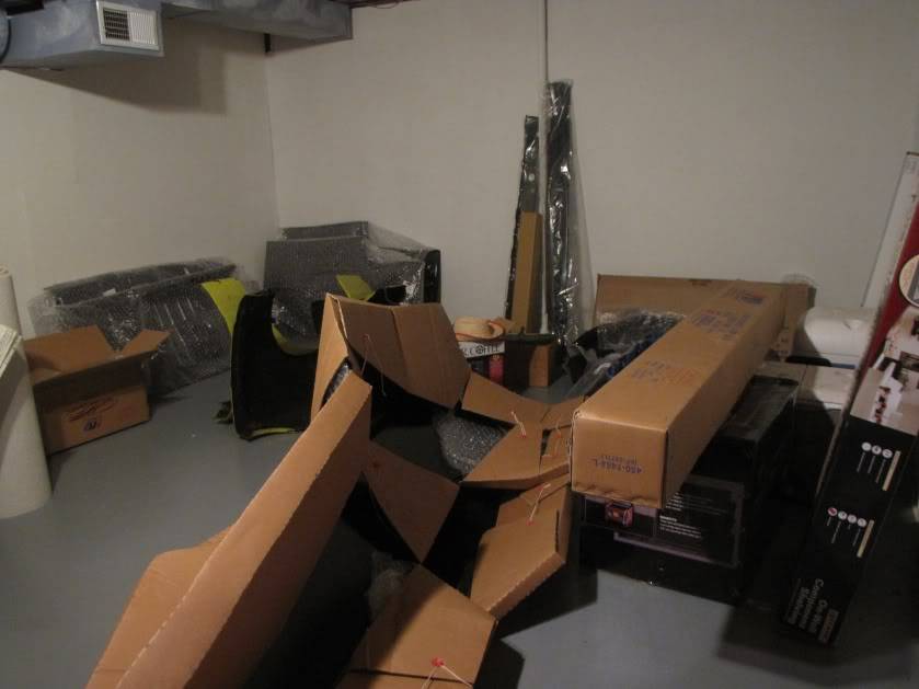

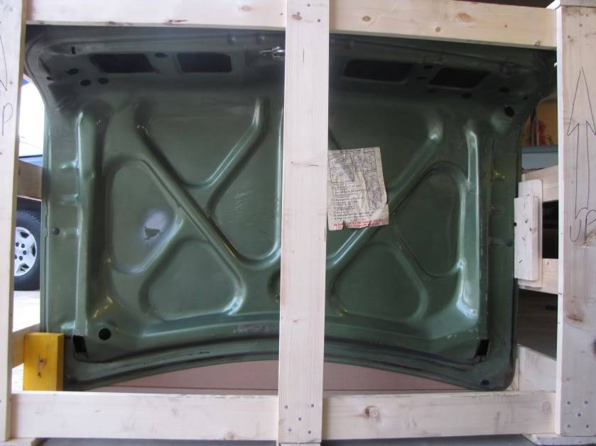

We got parts!!! Had my trunk show up today from Sonic motors over in Holly, MI. Awesome shape and they did one heck of a packing job. The basement is starting to pile up as well......

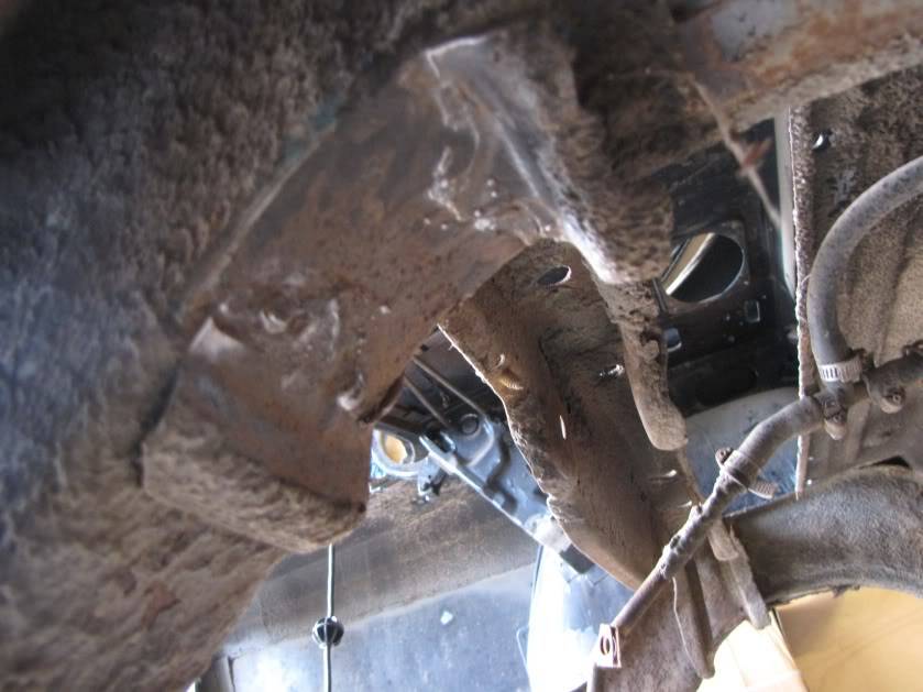

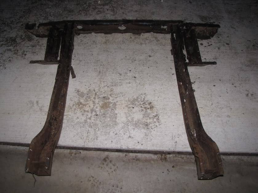

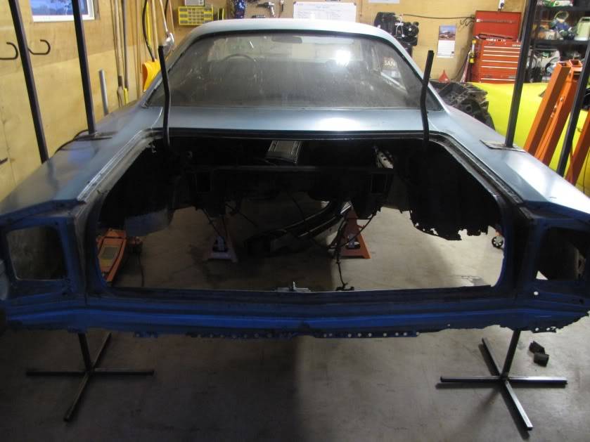

Got some work done on "skeletor" today. Ripped out the trunk brace, shock mount brace and the rear frame rails w/shackle mounts. I was really suprised how goobered the welds were on the bottom of the shock mount brace. looked like a weld made of smeared peanut butter. I had to cut next to the welded areas to remove and will have to re-fab the ends when I install.
I think that is the norm for the welds on the shock mount crossmember, every one that I have seen has been installed the same way.
How did you find that trunk lid, it looks really nice. It is always shocking to see such clean body parts from the mid west. Must be one of those outfits that make a few runs down south or west several times a year buying up cars and parts.
Great shot of the basement, the only thing missing is the xmas tree!!.
I all of the sudden feel the need to put a hat on and get a cup of coffee.

Found the trunk online by using a craigslist search engine which searches all areas in a mileage radius that you put in. "Search tempest"
