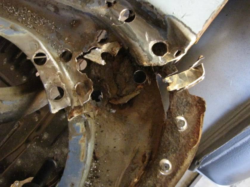

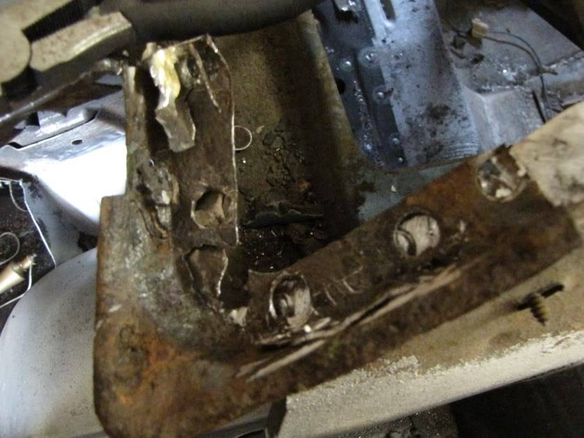

Finally got a chance to get a bit of work done tonight. I was able to remove the remaining parts of the chopped up passenger side quarter. Hopefully i'll move on to changing out part of the trunk gutter and clean/prep the area for quarter install here in the next couple days.

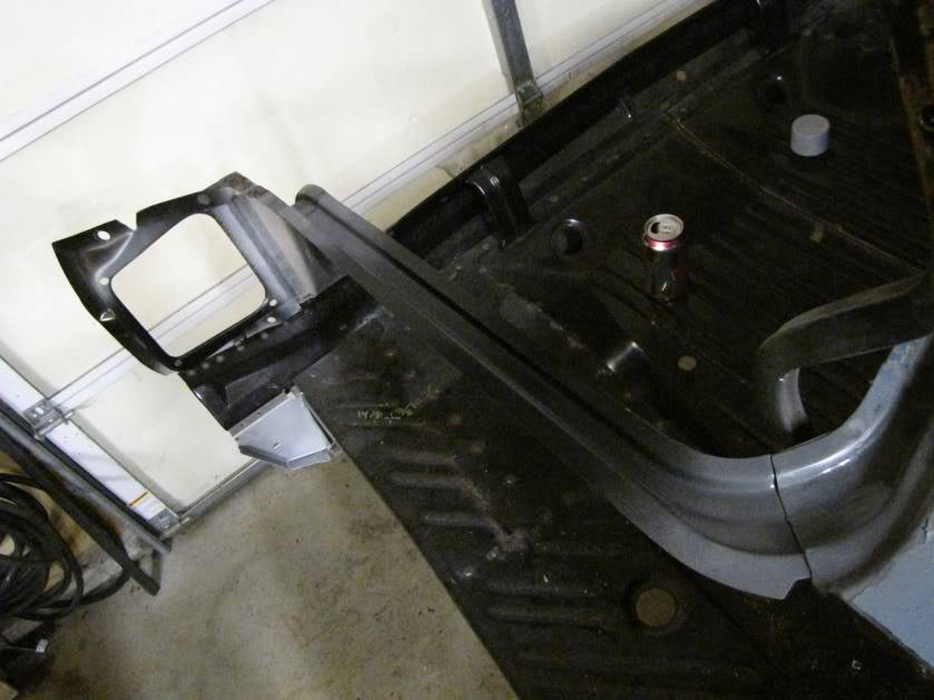

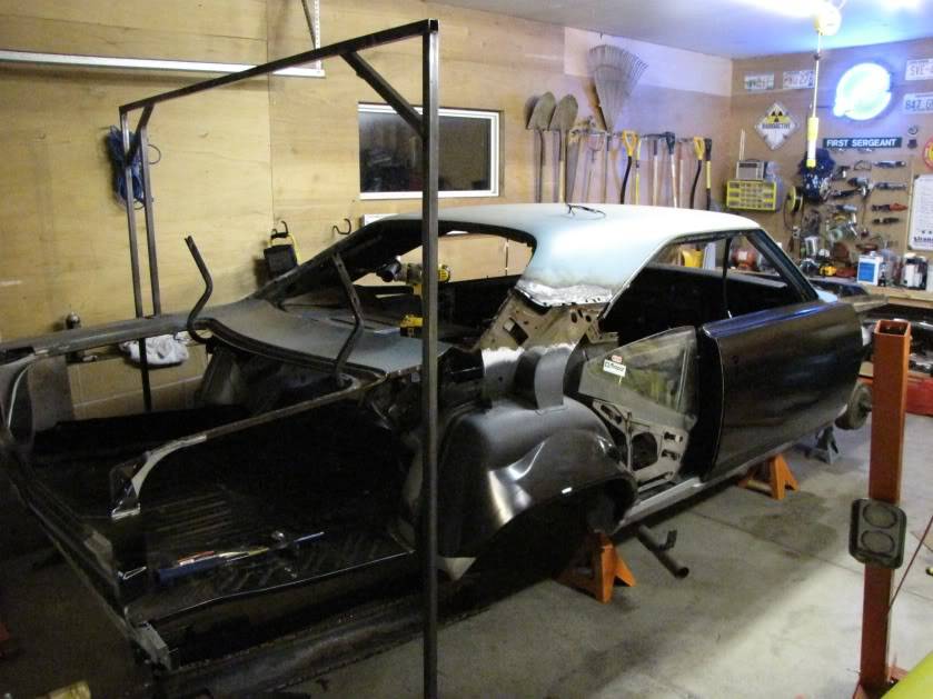

Moved forward on the Roadrunner tonight..

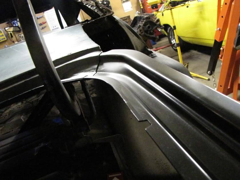

Decided to remove/replace part of the trunk gutter and patch up a bit of the rear deck filler panel..
Rotten--------Imagine that

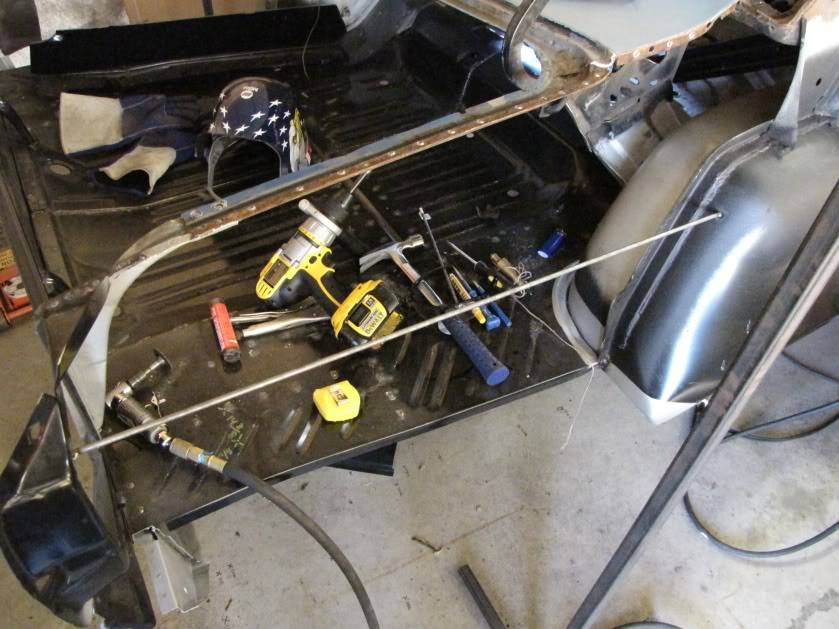

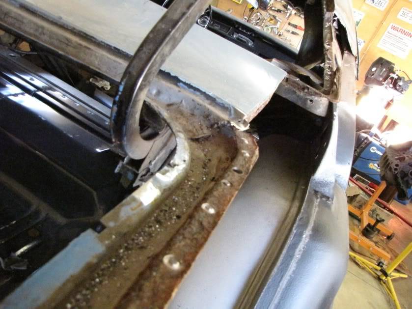

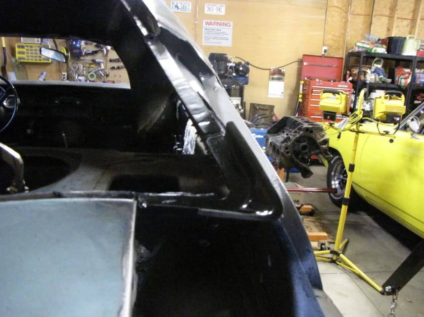

Tac'd in a 5/16" rod from the outer wheelhouse to the backside of the tail light bucket, seeing when I pull out the section of gutter she'll spring out of place. Also used the plumb bob to mark some spots down on the trunk pan.

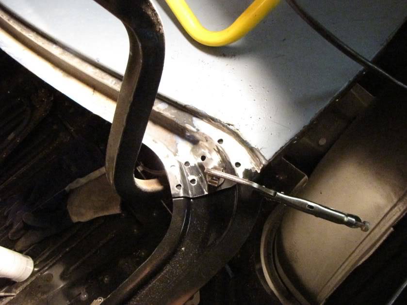

Ah yessss......More lovely cancer!
Had to do some crazy jigging/stretching on the bottom side to get the AMD replacement to fit in well.

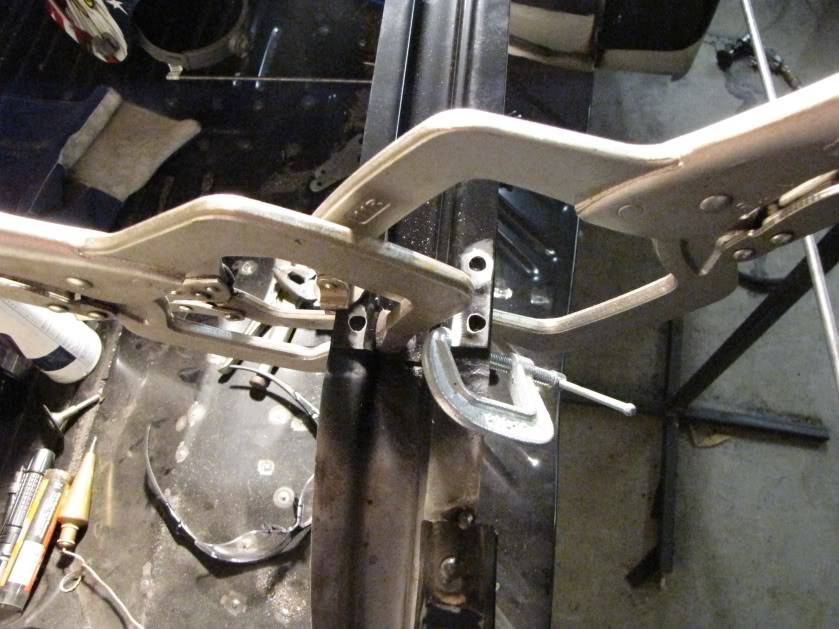

Sectioned 4'' off a different deck filler in the gutter area. Fit in, drilled and ready to be welded. Also had to do some pretty significant relief cuts and a pie cut to get the new section to fit in properly
Enjoyed swapping this part out. Didn't take much effort and had quick results.

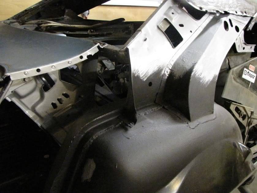

Pretty rough eh?
Before I ripped out the old channel I marked the location of the old one via a plumb bob. Measured from the center of the curve of the channel and marked the spot on the top of the inner wheelhouse. After a little repair/weld work I wire wheeled the area and coated.
Welded in! Now, this side is ready for a new quarter.....
