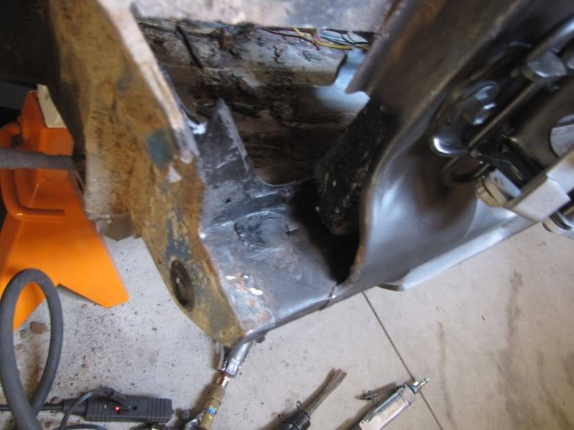

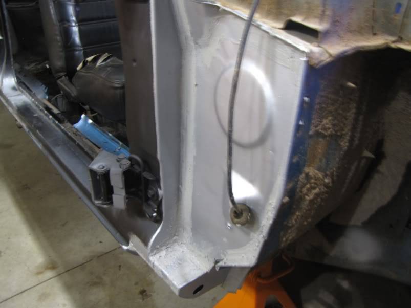

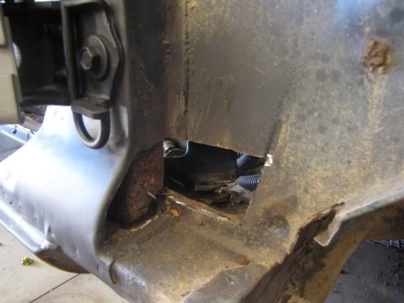

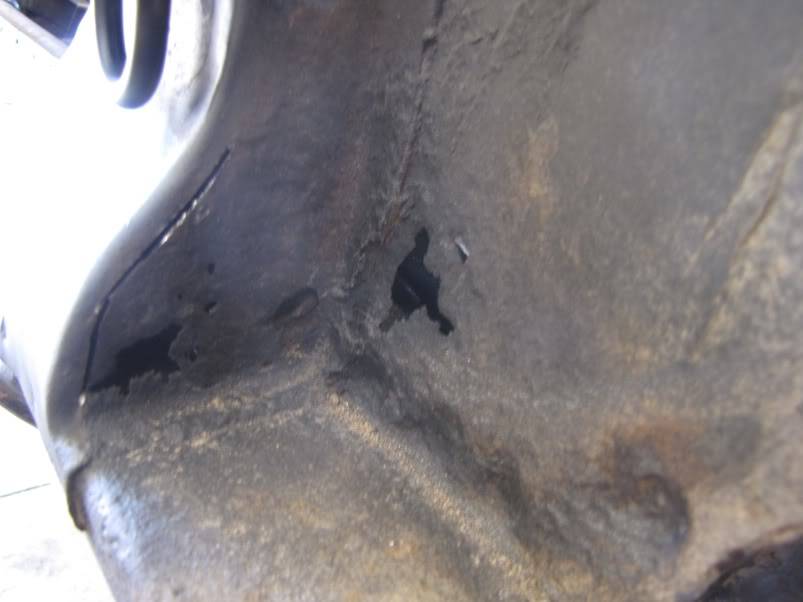

More cancer to remove......Typical rot area on these cars, especially since it seems someone removed the inner splash shields and went clay dirt track racing 20 years ago..lol
Drivers side was was worse.....Another typical problem on these northern cars. Back in the day, the left side of the car sloshed up all that salt/snow/ice/sand the tends to gather up towards the center line. Also explains the rocker and wheelhouse being in much worse condition than passenger.

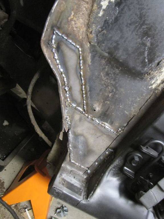

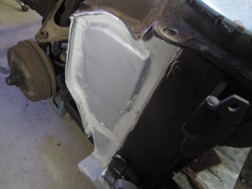

After installing lower patches, I decided that I wasn't quite happy with the metal condition up from them, so I ended up fabing in a patch a bit higher up as well.
Passenger side roughly done........I will rust bullet, seam seal and possibly undercoat these areas so this car doesn't have to worry about these issues again in the next 41 years.....

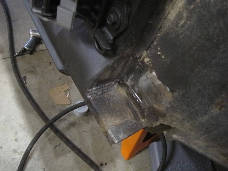

Got the areas forward of the jams wrapped up tonight...

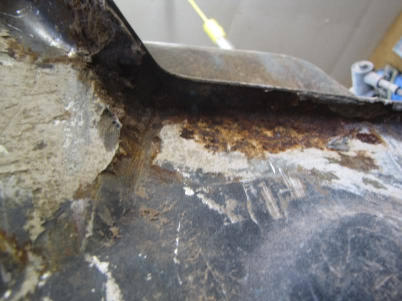

Ever wonder what the metal looks like under all the factory seam sealer...........
Got the patches done, after that, wire wheeled the surfaces down to bare metal, preped and metal washed, then covered all with rust bullet. Then I applied 3M seam sealer pretty much where the factory did. Seeing this area is right below where water from inside the cowl is channeled out, obviously the factory had the right idea in mind...Now there's a rust protectant as well as sealer.

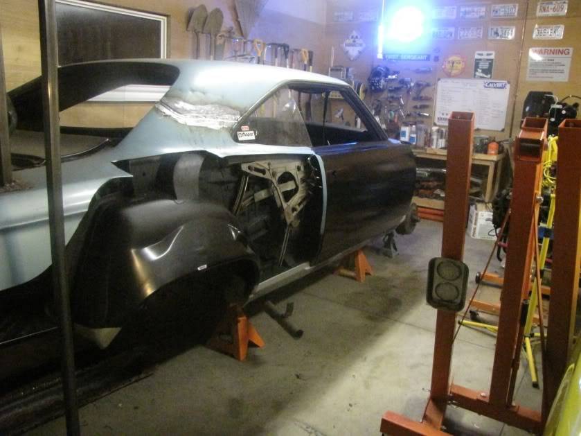

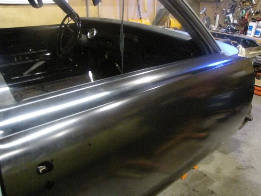

Plugging away on the doors now....Got to get the new ones fit up so I have proper gap/ shape to set the new quarters to.
Take care
After a few joy filled hours, finally got the doors mounted. Gotta say with the hinge rebuild and spending ample time lining the doors and the striker up, these doors open/close and swing as good as if not better than a new cars...Definitly worth the time and effort!!!! Got some of the guts in the door, besides some of the window trim that is off to the chrome shop.

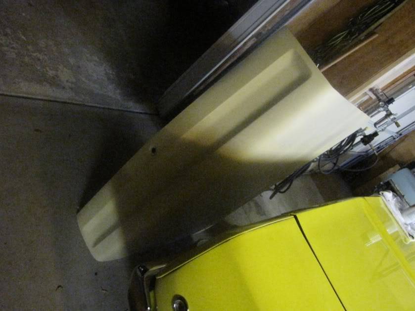

Also got the trunk lid back home....Had it media blasted for a knock out price. Brought it over to my buddies place, I leaded in the trim holes, fixed a couple small dings, skim coated, used his spray booth and epoxy primed. It's pretty much ready for guide coat/blocking.

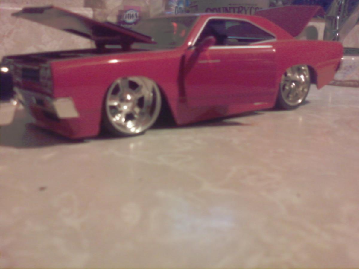

You got that right cant really do much to the bird as were waiting on our new baby boy hopefully should be born in about a month or so kinda holding up on the toys once hes born hopefully I'll go back to work and get back on it, hopefully by the first months of next year I'll either order by custom billet wheels or a stroker kit for my engine either or already told the wife and she agreed so hopefully once I get some progress on it I let you know so you can let me know what you think. I might be buffing it here pretty soon as I'm just here at the house all day.Cant wait to finish mine up also to go out and tear up the streets hopefully all the hard work pays off Heres wat it could look like (more less) got a whole bunch of metal die cast cars tough choice red,black,silver either would look nice keep up the good work
