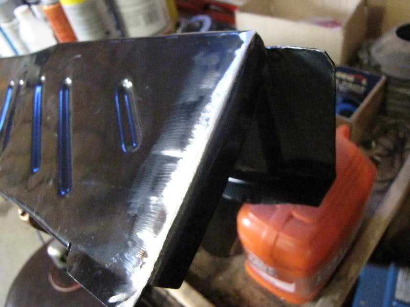

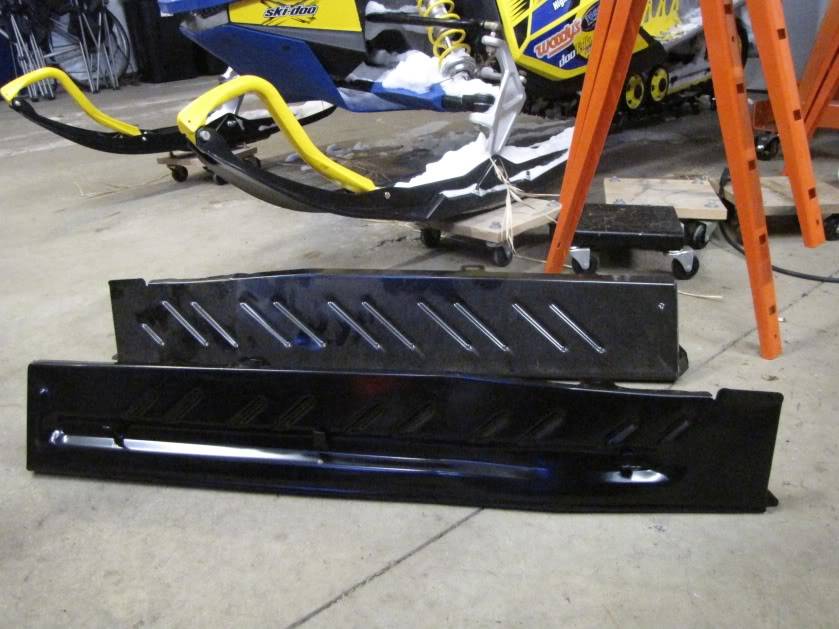

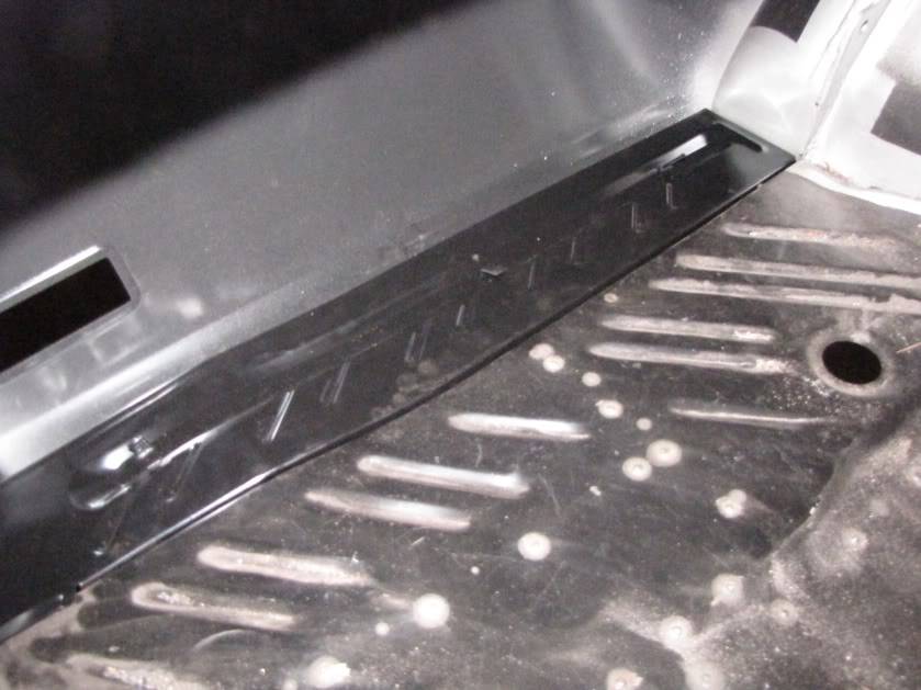

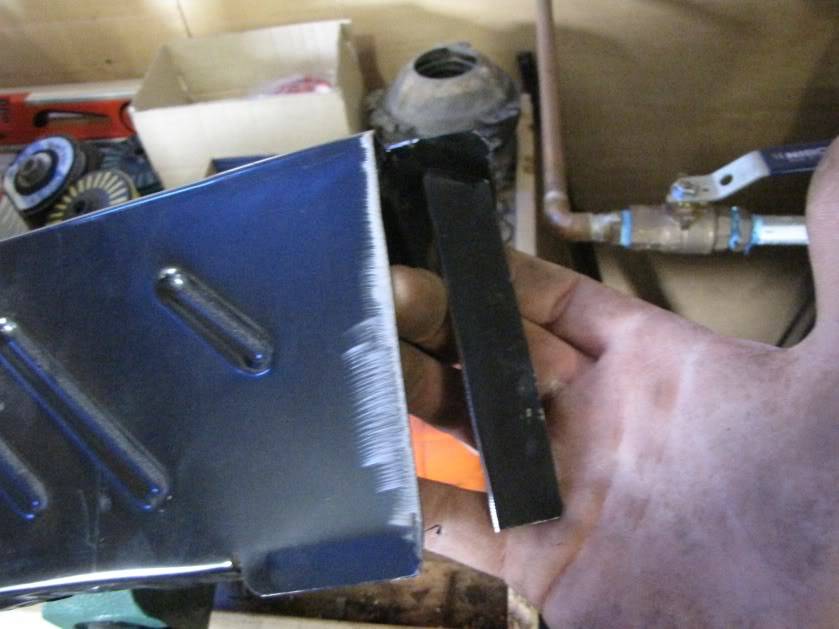

Not too exciting news but got the extentions fitted in.. Went in pretty good.
One thing I did notice on the drivers side extention was the lip at the trailing end that tucks down and secures to the fill panel was mangled up and pretty much nonexistent. Ended up cutting off that garbage, cutting some donor metal off a chunk of the left over rocker and welded it on...Pretty easy stuff.
Other than that, everything went pretty smooth..... I'm ready to rock and roll with welding in the back..

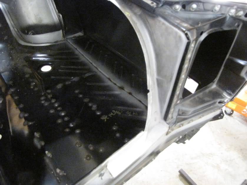

Not much, but little bit of an update.............

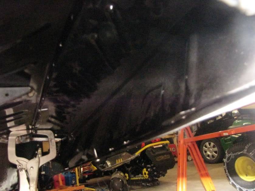

Passenger quarter is pretty much welded on 100%. Extention is fully welded in.

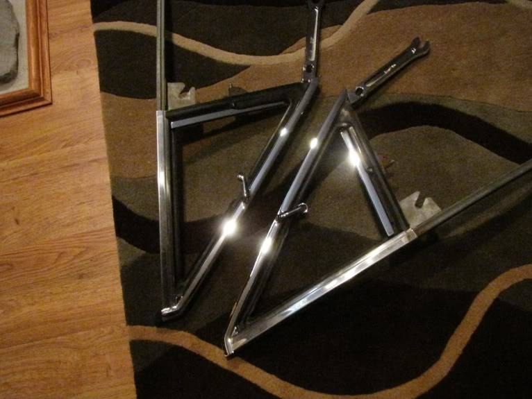

Putz'd around a bit inside tonight. Got the newly rechromed parts of the window vent area/frame put together an installed newer seals. Bit of a pain of the *** getting the framing a part/put back together, as well as reinstalling the seals, but well worth it.
those window vent frames turned out really nice. how much more parts do you have that need rechromed?
I thought the same fella's. I was more than happy when I got them back. That should pretty much do it for the chrome work. Got a real good place not too far down the road that does the work. They do a lot of 50-early 60's era stuff. Even do the old school nickel plating. Real nice folks.

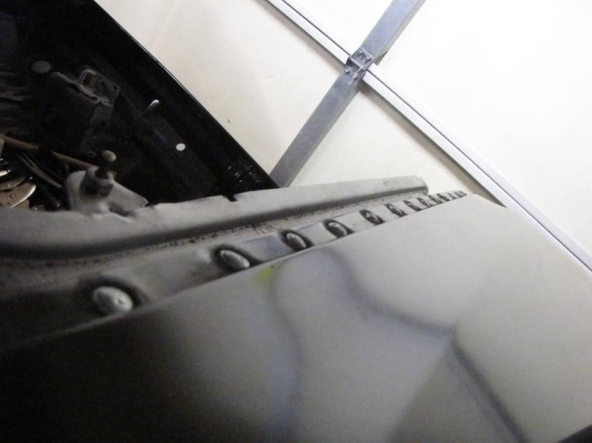

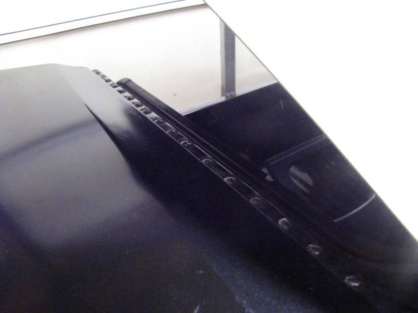

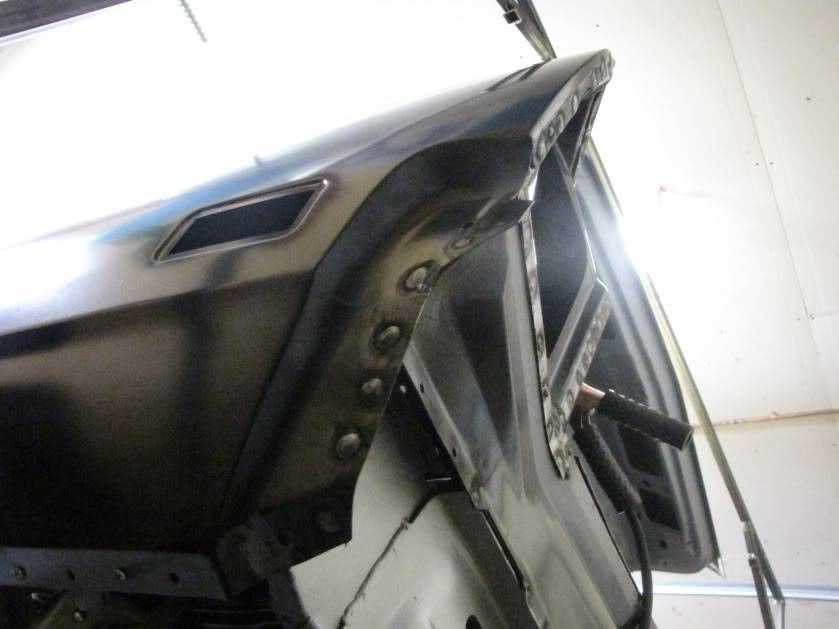

Few shots of the welding going on with the drivers side quarter.... Quarter #2 is pretty much welded on 100%.. I do have some problem areas that require a little special attention.
-Lip on quarter where it drops into gutter/needs relief cut to drop
-C-Pillar on quarter that drops down into window frame, had to cut (too tall) need to weld back.
I'll be posting up some pic's of the repairs soon
