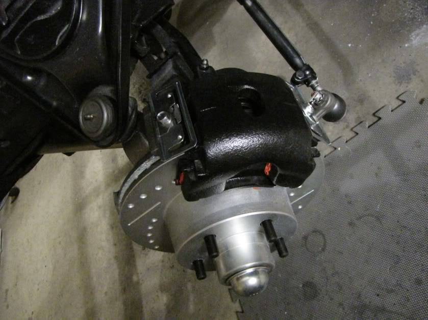

Got that the replacement spindle already to replace the first one that had not been machined down enough. Pretty suprised RSD got me a replacement this quick. New one had the bearing/rotor slide right on.
Getting ready to toss on the GMAX sway bar next

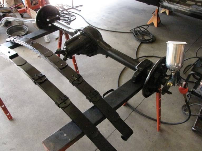

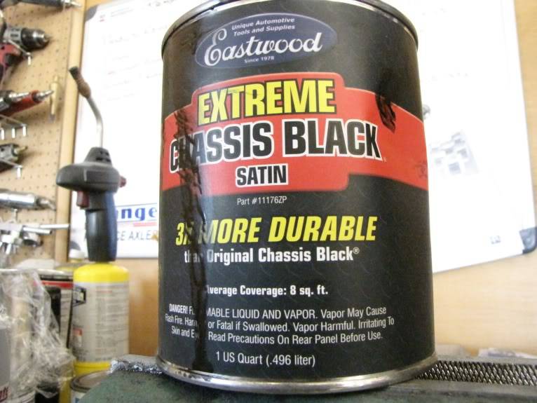

Still found some time to work on the old girl. Decided to spray the new Mopar SS springs, rear and k-Frame with Eastwoods Extreme Chassis Satin Black.
Also sprayed the steering link and rods with some cast blast, installed the wiper pivots-seals-linkage, and installed the left side vent box.
Not really any directions about the recommended gun settings, so I went with a 1.8 tip and about 20 PSI at inlet on the devilbiss. Spayed out real nice. No catalyst's/hardener's used/needed with this stuff.

With that tip and psi, it was real easy to dial in a decent spray pattern and flow rate.

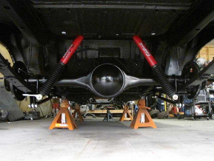

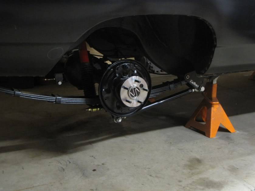

Mounted the Rear, Mopar Performance XHD Leaf Springs, Edelbrock IAS shocks, Calvert Racing Cal-Trac System, Hotchkis Shackles and Energy Suspension Poly Bushings
Most excellent amigo.
You are so close to putting the bird's feet back on the ground!!
Thanks fella's!! She's been airborne wayyyy to long now. Looking forward to seeing the bird on it's own rubber again.
As far as the rims Matt....15 x 8 in the back 15 x 7 in the front. Undecided yet on tires. Either good old american made Cooper's or BF Goodrich. Rim's still undecided on that front yet. Either Weld Prostar's or Magnum 500's. I have a set of Crager 800 series that I traded Wannadrag for a set of crager aluminum slot's. Probably use those as roller's
