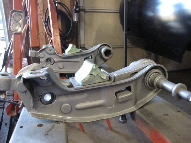

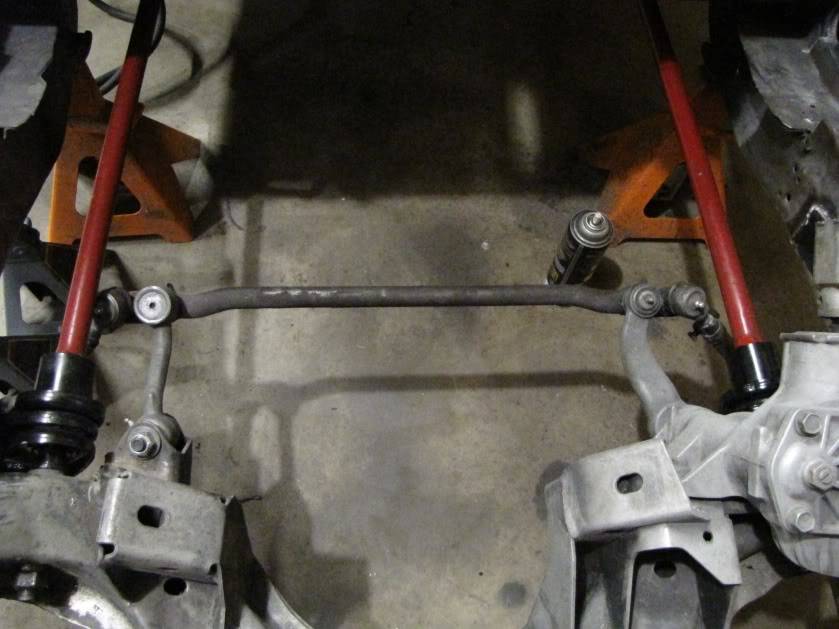

Didn't get her put all back to together like planned, but you guys know how that goes. The old man and I at least got the New Pitman arm, Idler arm, tie rod ends and sleeves installed. Still waiting on the LCA back from the machine shop with new bushings and also my torsion bars from Just Suspension.
Strut bars were a treat to get out.. Ended up toasting the drivers side. Half of the nut was left on the threads of the bar.
No Biggie...Gave me an excuse to buy the Hotchkis Adjustable Strut Bars i've been eyeballing. They'll allow me to adjust in more postive camber for better stability at high speeds, more strength/support as well as better vertical transition/movement in the LCA's. Waiting on these also

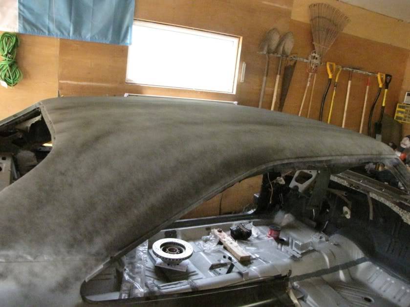

Got the A-Pillar to cowl transition blended in. Attacked it with metal to metal, then Rage Extreme and last, Evercoat glaze. Pretty fun trying to get the sloap and then the lip for the windshield just right. All hand/block sanded out...
