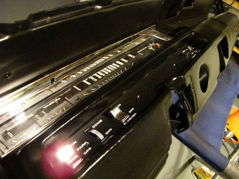

Love the look of the LEDs, I've put them in a few dashes myself before you could just buy direct inserts. I soldered these in to this dash that you could barely see before. I know, I know, it's not Chrysler but it is a Daimler product. Hey Propwash, no excuse needed. Some times S*** happens and ya gotta get back on the horse(BIRD), at sometime. Eagerly awaiting progress....

Looks freakin amazing. Sorry Prop for hijacking your thread. Please let us in on the details!!
