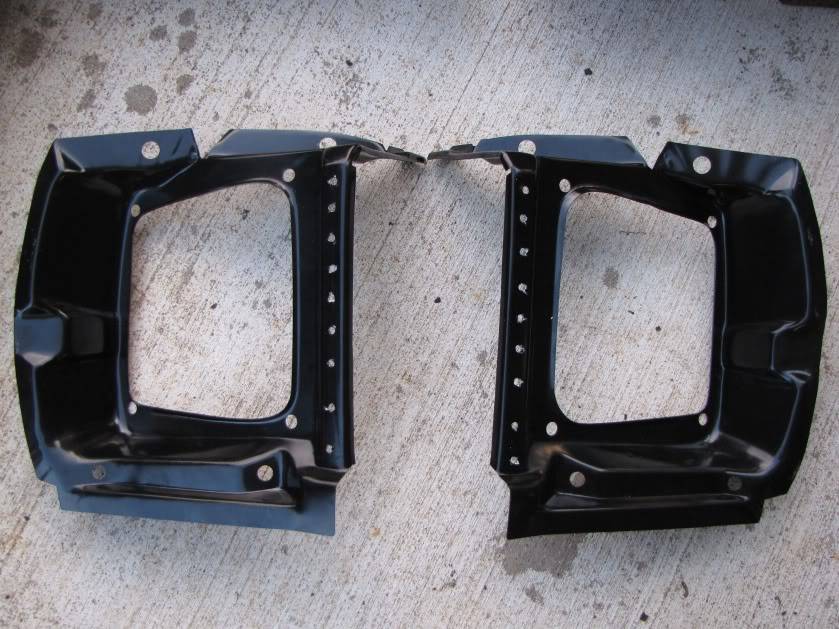

The new AMD tail light buckets just about ready to go in besides taking the flange/punch gun to the bottom lip and the die grinder to clean off the e-coat around the weld areas.

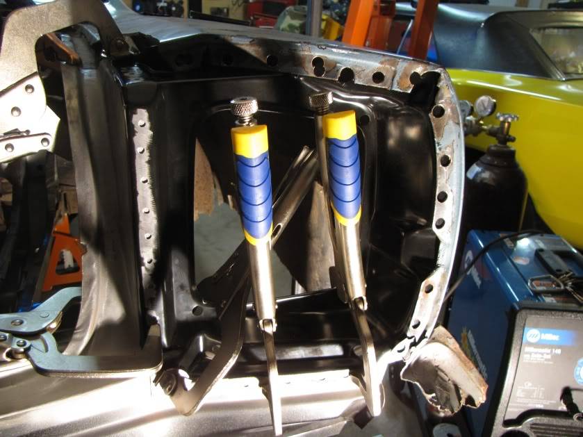

God Bless vise grips! I did have to use a couple sheetmetal screws on the driver side to be able to pull the metal tight against itself.

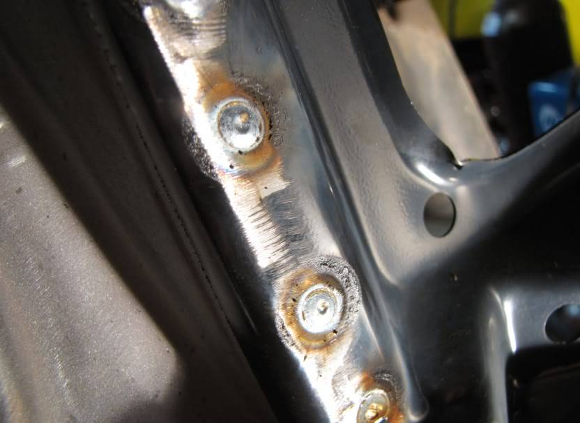

Just got to flaten these spot welds out a bit and the buckets are considered done. Off to the trunk pan this weekend!!!!!
