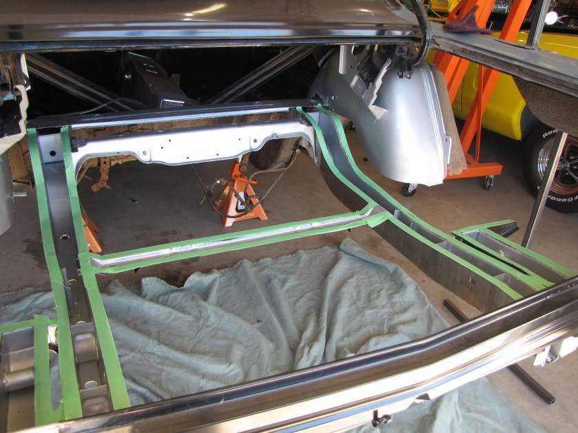

I coated the inner frame rails with Rust bullet and in this pick was about to put a nice few coats of 3M rubberized undercoating on top of that. Great stuff, applies well, comes with 2 pattern nozzles.

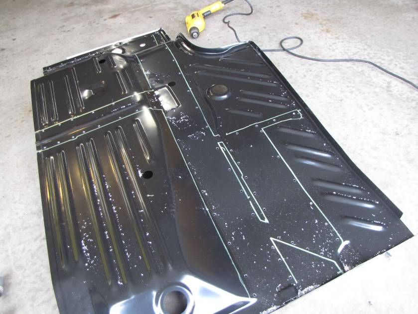

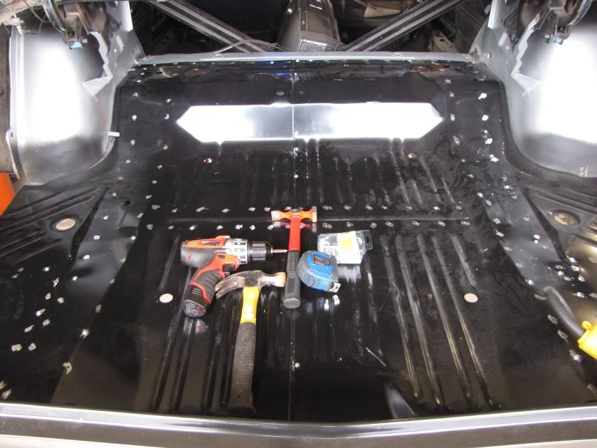

Pic of a half of the trunk pan after I fitted it in and traced the outline of the rails, brace, and spring hangers. Little trick works great for creating a visual template where to drill your holes for the plug welding

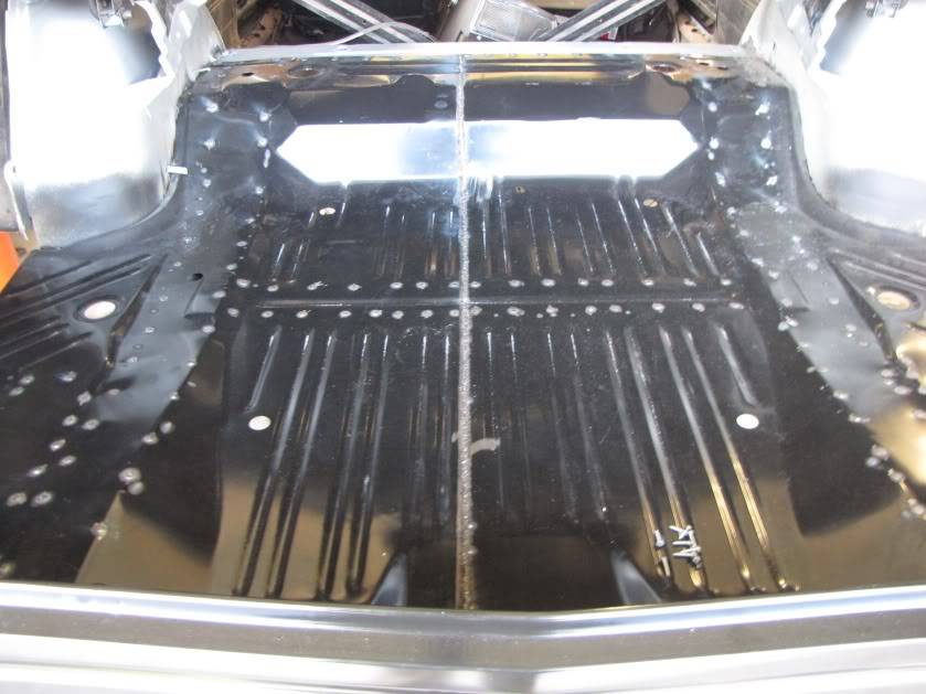

Both halves in, drilled and fitted with the help of several sheetmetal screws

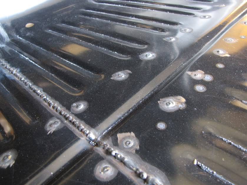

Finished product after filling in the plug welds, multiple tacking the center seam and welding the pan onto the inner wheelhouses

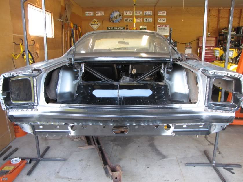

Somewhat coming together now with the fill panel now welded in to the trunk pan. I vise gripped the rear crossmember on and started tweeking that part for proper fit up and alignment.

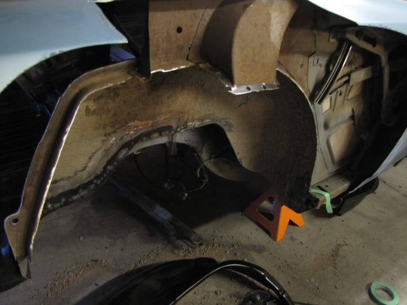

Some work done tonight.... Cut off the outer wheel house next to the seam from outer to inner. Just ended up initially cutting around the torque box, then once the main portion was detached, drilling out the torque box to outer wheelhouse spot welds and removing the remaining metal.

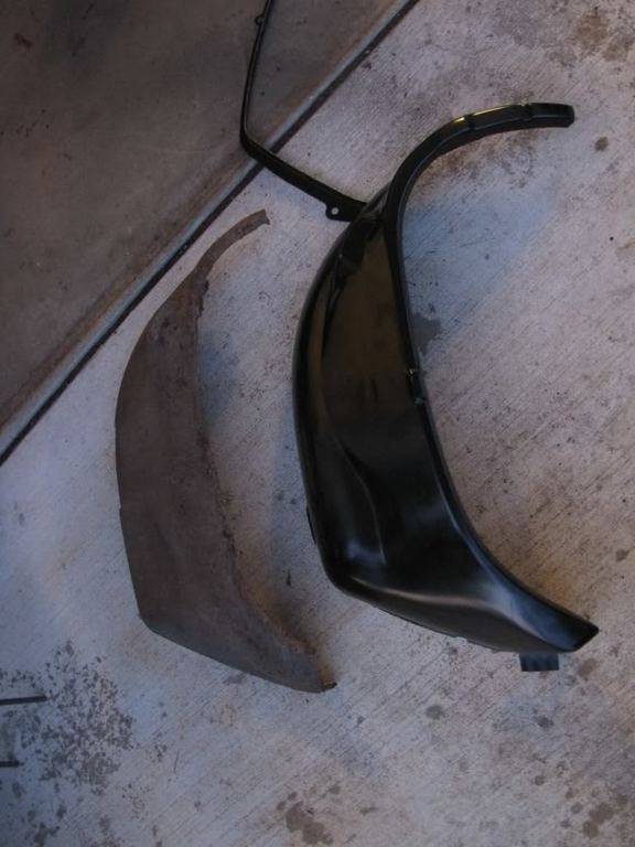

After using the old wheel house for a cutting template for the new, it was time to trim off the new part to fit accordingly. Kudo's to you guys that remove the whole wheelhouse via factory welds at the seams. There is a staggering amount of spot welds joining the two and almost a continuous stitch type welding towards the front.
