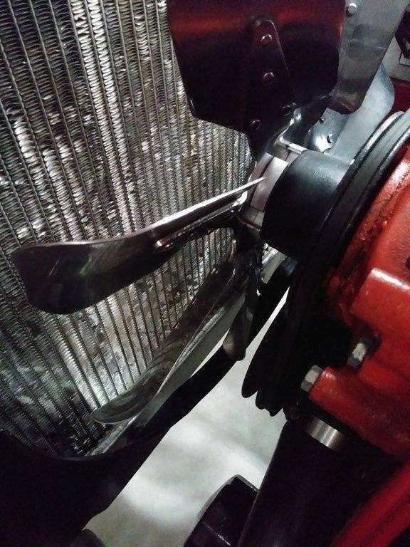

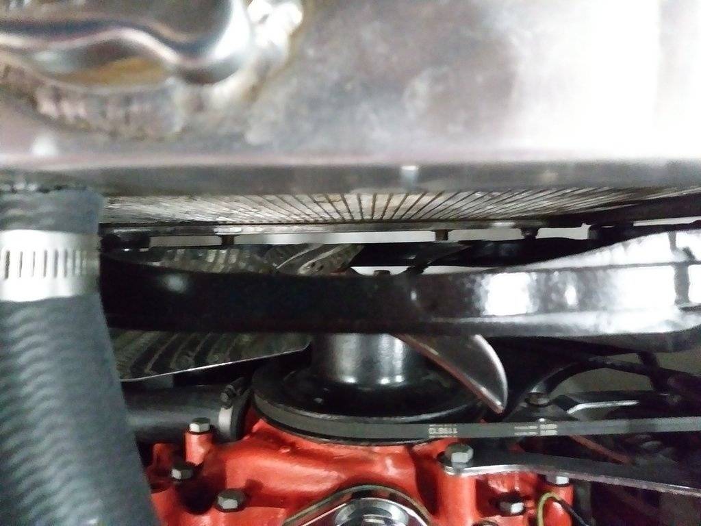

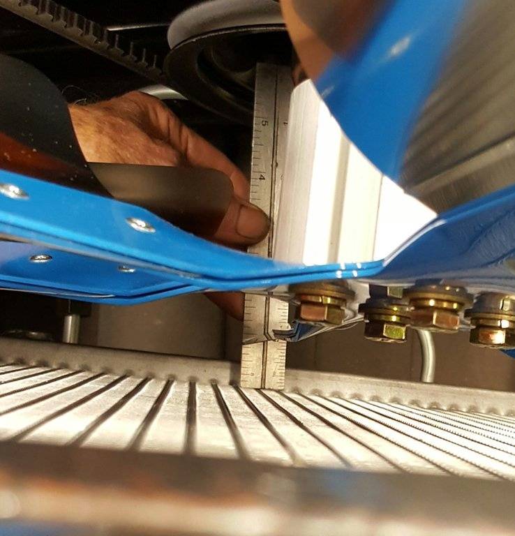

Trying to make up my mind on this distance. Worked out at 3/4" at the bottom, 1-1/2" at the top. Leave it or shorten the fan extension?

Back to your install though, I would think the closer the better if your not going to run a shroud, as you need ( especially at idle or slow speeds) the negative pressure side of the fan pulling through the radiator and not from around it. Using a shroud allows the distance to be increased because there is no other place for the air to come through except the radiator.

The guys at HAMB had a thread about this a while back and I remember the radiator shop fellas saying something about "if you aren't leaving flesh on the radiator fins when installing the fan, you're not close enough". :-)
The consensus seemed to be no closer than 3/4" without shroud (enough room to get the fan belt over it when it throws one out in BFE). With shroud, the fan should be positioned 1/3 outside and 2/3 inside the shroud.

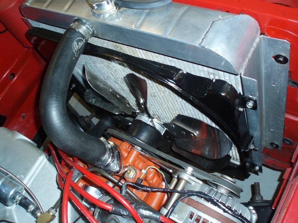

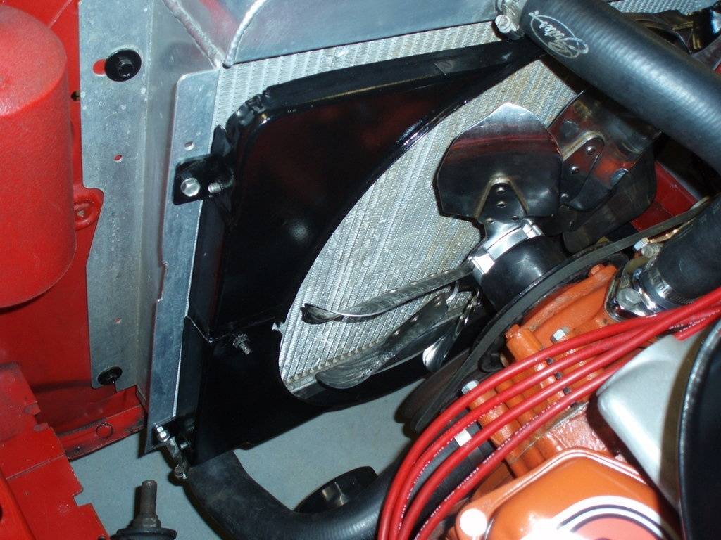

Your fan clearance is exactly where I put mine. Works fine. I'm running a stock 7 blade steel fan though. I have seen those flex fans come apart at high RPM. I was able to use an original steel fan shroud after a little adapting to my 22"alumnum radiator and it cools fine. Got a nice glass beeded original shroud off EB for $45.00.

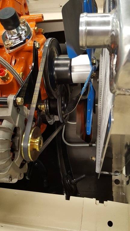

I only have 2-1/4" from the pump flange to the outside edge of a fan to work with, so I don't believe a clutch setup will work.

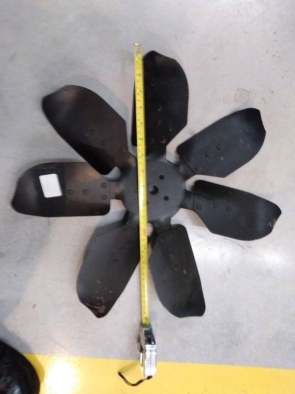

I was looking at this fan, I've bought two used ones so far, from swap meets, and both need work. I like new when possible.

Your fan clearance is exactly where I put mine. Works fine. I'm running a stock 7 blade steel fan though. I have seen those flex fans come apart at high RPM. I was able to use an original steel fan shroud after a little adapting to my 22"alumnum radiator and it cools fine. Got a nice glass beeded original shroud off EB for $45.00. View attachment 427212 View attachment 427213
You got a great deal on your shroud MW. Must have been a few years ago. Have you seen what the two piece ones are going for today? And they are reproducing them also. I like your setup :thumbsup:
Get a stock 7 blade fixed fan and a shroud. That will work perfectly.
Or you can buy a cheap aluminum radiator, cut the brackets off, move them forward and gain 1/2-3/4 inch more clearance and run the Hayden super short heavy duty fan clutch and fan. I did this on my 69' Dart with a 383 as there wasn't much room for the clutch fan....worked great and I have 1/2-5/8 clearance from the clutch to the core.
