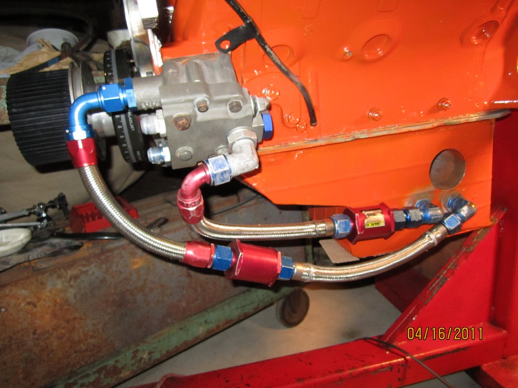

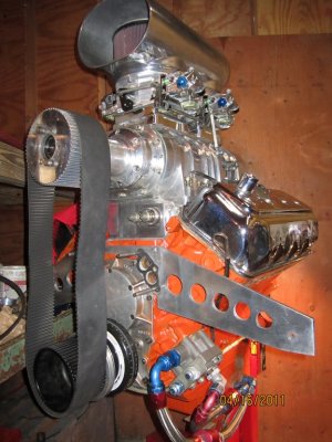

I use a Milodon dual line oil system with a dual remote oil filters.The Milodon pump flows a minimum of 19 GPM and increases with RPM.Years back I always used the fram hp oil filters untill a roller lifter failed,chewed up the cam sending contamination throughout the entire engine.I was f'n pissed to say the least:eusa_boohoo:I wanted to know how all that metal made it through the oil filter:icon_scratch::read2::thinker:Turn out when 19 GPM hits 2 filters that can only flow 10 GPM EACH,the bypass opens up and your not filtering DOODELY SQUAT:confused2::thatswck::mumum:So I now use the Moroso filter that can flow 16 GPM each and these filters have NO BYPASS!!Also use the Earls prefilter in the oil pick up lines coming off the oil pan:idea1:
Problem solved:bootyshake:I'm sure Wix makes one without the bypass,just stuck with the Moroso:munky2:
