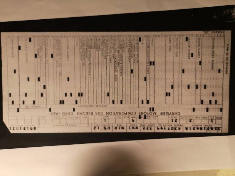

Well, got the ibm card today (happy happy)
Anyone know how to decode it?
If you can post a real good picture of it here. Then I'm sure someone will decode it for you...
Based on your IBM card the original selling dealer code number is 07395. So there is a chance that someone may know what dealer had that code number.

Here is some of the things that I come up with in decoding the IBM card.
1964 Belvedere 2 door hardtop.
White paint with a red interior.
Built in the St Louis plant.
Auto Transmission.
A/C
Tinted Windshield.
Seat belts, 2-Front.
Tires 7.50x14 black side wall.
Undercoating.
318 engine?

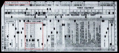

Ok here is how to decode the alphanumeric values.
Vertical columns run left to right 1-80 labels are at the bottom
Horizontal rows run top to bottom R,X,0-9 labels are on the right or run all the way across.
The columns are arranged in groups of 1 to many columns
The punch(es) correlate(s) a column to a alphanumeric value for what that column represents by what is written in it.
One punch in a column represents a numeric value 0-9
Two punches in the same column represent a letter A-Z
Here is a link to the complete punch card character set
http://www.columbia.edu/cu/computinghistory/026-card.jpg
Example:

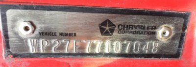

columns 16 - 28 are the Vehicle Identification Number which should match the metal tag in the door jam.
WP27F77107048
In column 16 (car line) there are 2 punches, one in row 6 and one in row 0, this represents a W
In column 17 (price class) there are 2 punches, one in row 7 and one in row X, this represents a P
In column 18 (number of doors) there is 1 punch in row 2, this represents a 2
In column 19 (roof type) there is 1 punch in row 7, this represents a 7
In column 20 (engine) there are 2 punches, one in row 6 and one in row R, this represents a F
In column 21 (year) there is 1 punch in row 7, this represents a 7
In column 22 (plant) there is 1 punch in row 7, this represents a 7
In column 23 (sequence number) there is 1 punch in row 1, this represents a 1
In column 24 (sequence number) there is 1 punch in row 0, this represents a 0
In column 25 (sequence number) there is 1 punch in row 7, this represents a 7
In column 26 (sequence number) there is 1 punch in row 0, this represents a 0
In column 27 (sequence number) there is 1 punch in row 4, this represents a 4
In column 28 (sequence number) there is 1 punch in row 8, this represents a 8
