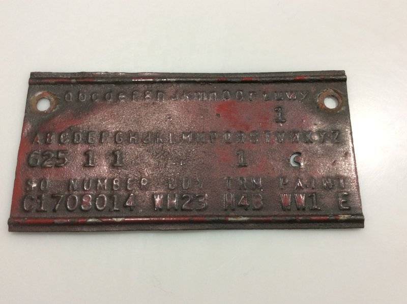

Fender tag colour different from original colour.
There is no trace of red anywhere on the car.

HHHHMMMM I don't know I'm not buying it... So they covered the crappy red paint on the vin tag and painted it a different color??? I've asked a couple of time for picture of the whole car So we can see what it really going on... and nothing.. and asking for where other ID's would be located sounds like someone looking to change ID's and piecing something together that it is not..
I don't know I'm out..

Why is the tag not attached to the car?
is the red paint actually red oxide primer that I find on so many mopars? and built at a plant that didnt attach tags permanently until after paint?

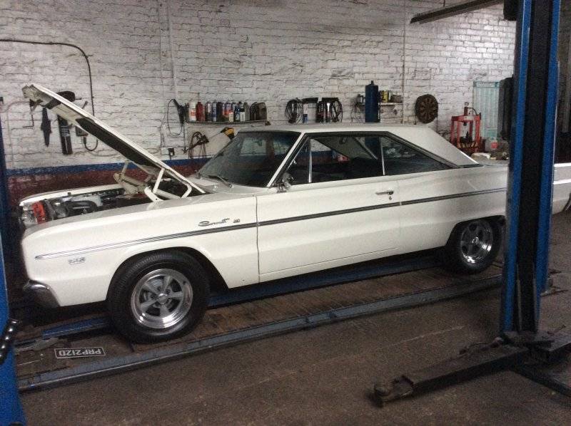

Tim there’s nothing dodgy going on with this car and to prove it here are some photos as you asked.
The tag was screwed on to the inner fender and no it’s diff not red primer.
I’ve added the core support number too.
Also after cleaning the underside of the tag there is trace of white paint.
As you can see from the pics under the hood has been painted Matt black, but I will be returning it to white.

Nice car..
Does the Vin tag give interior color?? maybe it came with Red interior that would explain the vin tag being red most of the time (I think) the under hood color matches interior color? Maybe someone/time during its refurbish the interior was changed?

i took this picture an enlarged it to 340 enlargement and I think I see hints of Red bleeding thru the black on the fender by where the tag came from and on the front around the latch.. Might just be an optical illusion?? someone else try it and what do you see. It also might just be reflection off the wall??

Under the hood should be white just like the car, so someone painted it red, then black.. or someting like that...
After painting the engine compartment black they might have just painted the tag red to highlight it. No big deal, looks original.
Nice looking ride :thumbsup:
Way back in the 70's, I took my fender tag (purple paint) and stripped it then painted it black to make it stand out more. Silly kid thing, don't ask me why I thought it was a good idea. But maybe somebody else had similar thoughts.
Car is coded for blue interior on the tag- which it has.
Great colors on that body style.
One of the perplexing things about the tag color is that it looks old and OEM, with just the right amount of patina.
Also- if someone painted it on purpose....why wouldn't they have done a better job?
It would have been easy to do a MUCH better job.

Well if you look close you can see white paint under where he pulled the tag from.. So It was white under the hood... as far as the red tag only the painter knows..

I can confirm the interior is blue vinyl.
I’ve scrapped some of the black paint of the rad cowl and yes there is trace of red paint.
So my guess is maybe someone made a mistake at the factory and started painting it red along with the tag then realised and stopped.
Either way we will never know and I will be pulling the motor and putting it back white.
