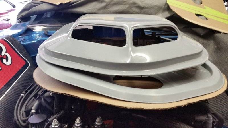

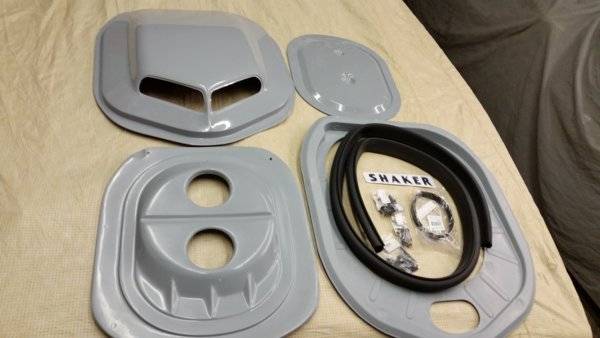

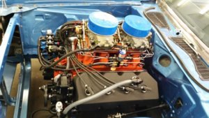

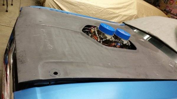

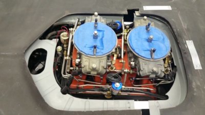

I am cutting a stretching the adapter ring, making a drop base plate a larger/taller scoop to adapt repro shaker parts to fit my tunnel ram and dual Dominator carbs on my Challenger.
No turning back now. May be more of a race car but still a street car so keeping a somewhat stock appearing theme. Lol.

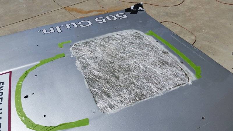

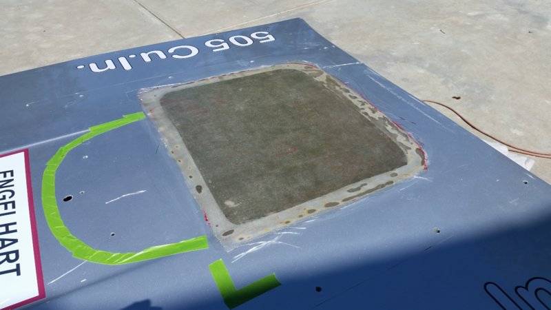

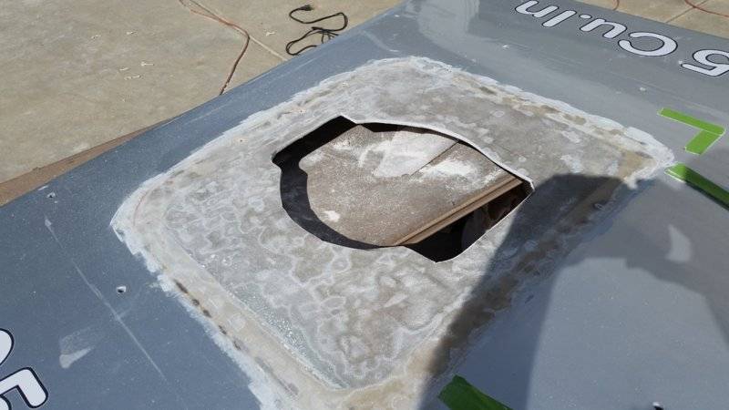

I had to fill a GIANT 24" SQUARE HOLE in my fiberglass hood. The previous owner of the car cut that giant hole for the hood scoop...way too big.
I used a sheet of aluminum from Tru-Value hardware store for my backing. Coated it with CARNUBA car wax and started my build up on that.
When I had enuf layers to get the thickness I wanted I then flipped it over and the finished fiberglass just lifted right off the sheet of aluminum.
I then cut the hole in a much smaller square size that I wanted.

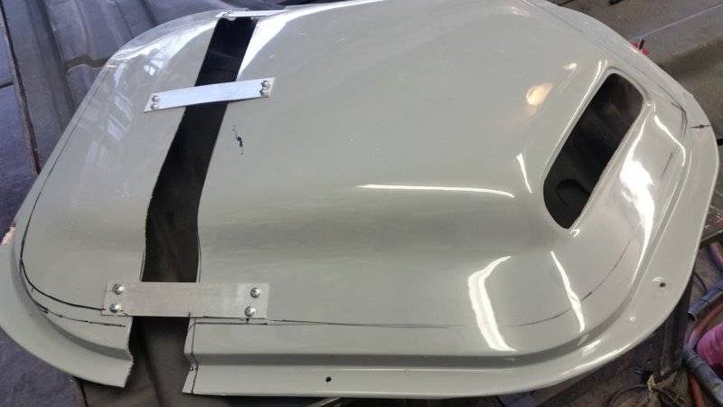

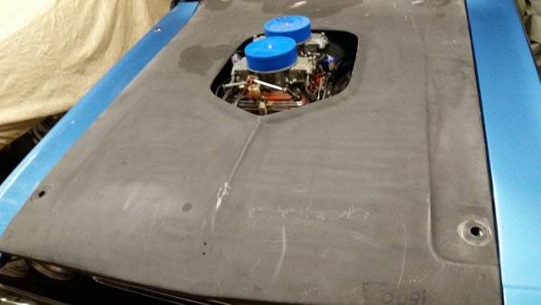

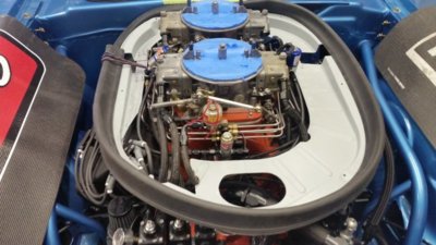

I know, I know, I am taking too long. Believe me, I wish I had more time & money. Finally got out into the garage a little . Got the scoop, hood and base stretched 3" & fitted all around everything to fit the dual dominators on a tunnel ram, sits nice. Even will still be able to use the seal to seal it all of to the hood. Marked the scoop as it sits now to know how much of it stick thru as it is. Going to fiberglass it all back together & then stretch the height next.

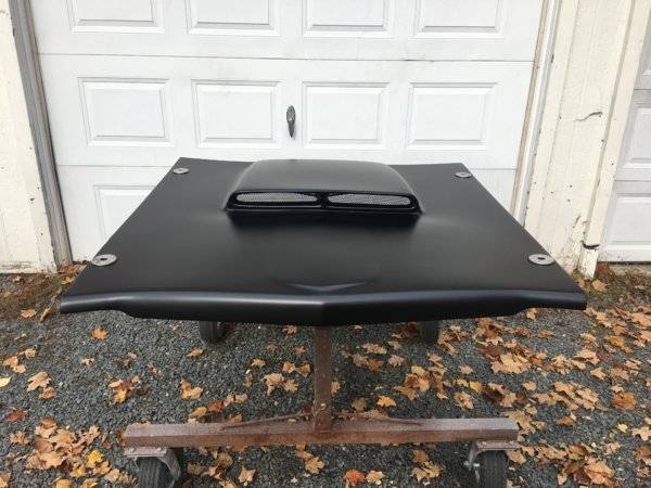

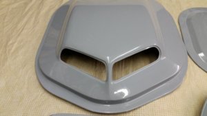

Here's the one I made from scratch using a wooden form and oriented mat. One poster says use woven because it's stronger...... yes it is but your not building an airplane either! I only suggest the mat because it's much friendlier to work with in contours and waaaaay strong enough for a scoop.. they make boats out of the stuff!
I'd remove those riveted brackets, mount the scoop to something flat, prep the outside, prop up any sag, tape off the inside gap and glass the gap shut. I'd sand a long bevel to a thin edge allowing the repair to overlap a couple inches on each side then start off with mat wide enough to fill the gap progressively making the strips wider to fill the bevel until you've built the thickness slightly above the original surface. You should have no trouble pulling this off easily with great results. :thumbsup:
Thanks for the tips. Yes, I will be removing the brackets eventually. I am just using them for all of the mock up stages for now to make sure everything works , lines up & how it looks more than anything.
