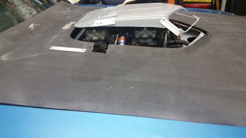

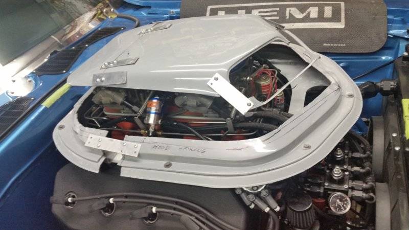

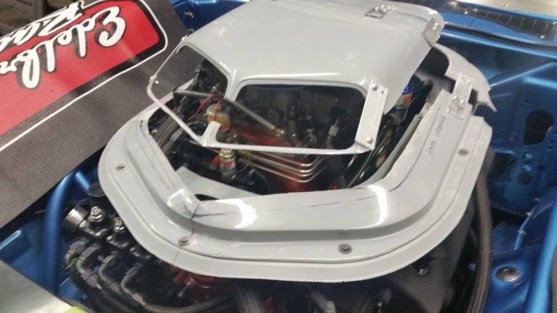

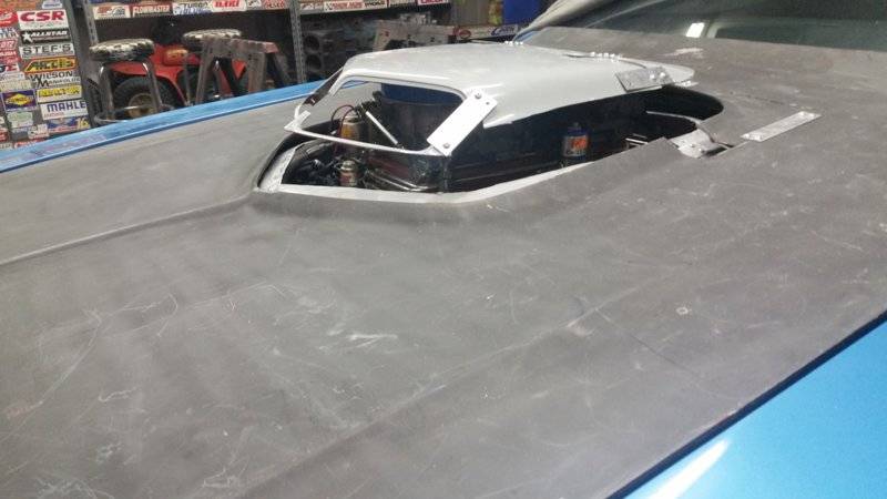

Worked on project Super Shaker a little more this weekend. Time to start fiberglassing it all back together next. Stretched the Nostril openings down slightly to see how it will looking from 2-1/2" tall openings to 4" tall openings. Not pictured but I made some aluminum stanchions that also joined the lower base to the upper bubble to keep the needed spacing & distant correct & everything center to the hood opening. What is my easiest way to continue from here?

Hmmm, might try spray foam? If you have it pretty secure just fill that puppy with spray foam then cut and sand the foam that bulges out to shape, glass it all in then remove the foam? The foam could be quickly removed with a wire wheel on an die grinder once the bulk of it is cut out?
Experiment on the foam first, the resin may eat it. If it does eat it then just paint it with latex paint prior to glassing it.
Okay, thanks for the tips. I will have to check to see what type of resin they sent me next time I go out in the garage. I don't remember?
It's pretty simple - if your resin needs a few drops of hardener, it's polyester. Epoxy resin is usually mixed as two equal parts of liquid.
Polyester resin might eat it but epoxy resin which costs more but bonds far stronger shouldn't dissolve it.
My dad built a KR2 airplane and used nothing but Epoxy, tuff stuff. To bad life and health kept him from ever getting it off the ground. At any rate that's where I learned how to work fiberglass.
