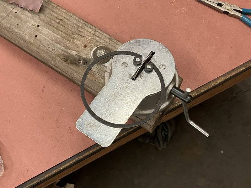

My 400 stroker is a good example of when you need file to fit rings. I am currently at .042 over with some coatings on the pistons to handle the bore size. But, I need to get the rings right and nothing standard will work. So, I get to file them down (really not hard with the right tool). Plus, then I can tailor them and make the second set of ring gaps slightly larger and as "ideal" as I can make them.
I knew that I wasn't the only one that filed and filed...then found that I went too far past the .025 gap !
Use the side of a grinding wheel and a small, fine straight cut file to deburr and close the gaps by hand while looking into a light to confirm they're square, then put in cylinder to check, it's tedious but not bad once you've got the hang.
No way.....That takes material off way too fast. I have enough trouble with the hand crank file!
