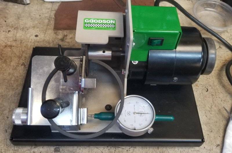

Nobody has mentioned the most important thing when filing Moly rings, which most top rings are & sometimes the 2nd ring. The Moly is an insert. You should file/grind inwards so as to not chip or dislodge the Moly.
Numerous tests have shown that slightly larger ring gaps do not cause any noticeable HP loss & practice these days is to make the 2nd ring gap slightly larger than the top ring.
The worst thing you can do is have the gap too small, which can cause bore scoring, glazed bores, etc.
