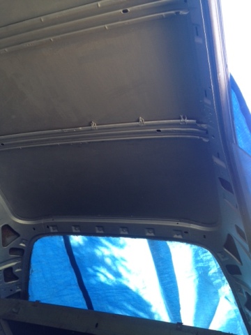

Nice ride 440+6...Well worked OT yesterday at work so didn't get a chance to work on the car til this morning. Prepped another section of roof and got it painted in rust bullet. Gonna wait for it to cure up then get started on the prepping of the rest of the roof. Overhead work is pretty tiring so I find doing it in sections a little easier.
Also I tried getting as much as I could down into the seams where the outer panel goes past and into the bracing. But anybody got any tips on how to get it real deep down in there. I'm guessing to spray it in? Anybody got anything better?
what did you use to clean the inside of your roof. that is something i have to do on mine.
I don't know if you have anyway to get into it from the rear, but if you do eastwood has a rust proofing kit that has a long nozzle with a special tip for spraying the inside stuff like the rocker panels. You could possibly put a flexible hose on it to get into tighter spots. Keep plugging away.
I used my grinder with a wire wheel. Then when I was all done I cleaned it real good with some mineral spirits. After that I applied 2 coats of rust bullet.

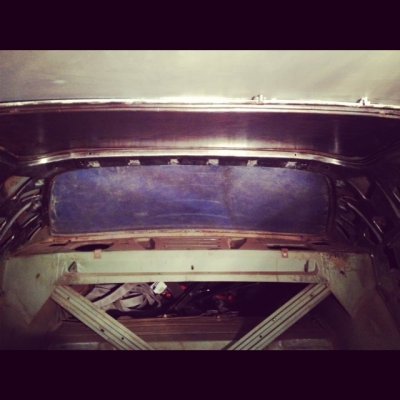

Put in a good nights worth of work.

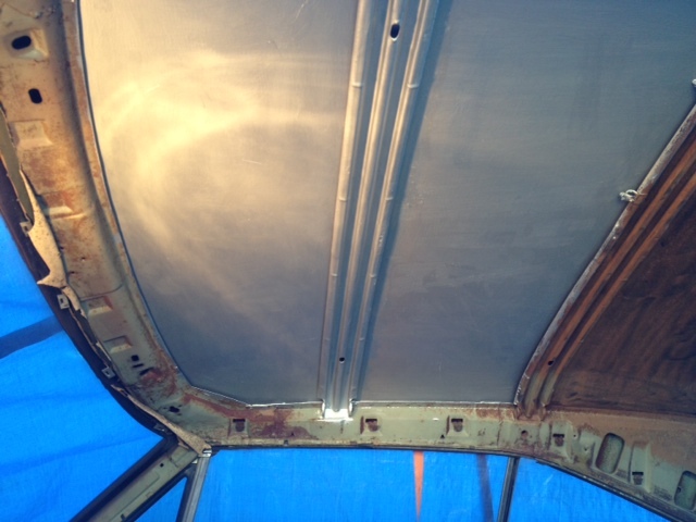

Took a picture about half way through the prep work

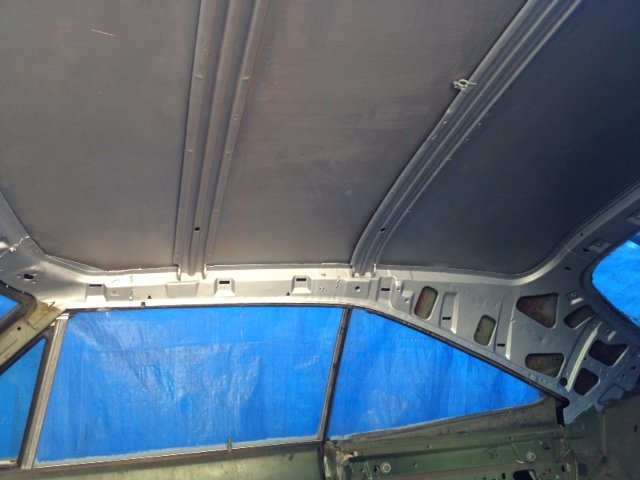

Finished with the rust bullet lastnight. Phone died cause I was listening to music working on the car forever. So went out this morning and snapped a couple pictures before covering her up for the rest of the weekend.
Nothing like being cooped up in a car wearing a respirator filled with rust dust for awhile. So finished my goal of getting the whole roof done in rust bullet. Was worth the hours of work.
Looks like it was worth it to me. That looks like brand new metal. Helluvajob.
Thanks. I wanted to quit half way through and just do the back portion then finish off the rest today. But figured I'd be more satisfied if I just got it all done in one shot. Was definitely worth it.
I agree, That does look like brand new metal, real good job it looks great!

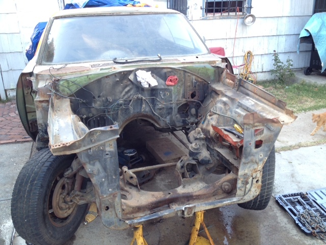

Was looking at my inner fenders and radiator support and pretty much have come to the conclusion that there going to have to get replaced. Anybody have any tips on inner fender replacement. I'm thinking of taking the car to a frame alignment shop when I get some of the sheetmetal off to double check to see if everything's alright. Or I'll measure it myself
This may help on the measuring.
