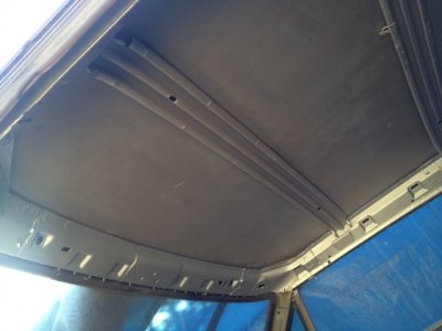

Put in a good nights worth of work.

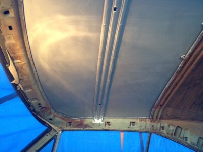

Took a picture about half way through the prep work

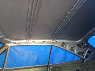

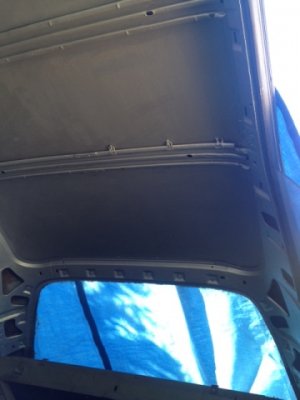

Finished with the rust bullet lastnight. Phone died cause I was listening to music working on the car forever. So went out this morning and snapped a couple pictures before covering her up for the rest of the weekend.
Nothing like being cooped up in a car wearing a respirator filled with rust dust for awhile. So finished my goal of getting the whole roof done in rust bullet. Was worth the hours of work.
Looks like it was worth it to me. That looks like brand new metal. Helluvajob.
Thanks. I wanted to quit half way through and just do the back portion then finish off the rest today. But figured I'd be more satisfied if I just got it all done in one shot. Was definitely worth it.
I agree, That does look like brand new metal, real good job it looks great!

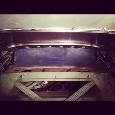

Put the window back in when I was done just so the interior of the car isn't out in the open. No cancer or any real pitting in the whole firewall area. So just gotta clean it all up and give it the same treatment as the roof.
Was looking at my inner fenders and radiator support and pretty much have come to the conclusion that there going to have to get replaced. Anybody have any tips on inner fender replacement. I'm thinking of taking the car to a frame alignment shop when I get some of the sheetmetal off to double check to see if everything's alright. Or I'll measure it myself
