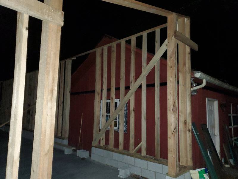

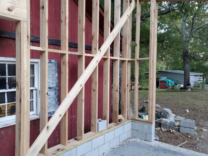

Update . . . and tonight's short session . . .

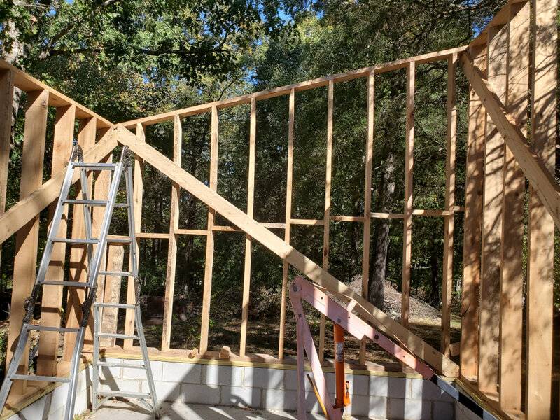

Here's the picture of the cross brace that I added and forgot to get a picture . . .
Then tonight I had only about an hour and worked on the fire stops ( and additional bracing ) . . .
MAN does that stiffen up the supports ! ! !
Will be working on this tomorrow . . . installing 2 headers . . . and more on the fire stops . . .
More later . . .

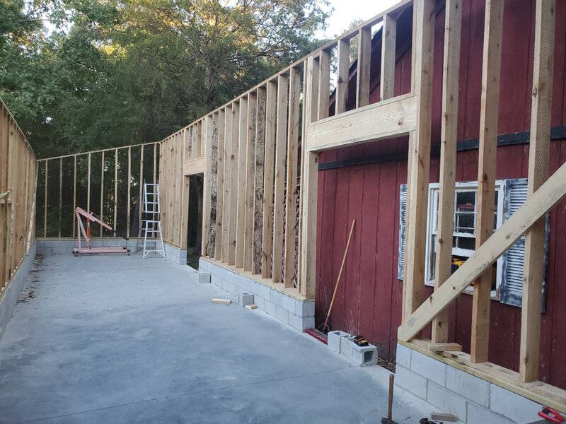

Tuesday Hooky Progress . . .
Had a good day, nice weather, and great progress on the shop . . .

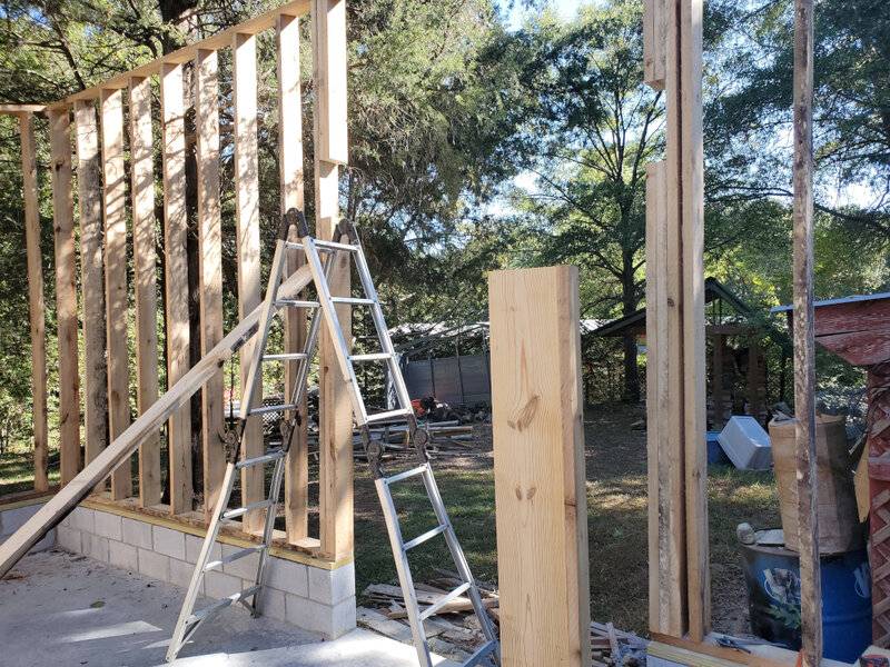

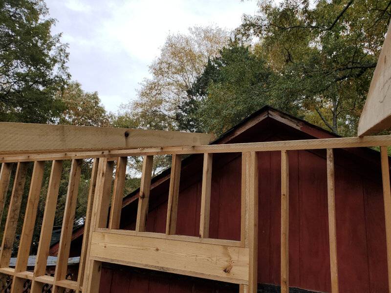

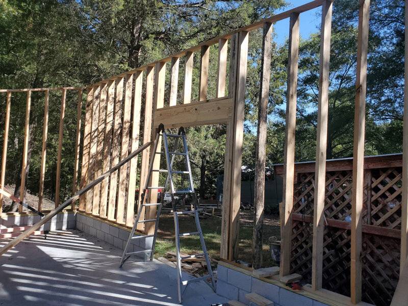

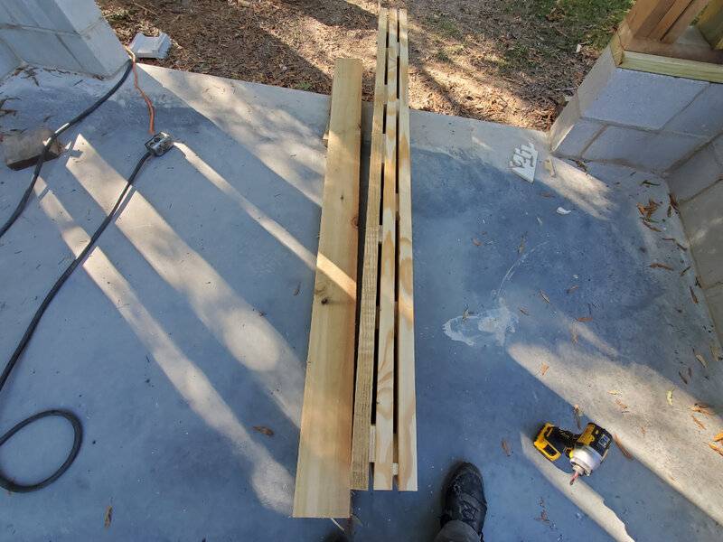

Building one of the headers . . .

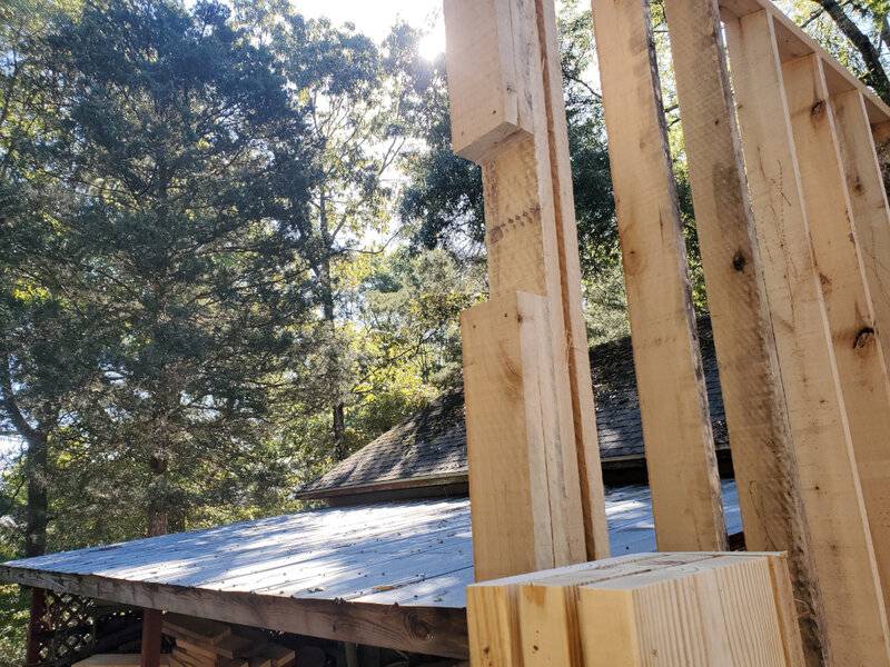

Now the uprights need to be notched properly to fit the header . . .
Another reason that it was not built into the wall was weight - and being able to pick it up . . .
Got both sides notched to accept the header that was built . . .
Now for the "fun" part . . . getting that thing up into place ? ! ? ! ?
Got 'er done . . .
Then the section of wall to go above the header was built - and ready to set in place . . .

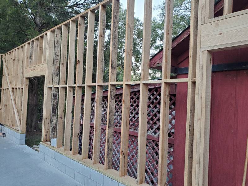

One of the doors has been framed . . .
Header in place for the other doorway . . .
And the framing above the header in place . . .
Also worked some more on the fire stops for this wall - they are not needed but I like the way they help stiffen up the wall.
All in all, it was a good day, and lots was accomplished . . .

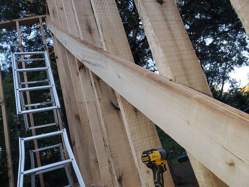

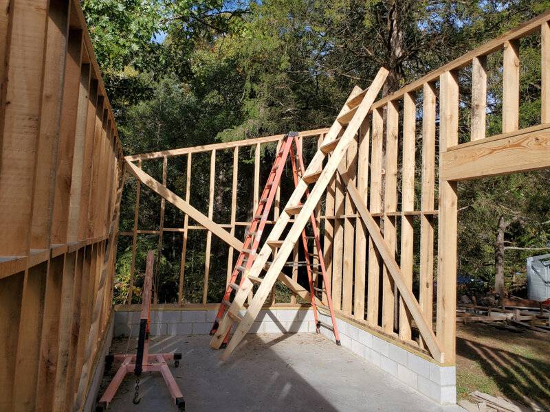

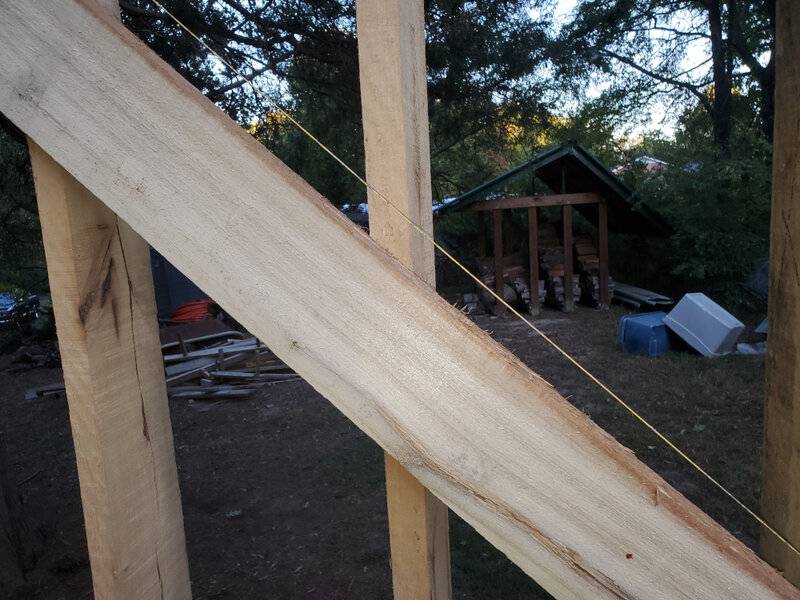

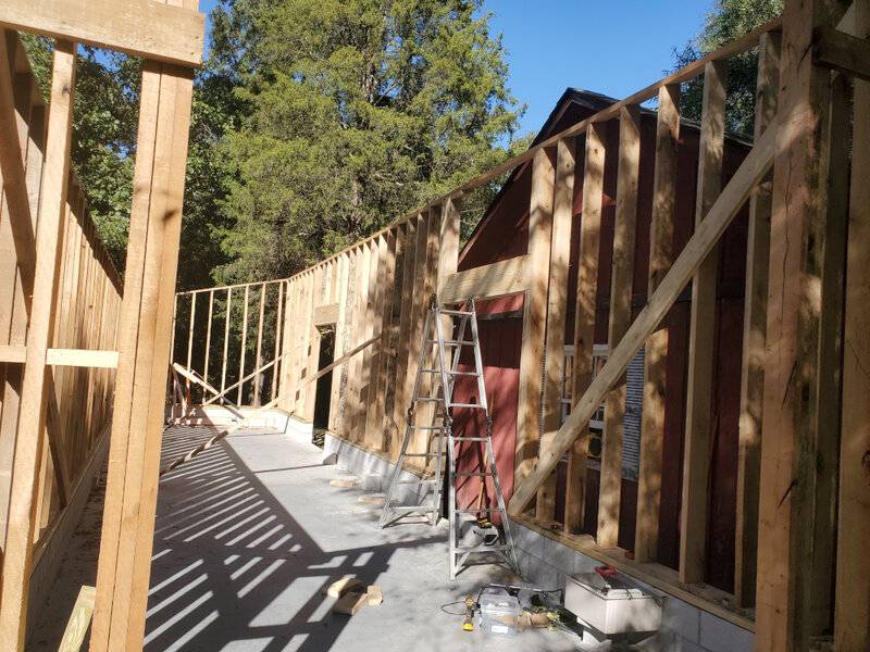

Started by adding a cross brace to the back right wall . . . but had fun with this warped board . . .
And here's proof that I was not joking . . . both ends of the string . . .
Also added one to the back wall . . . that thing is now ROCK SOLID . . . it does not MOVE.
And you can see that I've got the firestops done in this wall too . . .

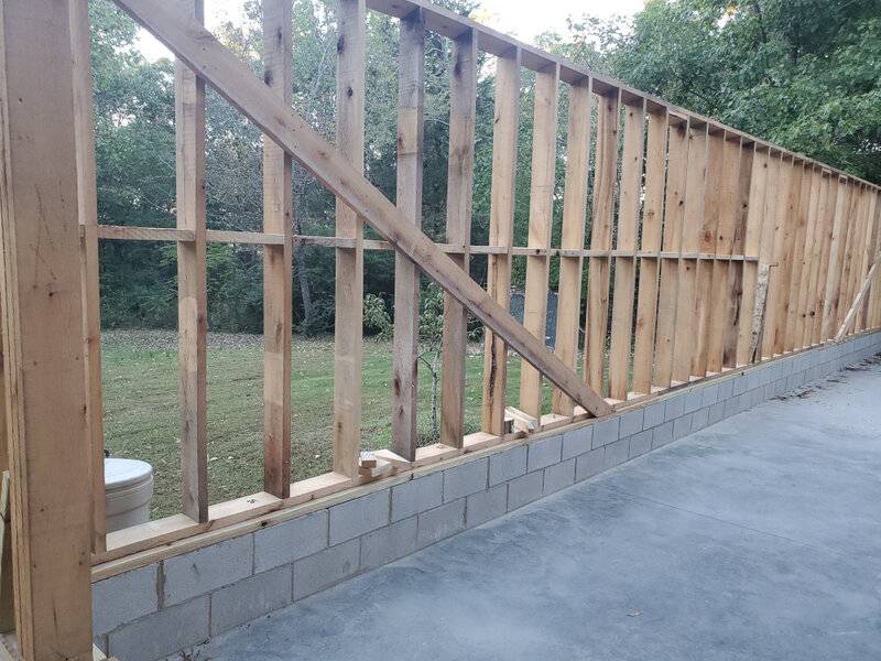

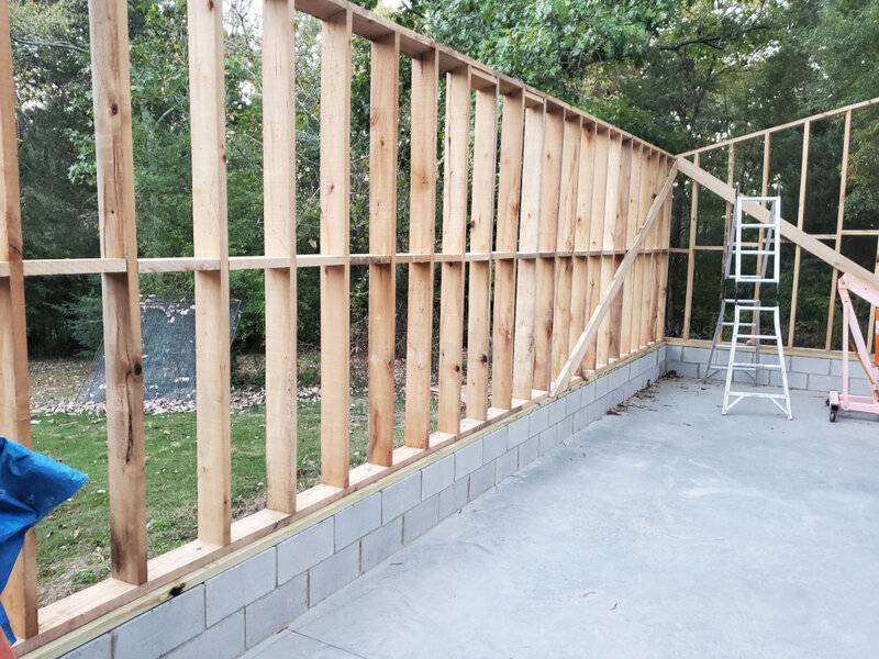

Actually - got all of the firestops done in all the walls on the shop . . . was a good day . . .
The right wall . . .
The front of that wall . . .
And the remainder of the left wall . . . feels good to have that done . . .

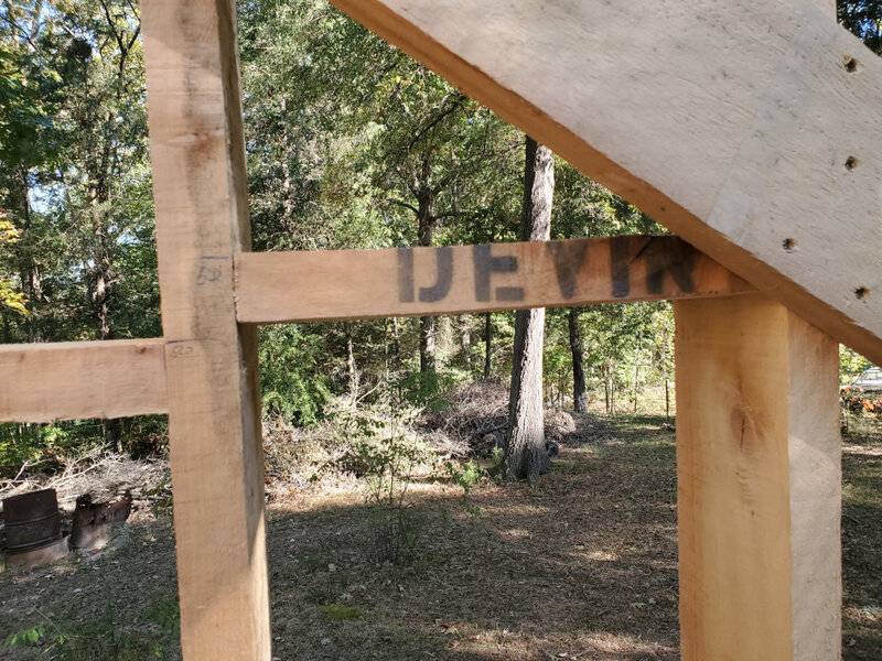

Here's my favorite board in the shop . . . actually there are 2 of them . . . Thanks Devin @747mopar for your help ! ! !

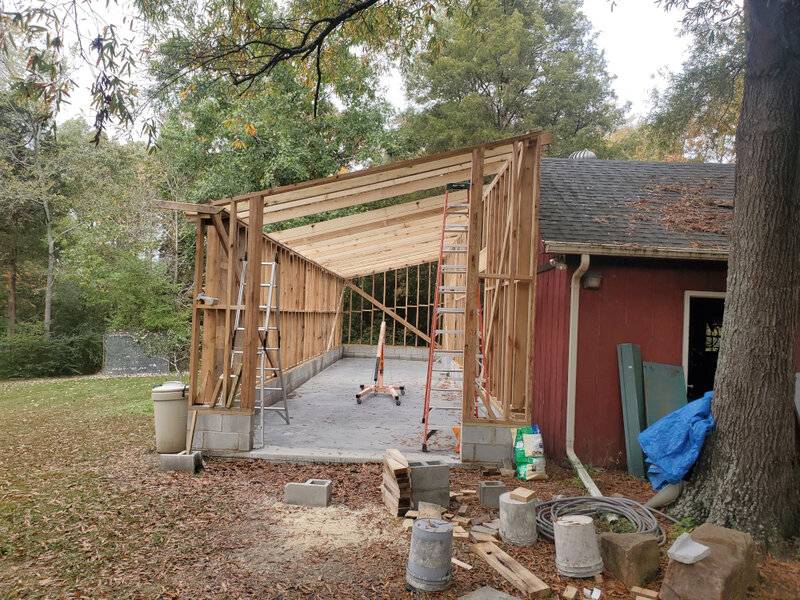

Wow . . . what a day . . . Good day, but slow in progress . . .

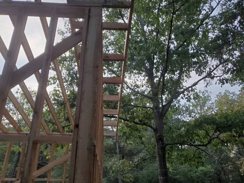

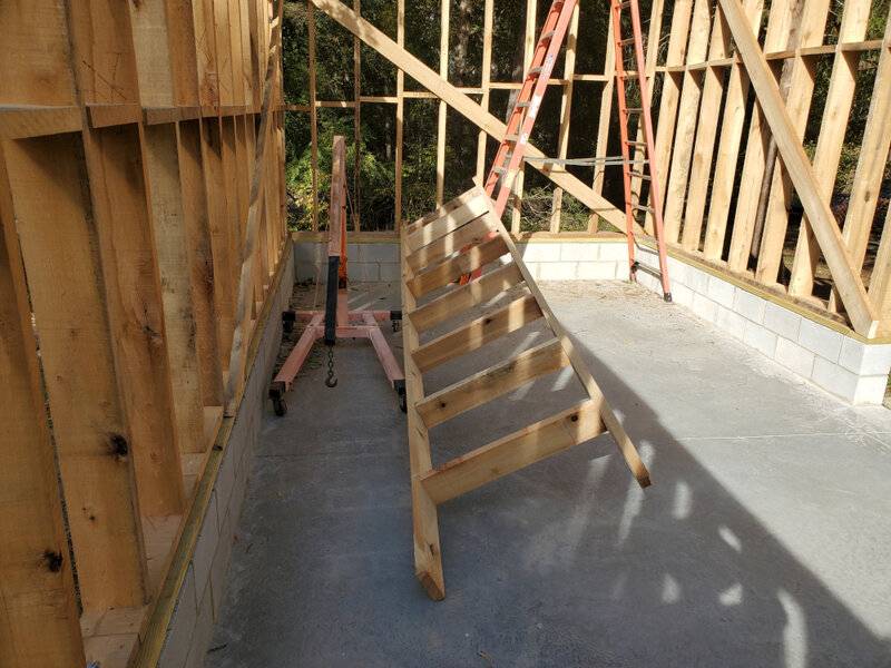

Guess climbing up and down ladders on each side of the rafters . . . slows one down a bit . . .
Built this to go on the end and better support the overhang on the back . . . got it at 16" . . .
Now . . . just need to get it up there and in place . . . OH BOY . . .
First thing, wrestled it up onto the wall . . . that was no simple task . . .
Then literally climbed the other ladder while carrying it up with me . . .
Clamped it down . . . moved it into position . . . aligned it . . . the screwed it down into place . . .

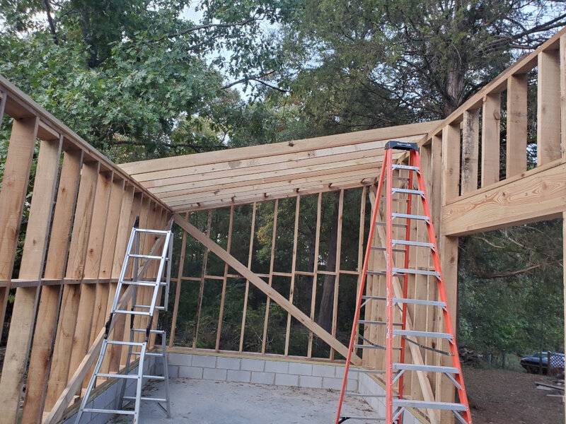

After getting that into place . . . the rafters started to go into place a lot quicker . . .
Spent a lot of time on the first one, because all the rest will be referenced off of it . . .wanted it done "right" . . .
A closer look at how that went into place . . .

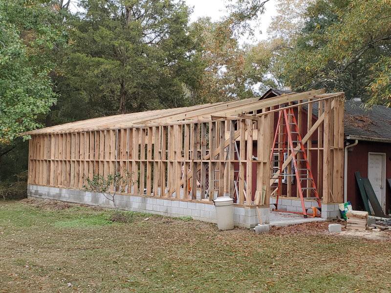

The overhang on the back of the shop . . .
And the side overhang on the shop . . .
The ladder climbing added a large slow down, and my progress was greatly reduced, but did make good progress.
My hope was to get all the rest of the lumber up on the shop - that did not happen ( got about half of it )

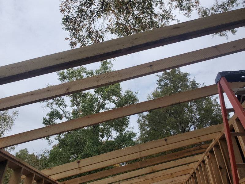

Today's progress . . . and Milestone . . .
Today's progress was good and it allowed me to reach a Milestone . . .
ALL the lumber I got for my build is now installed in my building . . . but I'm short and need more ( it's ordered )
The location of what "used to be" my lumber stacks . . .

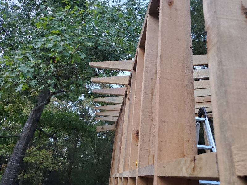

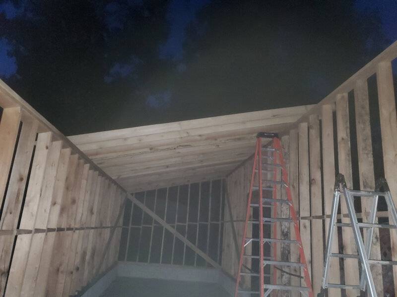

Spaced out the last of the roof rafters - will fill in the gaps with the newer (wet) lumber . . . figured it would be better
to inter-mingle them then have them all together - since they will shrink as they dry . . .
Had 2 boards that were pretty badly warped . . . in opposite directions . . . which helps . . .
These (2) boards that are sistered together are them - clamped them to get them straight - then screwed them together
Now as they sit there and further dry, they'll "assist" to remove the warp form their sister board - then I'll split that and install them
One more item that I'll have to address . . . is what to do here . . . ( not too good on the planning side . . . )

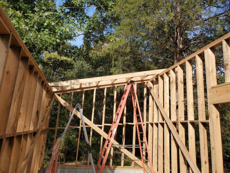

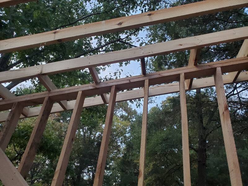

Starting to actually start looking like it's a "shop" . . . .
After getting this all done - I noticed . . .
- the string I set up to align the rafter ends, was not even, it tapered in as it went to the front (good thing I noticed before getting all of them installed)
- - went back and had to re-adjust about 8-10 rafters - but they're all good now (at least I'm happy with the results now)
- the measurement at the top of the wall did not match the bottom of the wall . . . so I did some adjustments on that too
- - every rafter top was unscrewed on the "high side" as I worked through the measurements
- - got them moved both in and out in a couple spots and got them as close as I could ( I'm happy with the results )

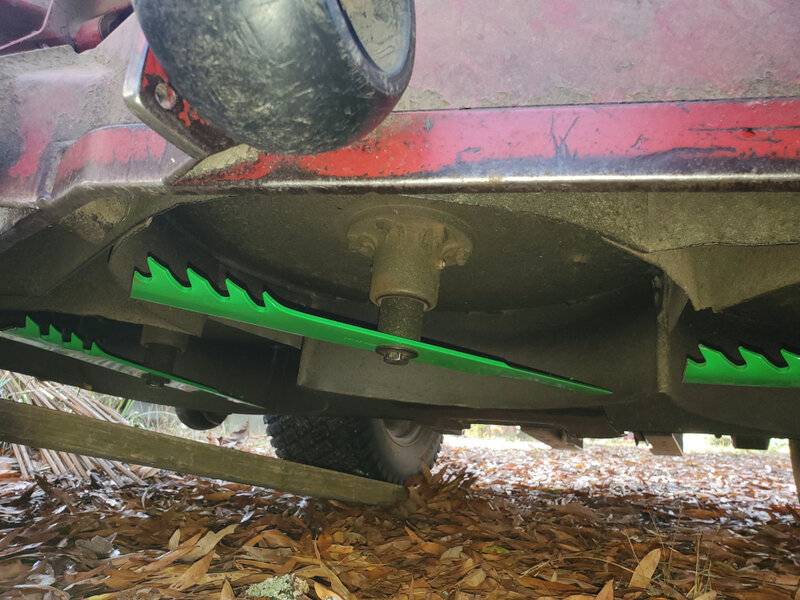

Then I got some new, nifty, mulching blades for the mower, to assist with the leaves . . . but (of course )
They were listed to "fit" . . . but I had to do a little fabrication to make them work . . .
Had to cut off 1/2" from each end on all three of the blades . . .
And, I'm really happy with the new blades as they do a great job with mulching the leaves . . . as you can see below . . .

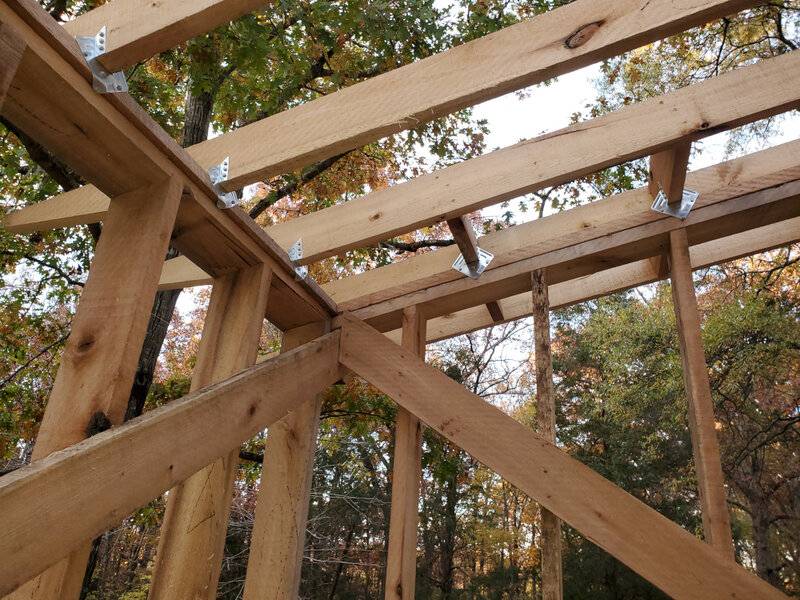

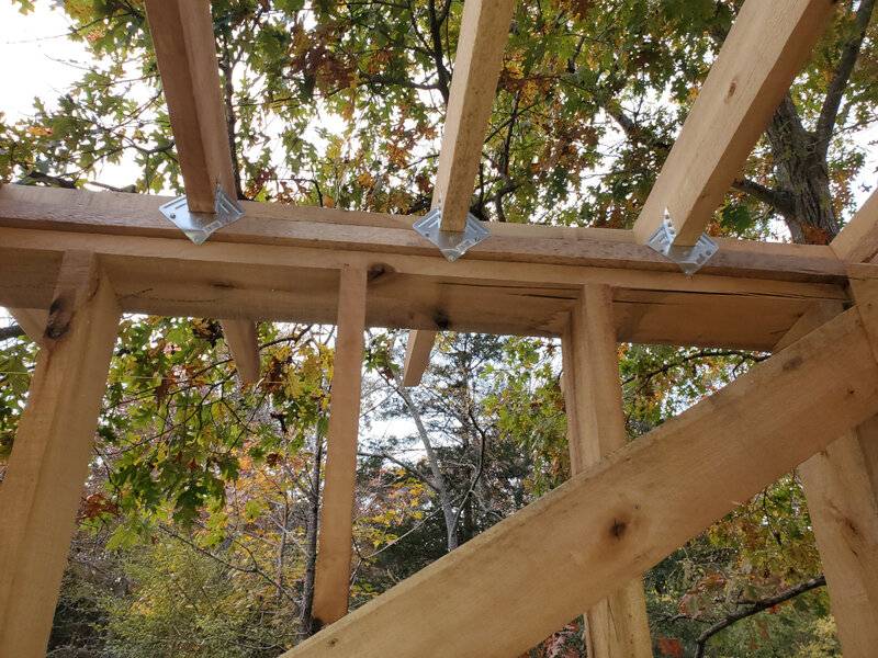

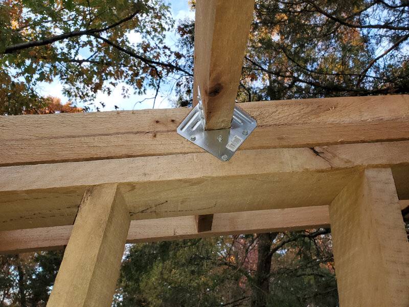

Still working on the shop, as I've got a lot of hurricane straps that will be installed to all to the rafters . . .
we don't usually get them here, but Hugo did hit Charlotte pretty bad,
and we do get some tornados - from time to time - so I'll put these on and play it safe . . .
This is the side rafter - that sticks out the back overhang . . .
And the short wall hurricane straps . . .
This will be a better picture for you to see the difference between the overhang, and the short wall . . .

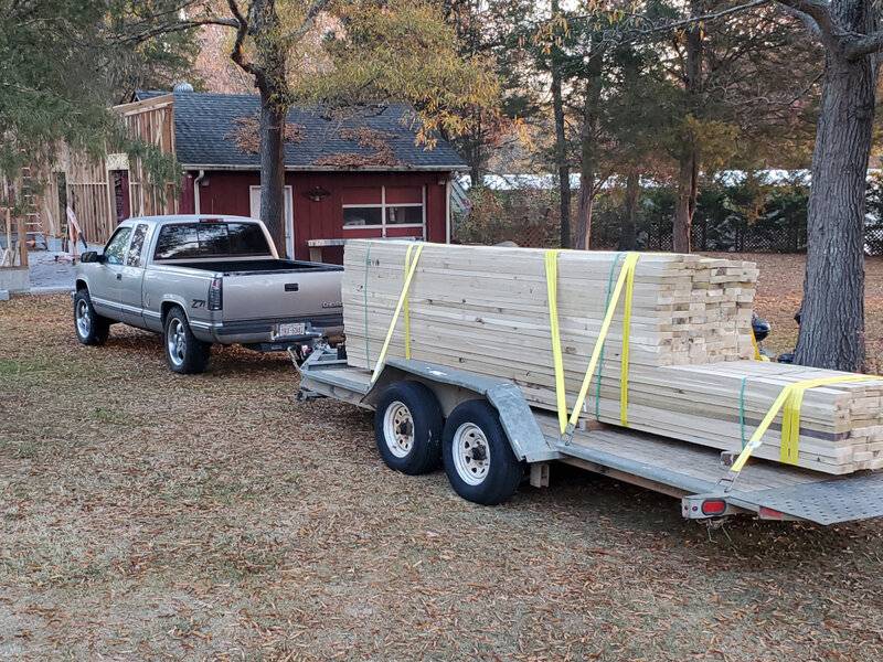

And, my load of lumber is sitting, still on the trailer, waiting be be unloaded, and for the work to begin . . .

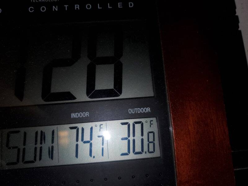

The other controlling factor . . . since the last time I was building and sweating my arse off . . .
This is what I've got this morning to work with for temps . . . OH BOY . . .
Guess I'll be giving the day a little bit of time to warm up and I'll be back at it . . .
