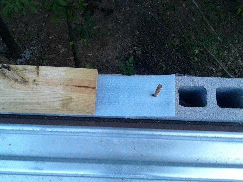

A thin layer of foam...then a treated 2x6...then your standard 2x6...
Time to roll...

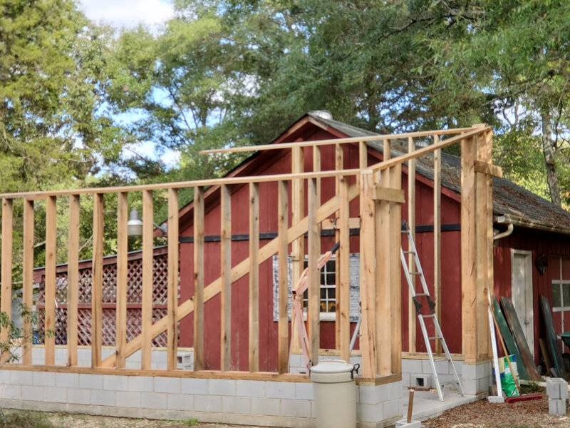

Got the second panel built and ready to go in place . . . had it on top of the sill plate, trying to line up the bolts in the holes . . .
Confession - dumped the panel over the wall onto the grass . . . that's when I decided I need "another" way . . .

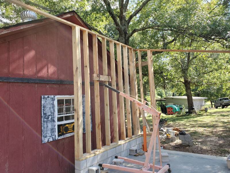

So plan B - re-purposing the engine cherry picker, it's now a shop wall lifter ( and life saver )
I honestly think that this saved my behind and allowed me to get all this done this weekend . . .
Panel two going into place . . .

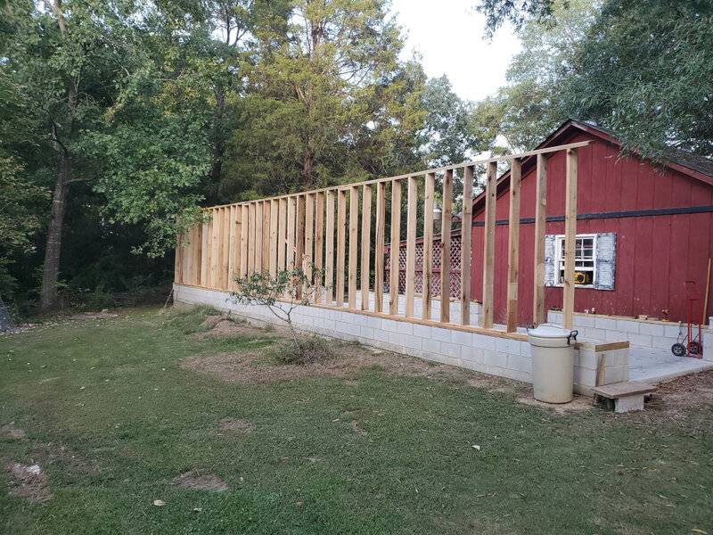

All of the panels in place on this wall - the shorter 50' wall section is now done . . .
And I like the way it's looking . . . looks like I need to do some tree pruning too . . .
This is site for these sore old eyes . . . glad to see it finally coming together . . .

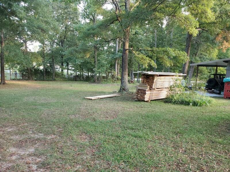

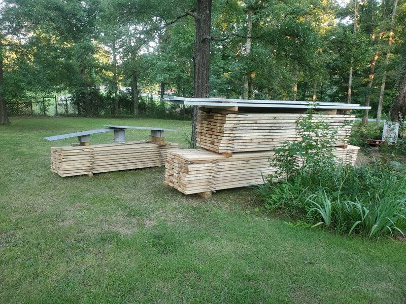

Low and behold . . . my lumber piles are shrinking . . .
Before . . .
And after . . .
Sign of progress . . . .
More later . . .

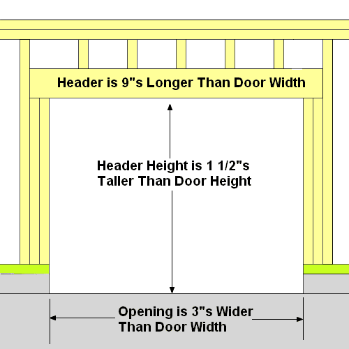

How are you planning on installing the header for the garage door in the end wall? It should bear on at least 1 of the 2x4's in the end wall. The header will take a small roof load and part of the weight of the garage door.
It's not going to tie in . . .
This "part" will allow me to empty the existing shop, then dismantle the old shop, and finally build my bigger shop in its place . . .
That's the plan . . . At least . . .
I had wondered the same thing, and now we know! Looks like a fun project.
Once I get my door and the height, I'll get it put in at the correct height . . . That's the purpose of the triples on both sides of the door . . . It's not in the drawing as I await the actual door height - looking for 8' height on the door - I hope

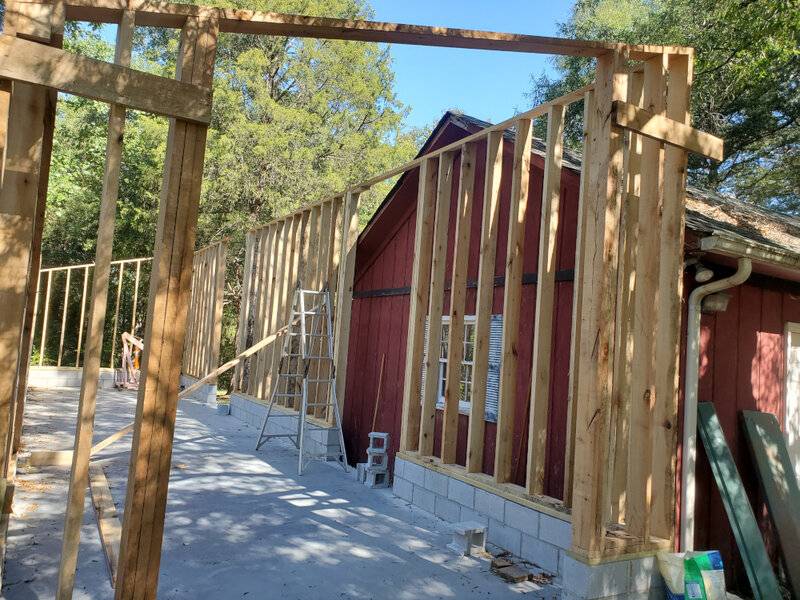

First I started with adding this support brace in place to stiffen up this corner . . . and properly space the joists . . .
Then . . . came one piece of the tall wall . . . this was a real paint to lift ( probably due to extra height )
This corner is looking good . . .
So . . . moved on to the next wall and got it ready to set in place . . . but did I have enough left in the tank to get it set . . .
Could NOT let it get me . . . got the thing lifted and set in place . . .
And from the end of the "shop" . . . this thing is coming together NICELY . . .
Only a 16' wall to set in place - that's going to be FUN -
Good thing I have to go back to work tomorrow so I can rest a little . . .
More later . . .

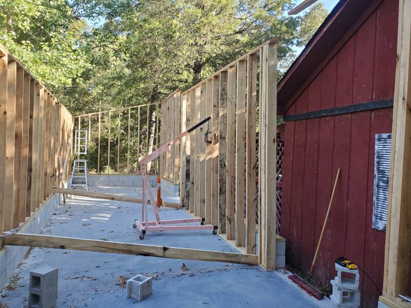

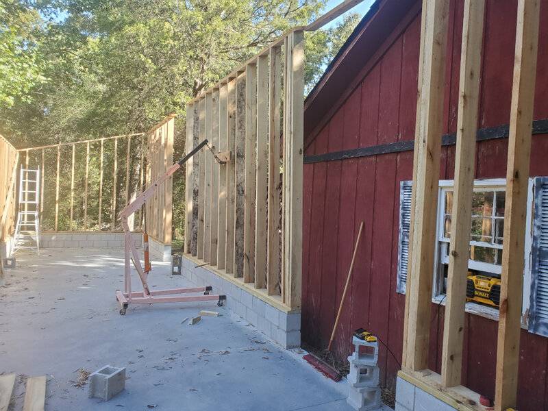

Last week - I got this diagonal bracing in place and the 16" on center spacing assured on the joists . . .
Then Friday night, got everything cut and assembled to get the next wall in place . . .
BUT - the size, and weight, of the wall, and the night time . . . I opted to do it in the daylight for safety reasons . . .
Worked on a couple different options . . .
Lifting it with a ratchet strap . . . WAY too slow
Using supports (cinder blocks seen below) worked pretty well . . . but slow . . .
Could lift one side fairly easily - but needed a way to hold it in place once lifted . . . came up with this idea
And this worked great . . .
The clamp and the rough surfaces of the rough cut lumber held it great . . .
Just needed it high enough to be able the get my wall life (cherry picker) under the panel . . .
Got it there pretty quickly too . . .
Then got it all set up for lifting the wall . . .
Which it did with hardly any effort at all . . .
Had the swap the board from holding the wall up - to preventing the base from moving way from the wall
- this helped to "pull" the cherry picker toward the wall (the wheels are not very free wheeling) . . . it worked well
Once it was gotten to upright at the base of the wall . . . getting it into place went fairly quickly
( due to past experience with that other wall that have set in place . . . )
Additionally - the whole thing, with this very heavy wall . . . got done By Myself - safely . . . WHEW ! ! !
