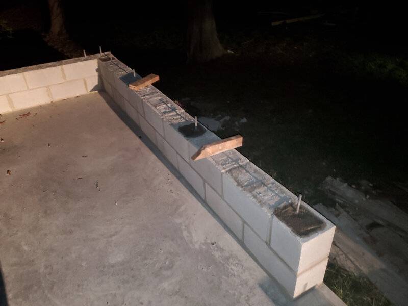

Anchor Bolt "jig" adaptation . . . and reasoning . . .
So . . . the "jig" was a "good" idea, but the threads on the bolts were snagging on the wood as it was pulled off
- and, as a result, pulling on the anchor bolt and changing the height, and angle . . . NOT GOOD . . .
So I needed a way to set the anchor bolt . . . and remove the "jig" while leaving the bolt "untouched" . . .
RIGHT . . . easier said than done . . . MAYBE NOT . . .
So I made a "minor" adjustment to the "jig" ( as seen below ) and the ability to remove the "jig" and not move the bolt was accomplished.
Now I've got this set up for the middle of a 2 x 6 - and vertical to make putting the boards on top of them easier ( I hope ).
So ( not ) looking to lugging MORE 80 pound bags of concrete mix and wet concrete around . . .
But . . . someone's gotta do it . . .
More later . . .

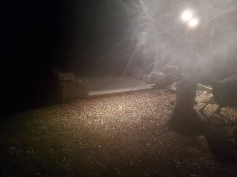

To keep the project moving along . . . what else is there to do . . . THE Night session . . .
Well . . . I took a page from my friend @747mopar and tried to do some work in the "cooler" night air . . .
Problem is . . . it might be a little cooler, but it's STILL humid as all get out here . . . Still ! !
Forgot . . . my carnage from the days work . . . 20 more bags . . .
But, I wanted to get (2) blocks cut and set so they can be filled with concrete and set anchor bolts tomorrow . . .

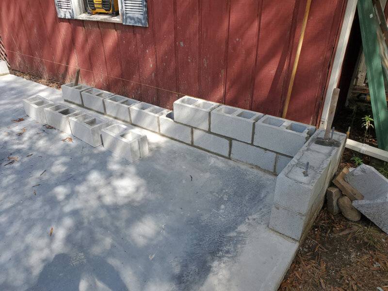

So the mortaring of the blocks last night allowed for me to do this . . .
Was able to get both of the front walls done . . . side one . . . ( my inspector checking out my work )
And the other side . . .

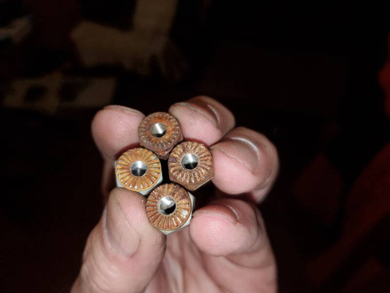

Only "trouble" that I thought I had . . . these nuts would not fit - so on the lathe, drilled and tapped out to 10-32
These are VERY large - with a 1/2" socket head on them . . .

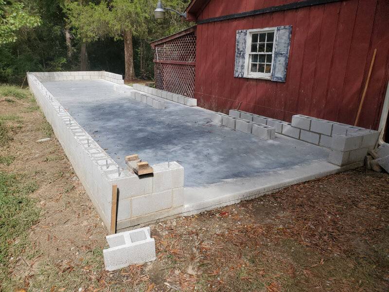

Now The block is finally getting done . . . Life keeps getting in the way . . .
Made some good progress this afternoon . . . on my last wall of blocks . . .
Only 4 1/2 blocks left to do in this wall . . .
Need the second course on this wall . . . and filled with concrete . . .
Only a single 1/2 block needed in this wall . . .
Getting there . . . two 6' doors . . .

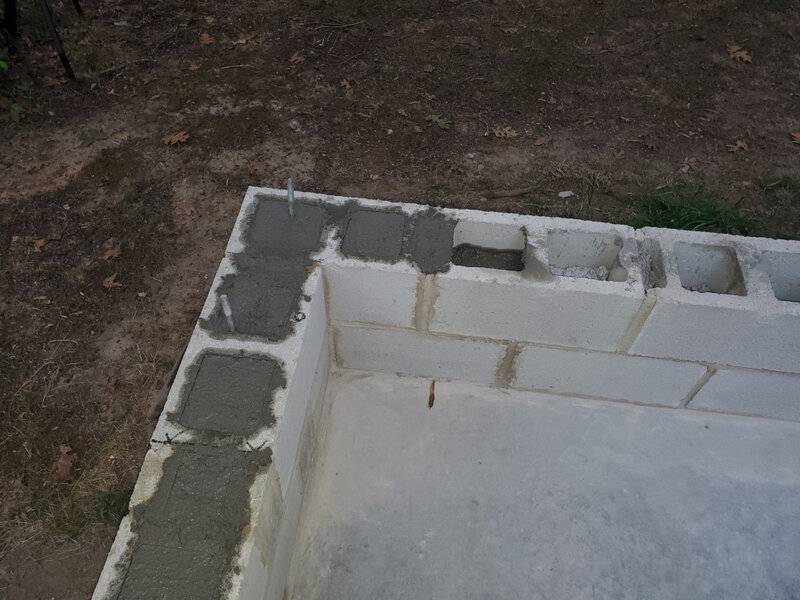

Filled all the 2nd course in the front blocks, and added 2 anchor bolts . . .
Filled all the 2nd course in the back wall, and added 3-4 anchor bolts . . .
Filled a couple more it the back corner with the left over concrete . . .
Will fill more of the tomorrow when I can see what I'm doing . . .

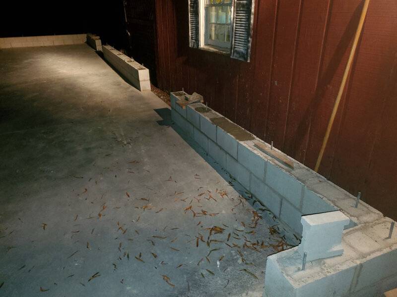

My after work . . . pre night time session . . .
trying to continue to make progress on this build, So I'm trying to knock things out as I can find a little time . . .
Great weather, cooler temps, lower humidity . . . so I'm trying to take advantage of it . . .
Happy that I made good progress and got the second course on this whole wall done . . .thought I mostly done with them
- then dumped the remainder of the mortar . . . and started mixing concrete to fill the holes . . . 1/2 the wall done !
Then I turn around and realized that I forgot about these 4 remaining blocks in this part of the wall . . .
- and I had the mortar to be able to get it done to boot . . . argh ! !

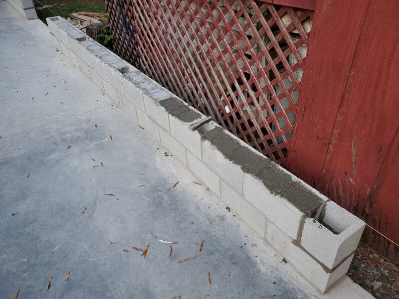

Last night I had to go buy 4 more blocks to get the last 4 1/2 blocks cut out of them and get them installed on the corners . . . also needed another bag of masonry cement.
Got the 1/2 blocks all cut and was ready for tonight . . .
The after work session:

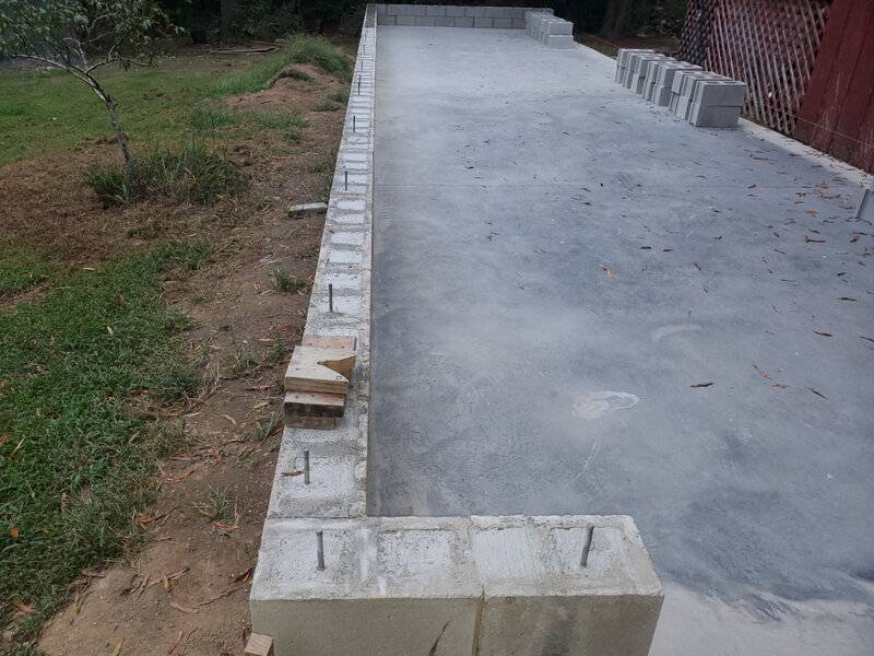

Got out and worked on the blocks again - and here's my progress . . .
The block work is done . . .
The front portion - just a few that need to be filled - and most of them need anchor bolts in them too
The center section . . . only a few more . . .
The back section . . . same here . . .

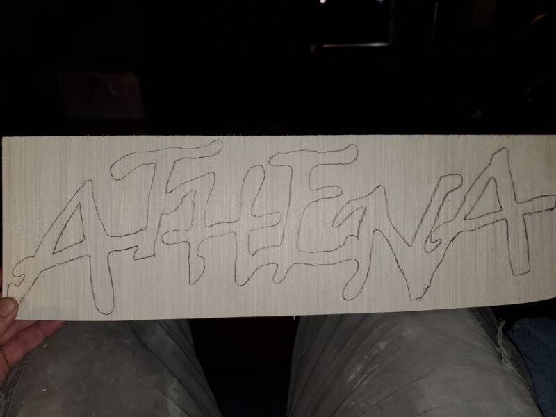

And now, for a little side project - for my newest granddaughter . . . here it is sketched out on wood . . .
Will show you the progress on this as it develops further . . .

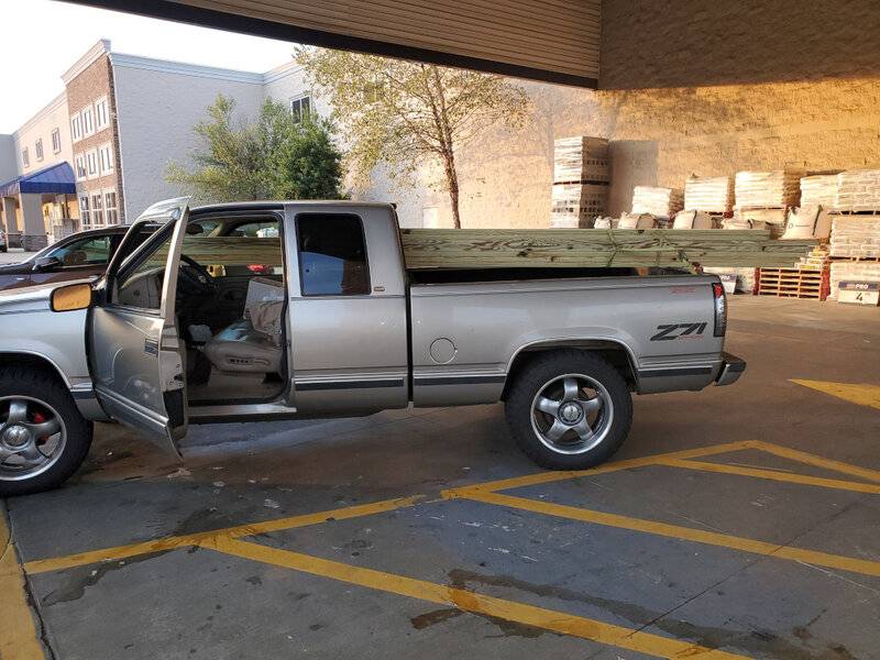

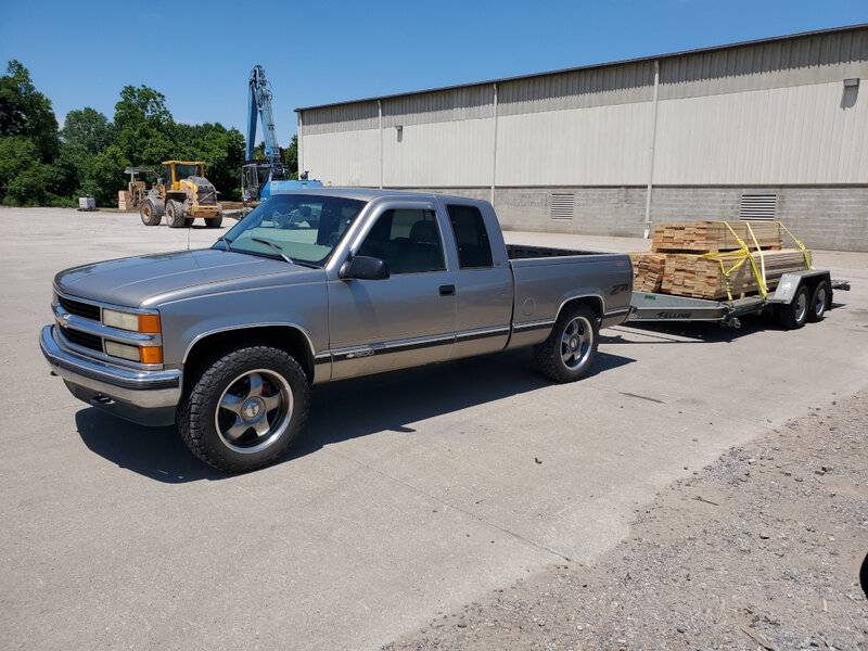

You must have missed, over looked, or forgot (because I post so many updates) the post on page 3 - post 57 . . .
. . . or this stack of lumber . . .
No need to wait . . .
