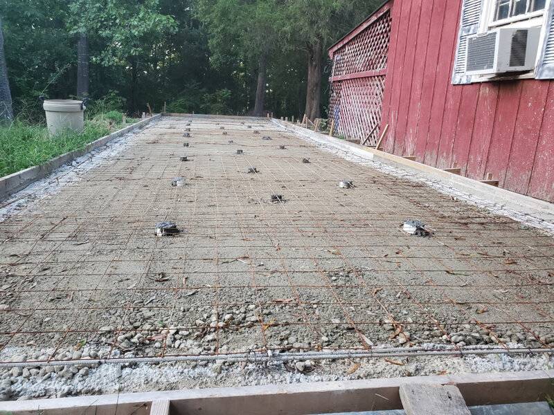

Working on the wire mesh now . . .
Got all of the full sheets tied down and together . . . need more ties but it holds now . . . and I've got them alternating sides for best coverage and support . . .
Just need to cut the last 2 sheets into 2' lengths and tie them into the holes on the sides . . .

Trying to finish up all the prep work . . . working on the stanchions . . .
Got most of them in place . . . got a few on the far end to put in . . . and might add a few on the sides . . .
To keep the mesh off the ground and "somewhere" in the middle of the 4" of concrete . . . (I hope)

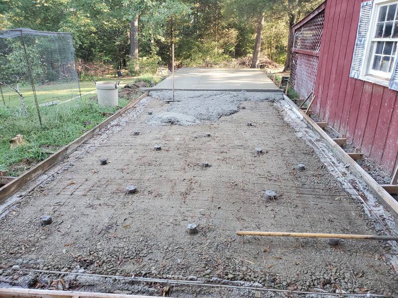

Getting it all on the ground . . .
And then the bull float to get it all level . . . we're at the half way point now . . .

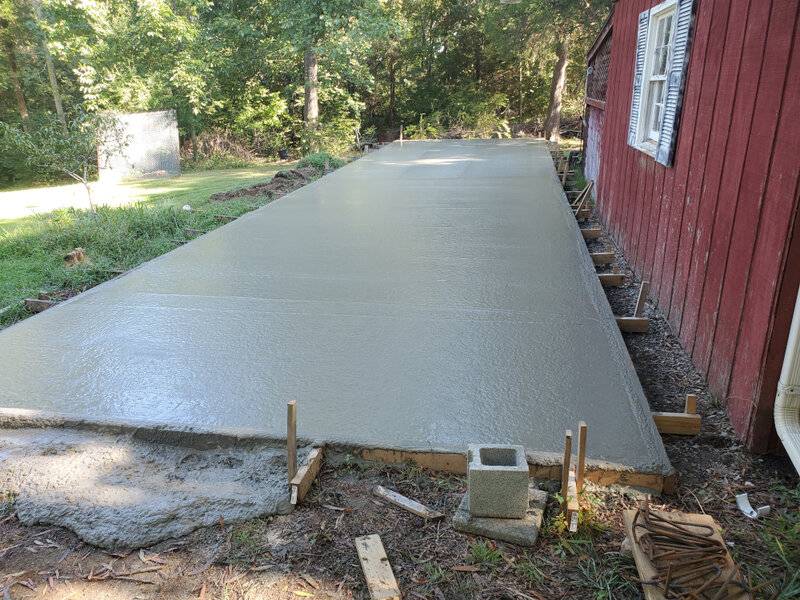

WOW . . . finally, I've got a pad . . . still needs some work . . .

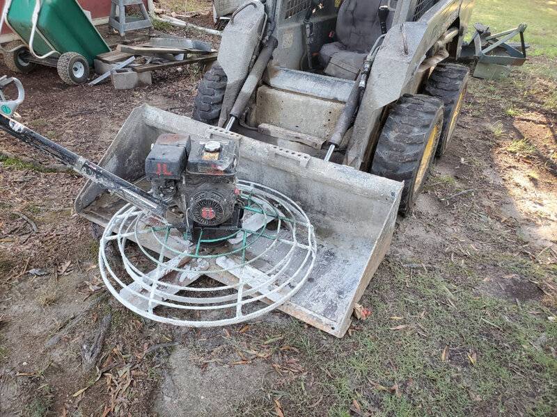

Polishing the back half that was put down first . . .

Sure is a sight ( or site ) for sore eyes . . . glad to see a pad for a start of my shop . . .

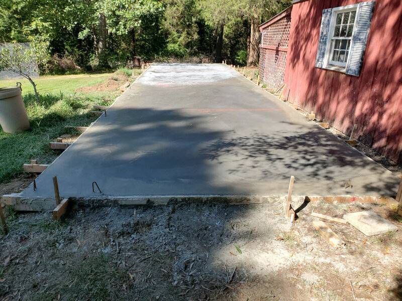

And the finished product . . . already pulling the forms off of the pad . . . and getting ready for blocks . . .

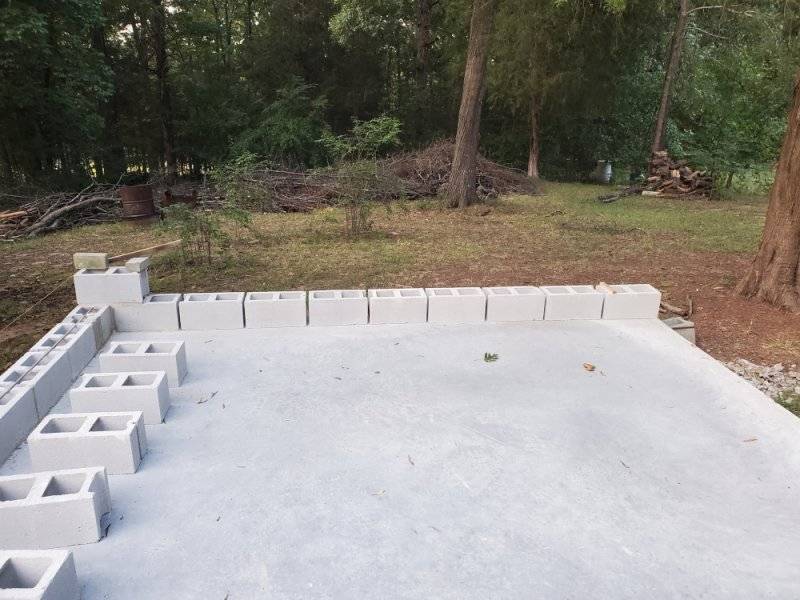

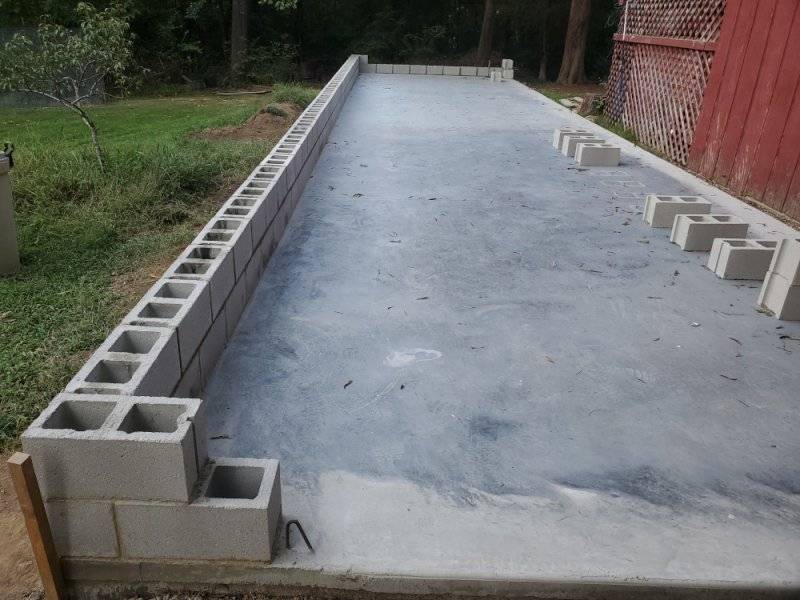

More progress on this project . . . Setting up for setting 2 courses of blocks . . .
With the pad finally in place . . . it's time to get started on the bloc walls to protect and elevate my walls so that
they are not so close to the ground ( and give protection from sparks in side the building too ) . . .
The poor old man's hind quarters are not what they used to be . . . but he still keeps e company . . .
Got my line in place . . .
The morning session of setting blocks . . .
And the Afternoon session of setting blocks . . .
Got 3 corners set up with 2 courses . . . and deciding on "how" I want to do the openings to center shop area . . .
Hope to be able to get this blockwork done ASAP and get to building walls . . .

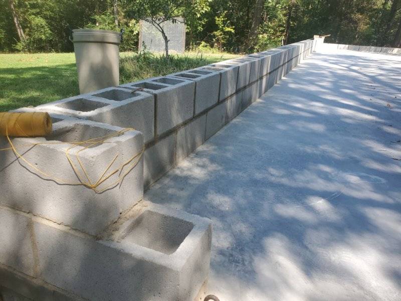

With the first course done on this side - it's now time to work on the second course . . .
More progress on this build . . .

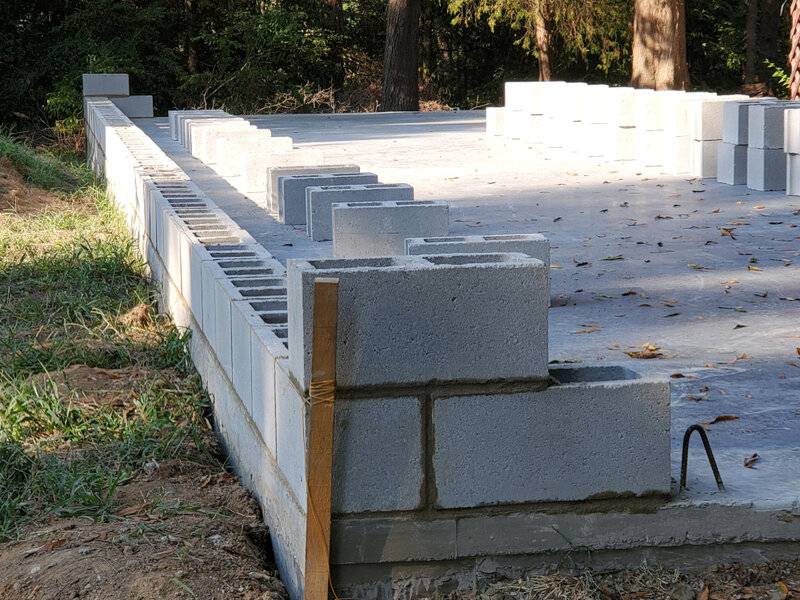

On Friday I got this done . . . cut grooves in the block to accept rebar . . .
And I got the blocks spacing figured out for the end wall . . . so it will be evenly spaced . . .

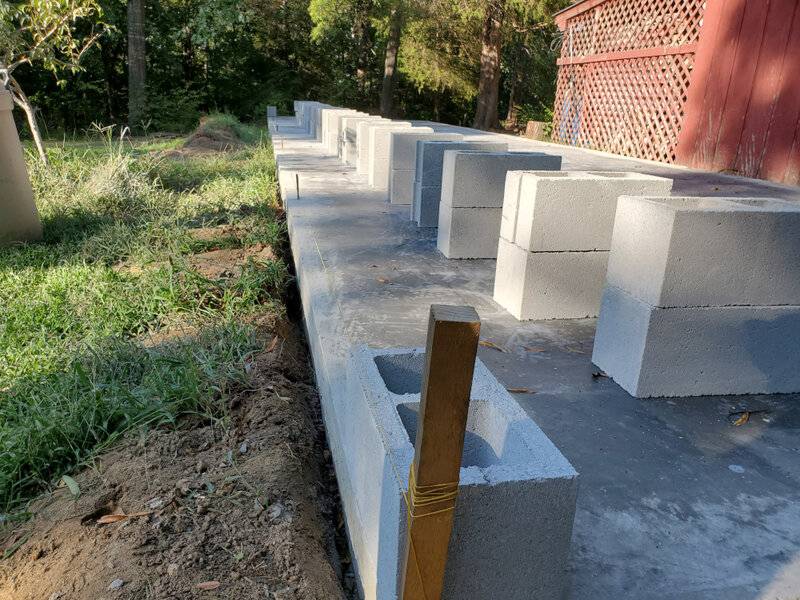

Started working on the second course . . .
Progress moving along quite nicely . . .
this was the end of the morning session . . . got quite a way on this wall . . .
After lunch I got the side wall and end wall mortared in place . . .
Got the corner 2 courses tall to be able to run the second course on the end wall . . .
And started to fill them with concrete . . . yeah, more 80 pound bags of concrete being lugged around . . .

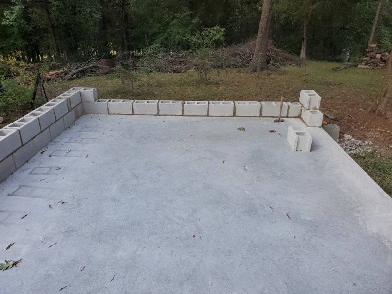

Wish I could get more done, but it's getting dark faster . . . got this done after work . . .
Not much, but every little bit gets me closer to getting this thing done . . .
Only one wall left . . .
Hope to get the ( at least ) the first course of it done this weekend, and the blocks filled with concrete . . .
And get the anchor bolts set in the concrete too . . .

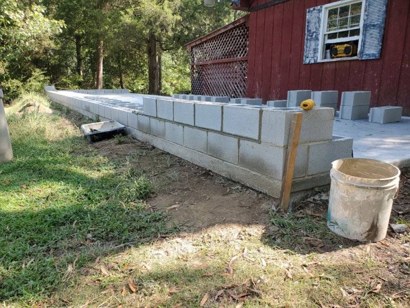

Making progress . . . but lugging 80 pound bags of concrete mix, and buckets of wet, heavy concrete . . . UGH !

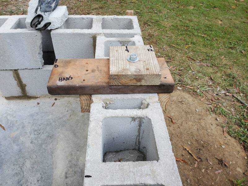

First of all to set the anchor bolts into the concrete . . . I made this jig to set the depth and keep them properly vertical . . .
( well . . . it kinda worked . . . had to make a slight adjustment to the jig . . . )
got 2/3 of this wall done, and the anchor bolts set . . .
Got the first course of this and the back wall filled with concrete . . . ready to do the rest later / tomorrow . . .
