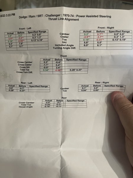

Got snake bit today taking the 71 roadrunner to “a good alignment guy” 30 year professional. Bull shat. Took two days and when they handed me the print out I alerted them to the clear out of spec caster.
Tech said it’s as good as he can get it and it drives fine. Well I’m pissed at this point and I just decide to pay and leave. Car is dangerous to drive. Incredibly difficult darting around. Not sure what’s next other than getting my 173 dollars back tomorrow and finding someone else. Totally rebuilt factory style suspension. Do I need adjustable uppers and strut rods to be able to find an alignment guy to make the car usable.

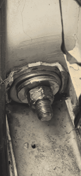

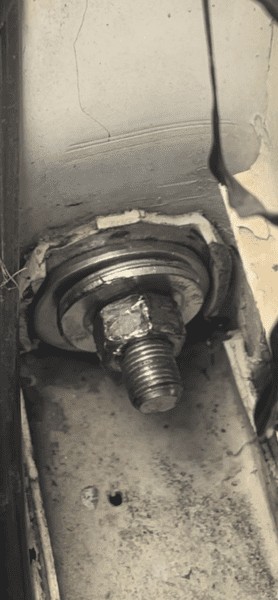

This is the passenger rear upper control arm bolt. Seems there is still plenty of movement to the left which would I think pull the upper ball joint to the rear for postive caster. Going to check the upper to make sure they are on right side tomorrow. Sure I have them right. But I will take the advice and double check. Thanks.

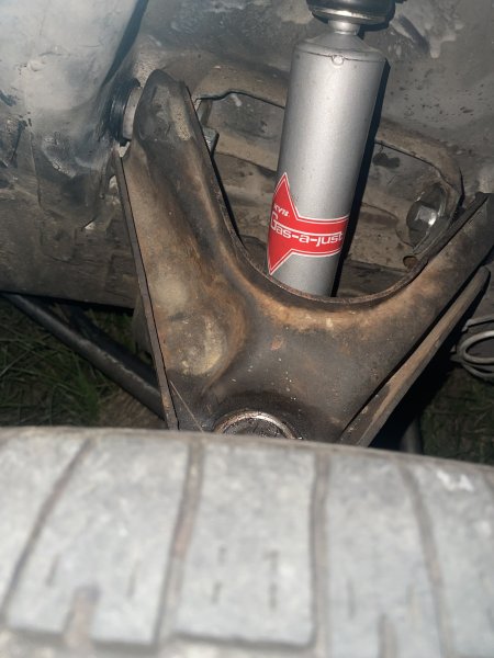

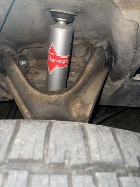

With the numbers that far off something is really wrong and the only quick logic is the upper arms. Post a pic of your arms.

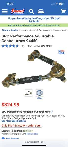

Those SPC UCAs are the ONLY non-QA1 part in my front suspension.
Why? Because ONE TIME hearing "You don't have enough adjustment capability in your factory UCAs" was enough for me. I will only add that I was unaware of offset bushings.

They look right. Did you install off set upper bushings?
No, this does not look right.
There is no eccentric washer and the hardware is not correct in the slightest. The bolt is dead center in the range of adjustment with no way to adjust. A smart alignment guy would have seen this and immediately stopped work since there is no adjustment with this piece of junk bolt, nut and washer combination.
Good point! It should look more like this...
