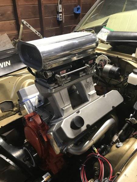

Update: Connected up the wiring and started the car up. I still have to clean-up the wiring a bit, wrap it or put in a loom.
Took a short drive and pretty happy with the FiTech so far. I set the ignition timing tables for 30 degrees so I could double check the distributor install position with timing light and adjust the pickup inductive delay (VR Advance 4000 in the FiTech menu). I must have got the base timing really close, I did not have to adjust the distributor. It was reading right at 30-degrees until I really brought the RPMs up and the timing light showed the timing advancing a few degrees above 4,000 RPM. Changed that VR Advance 4000 from 17.5 to 15, and now it was holding a steady 30-degrees through the entire RPM range. I then programmed the ignition curve back in near what the stock settings were.

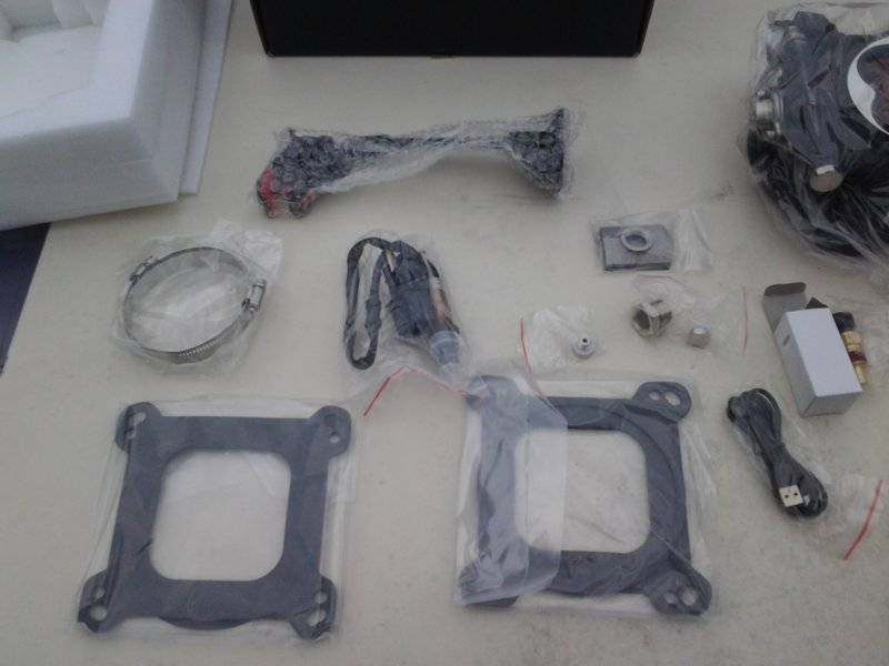

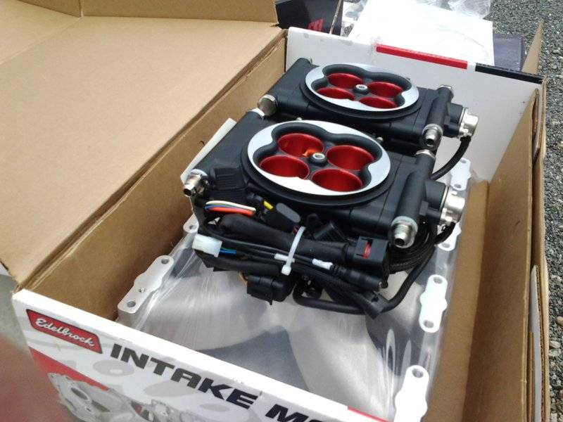

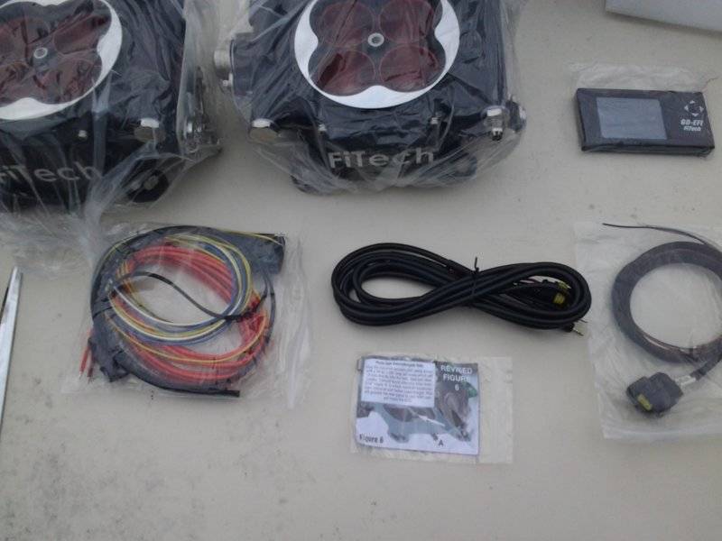

My FiTech Dual Quad system arrived today! Pics tomorrow!
That's cool. Have to let up know how the dual quad works? Does it use a single TPS sensor and computer with just another harness from the TBI with computer to drive the injectors of the other TBI unit? Picture looks like each unit has a pressure regulator and is plumbed with separate fuel supply and return connections.

FiTech dual quad 1200 hp pictures
