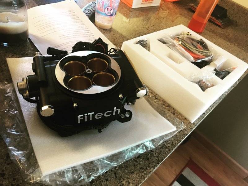

The only thing that I can see that I'm not pleased with is that there is just one 02 sensor included in the kit. I ordered two collectors with 02 bungs assuming that the kit would have two. I can't see how it can accurately tune an 800hp dual quad Hemi with a single 02 sensor? I don't know if they offer a kit to add a second sensor or not. You would think that for 2 grand you would get two sensors in a dual quad kit.
My FiTech Dual Quad system arrived today! Pics tomorrow!
Quick question, is the harness simply a jumper to the second FiTech unit? You're essentially just increasing the overall capacity by (x) amount of lbs/hr fuel supply with the additional injectors. I would think that you would need to upgrade to something like the Holley Dominator EFI system in order to correctly tune with (2) WB02 sensors.
