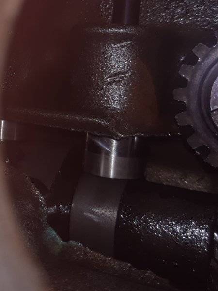

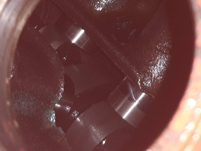

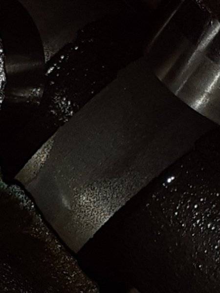

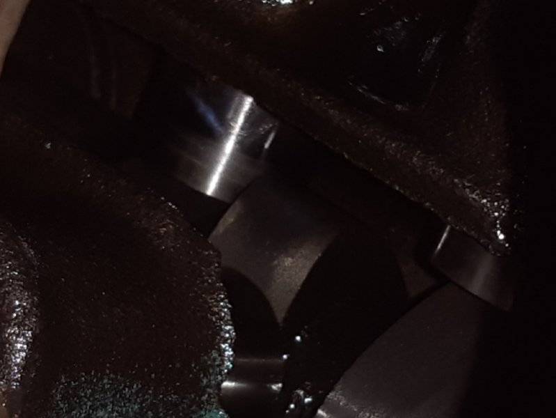

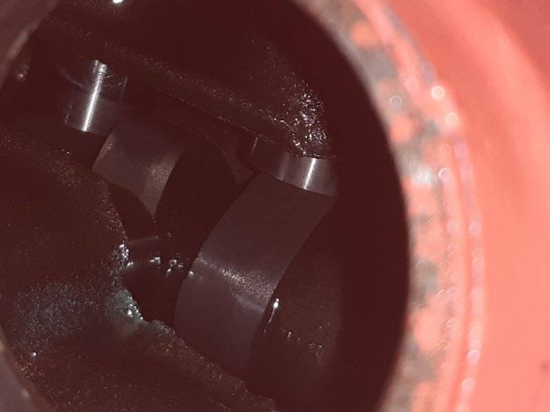

Hi! I broken in my camshaft xe275hl in my new built 493cui stroker in July this summer with succes, i use Joe Gibbs break in 10w-30 oil and have shange the oil and cut the K&N oil filter open a few times under the 400 trouble free miles i have on the engine and find no metal or any debris in the filter any of these times, all lifters are spinning and so on. I have checked the wear pattern on the cam lobes and they all looks the same like i show in the pictures here, looks normal to me, what do you guys think? The engine running great.
Looks normal wear pattern to me.

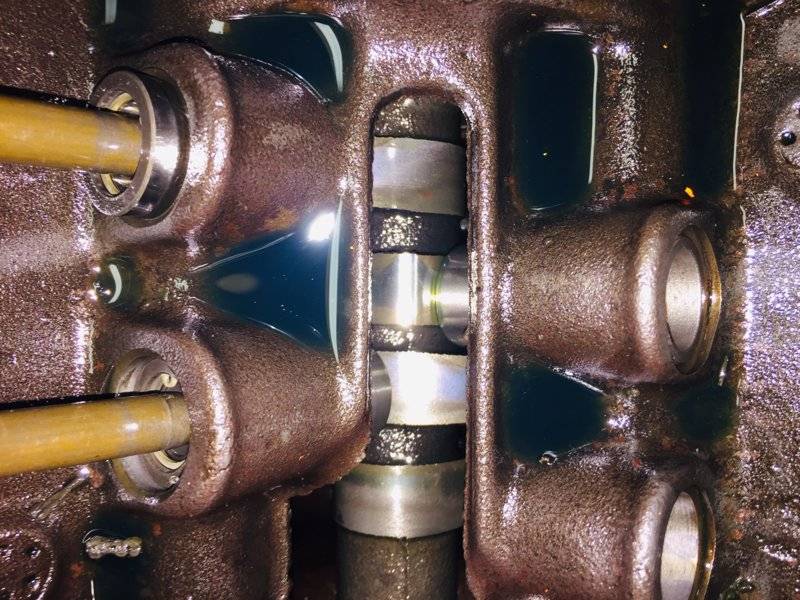

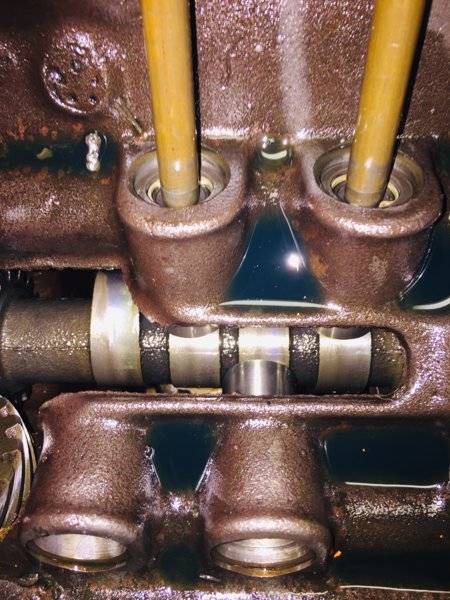

See my pictures, this camshaft has been in there for years (don't know how many miles) and you can see a similar pattern but more obvious then yours.
The cam lobes and contact face of the tappet are not flat but slightly rounded, therefore you do not see a evenly wide sweep.
The rounded face causes the tappet to rotate which makes sure there is even wear.

Thanks for answer! Yes it looks pretty much the same and normal to me to. The engine has go about 400 miles after break in without any problems so i belive its all good. It use to go pretty quikly with a camshaft if something is wrong so i think i can relax. Thanks
Indeed, if something is wrong there you would see damage/excessive wear directly.

Hi and thank you for your answer! Indeed its go quikly if something is wrong with the cam, i have drive this engine for 400 problem free miles now so i guess i can relax. I brake in the cam with Joe gibbs BR 30(10w-30 oil) and tap the oil out after 25 minutes break in on 2000- 2500 rpm, cut the filter open and no metal or debris, just little silver coulor in the oil from pistons, rings and cylinders. I change the oil to Joe gibbs HR 10w-30 oil with 1400 zddp in it, i have change the oil 3 times under this 400 miles and cut the filter open every time and find nothing in it so i guess my stroker build be a succes, the engine running great and have a huge low end power with this pretty mild 231/237@050 camshaft for my 493 cui, 10,03:1 compression ratio and 8,05:1 dynamic. I have now bought Lucas hot rod& classic oil 10w-40 with 2100 zddp in it, i think that be great for the engine. We have pretty much shops in here selling Mopar parts, Persåkers.se, Bigbadmopar.se, Hansen racing.se, Löven racing.se, Norrlands custom.se, ppm racing.se to name a few of them. When i build the engine i bought a lot of stuff from the states but that not always sheaper
Pictures are to dark to see anything. But if it made it thru 400 miles and vacuum gauge reading are good then feel lucky. Stay with good hi zinc oil and remeber not to use zinc additive must be hi zinc and moly in the oil.
Thanks! Yes i know the pictures are not the best. Yes 400 problem free miles and good steady vacuum reading, no metal in the oil filter, i have cut 3 of them open, change oil 3 times, so i think i can feel calm. The engine running great, yes only good oil, Joe Gibbs so far but im going to try Lucas 10w-40 oil now with 2100 ppm zddp
