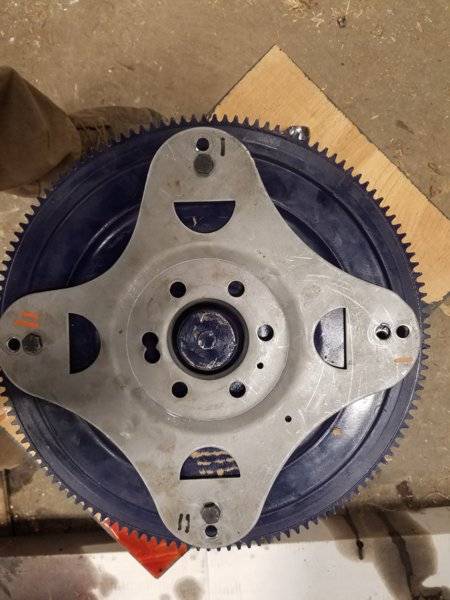

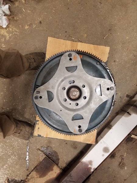

Here take a look.
1st pic is brand new B&M converter
2nd pic is old time ma mopar converter
It's not the Cheap Napa flexplate, it's the pos B&M converter.
I knew I should have went with Hughes.
The old converter will work.
It appears that B&M did not offset the one hole!
**** B&M!

B&M uses old, used, beat up OE cores, bought one from Summit and it was so beat up I sent it back.
