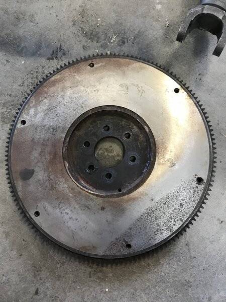

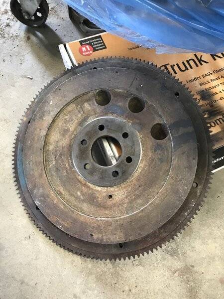

Does Any Company Make One Thats Externally Balanced That Will Work.. The Car Is A 4-Speed. Thanks Guys
View attachment 948617 Guessing This Flywheel Is Internally Balanced?View attachment 948616

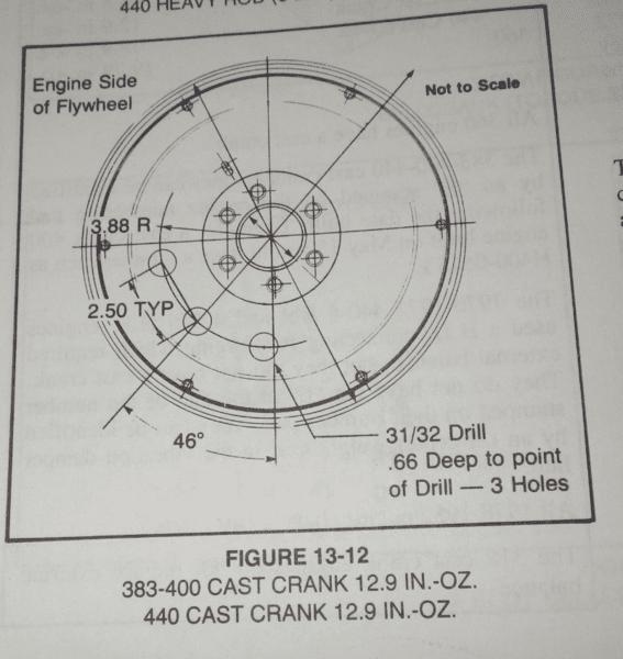

@dodge68charger , is that your flywheel? I agree with Daves69, that looks like an external balanced flywheel to me. Note the three 1" holes on the crankshaft side. Thats a good bit of weight removal, making the opposite side the heavy side for balance purposes, with the non-symetrical bolt pattern determining where the heavy spot is.
I have seen neutral balanced flywheels that have small holes drilled to fine tune balance, but nothing like what the one you show has.
Apparently According To Another Board That Is a Flywheel For a 360 Engine And Weighted Different
This Is a 440 Flywheel
The quick time plate is not a bolt on and go solution. They only make one for mopars and it can't work for all externally balanced engines. They all need a different amount of weight. The crank would have to be balanced with the plate attached and the plate trimmed as required.
Yup Thats The Flywheel I Found In One Of My Parts Bins. Just Wanna Make Sure Its Right For a 440 Before i Bolt It In.
Another Board Said Its For a 360 Engine.
I Know Brewers Sells Them But If I Can Save $230 Plus Exchange ( Im In ) It Would Help. Thanks Guys
If you can find a part number on the flywheel you have, give brewers a call. I dont have any stick shift stuff, so no personal experience, but they have a real good rep for helping out with info.

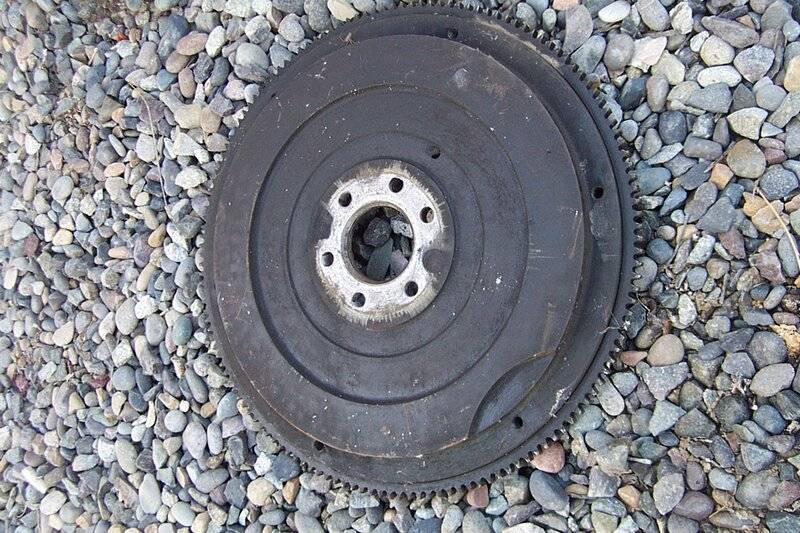

hi Dave i have a 73 Charger big block 400 with 4 speeds ( engine/trans combo were pulled from another 73 Charger that was originally auto ) , i have vibration at highway speeds and even sitting still especially when i raise my RPM , my flywheel is not like this one , just a simple flat one , no weights or holes ( i checked it from underneath the car ) and some told me that it could be the flywheel or pilot bushing is not even there ( judging by an old photo of my engine on the ground before installing it ) , help please thanks in advance
.......i have vibration at highway speeds and even sitting still especially when i raise my RPM.......

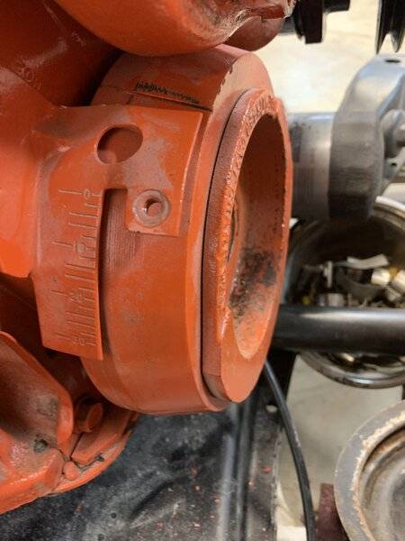

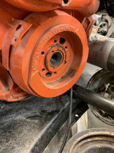

Verify what balancer is on it. Verify TDC. Check it for possible slippage if it's an 48 year old stock piece.

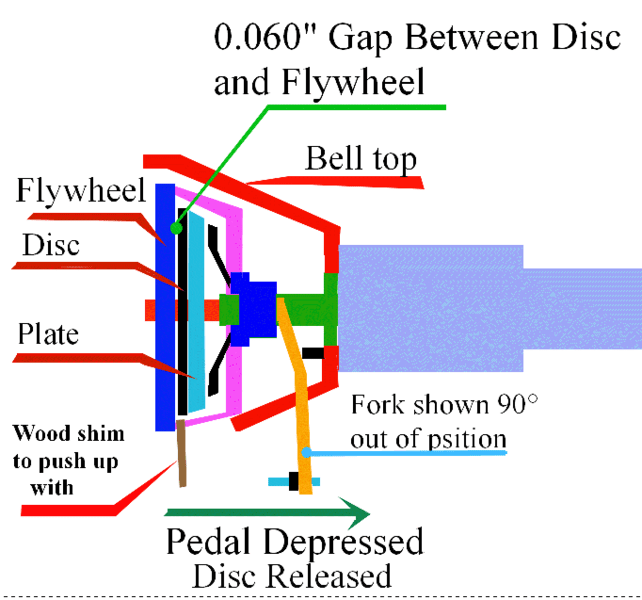

If a pilot bushing has come out of the bore you may be able to move the disc up and down with a wood shim once the plate has released the disc.
BTW, You'd also want someone you trust to hold the clutch pedal to the floor for ya' if you try it!
