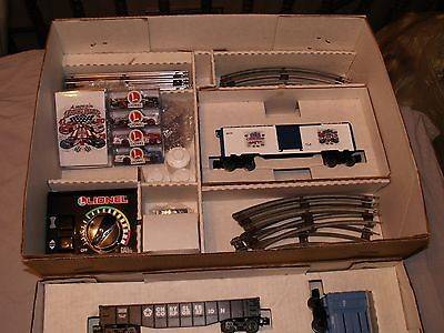

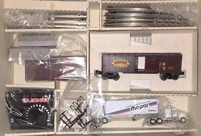

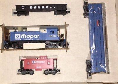

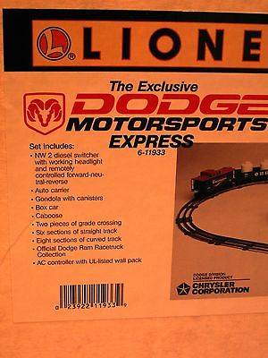

For all of You Train Lovers
Apparently they made a few different sets!
https://m.ebay.com/itm/LIONEL-MOPAR...662867&hash=item544606a8a3:g:ID0AAOSwB-1Y7XKy

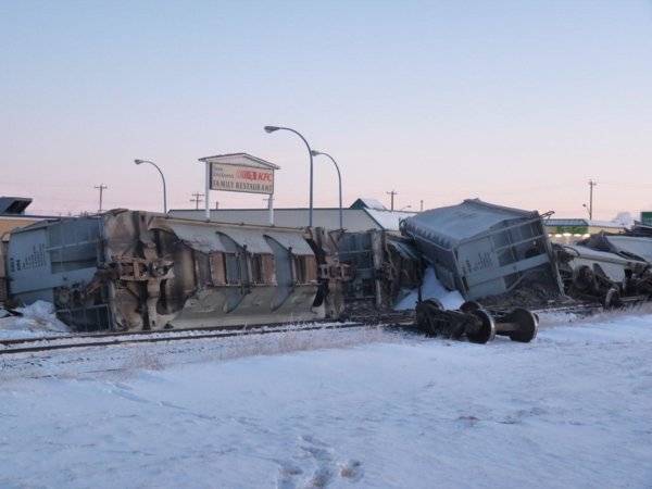

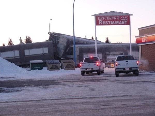

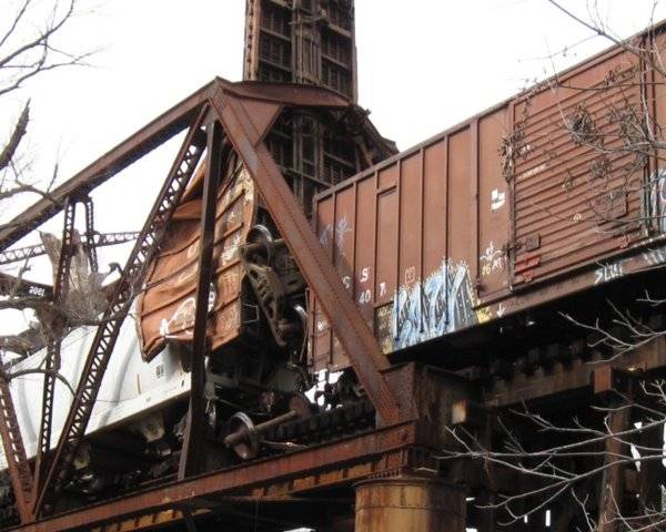

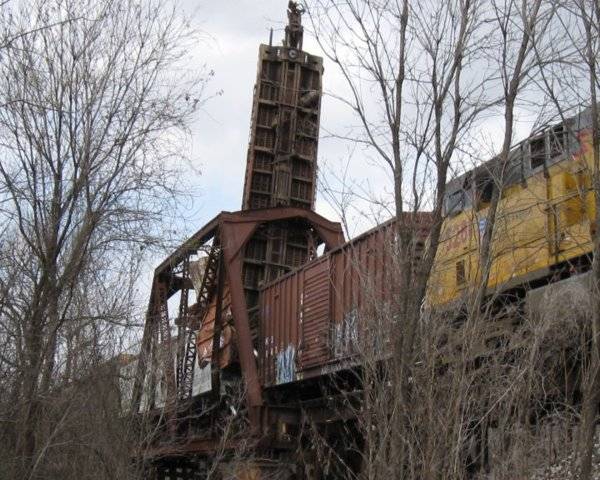

After a derailment jammed everything up on this rail bridge, momentum of a few thousand tons of rolling stock just kept on pushing and crushing...
One of my friends returned from cleaning up a derailment and described how one end of a rail car was driven nearly 30 feet underground.

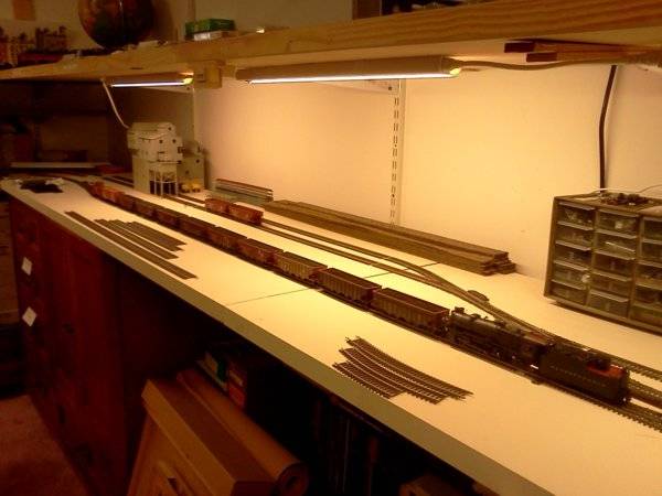

This is the coal mine scene.
Here I'm testing the passing track capacity.
I pan on having 10-12 car max length through freights.
I'll also have mine runs of about 9 cars.
The locals can be any length up to 12 based on need but will likely be about 6-8.
The track with the 2 hoppers and the one behind it will go through to the staging area, hidden behind a stand of trees. That way the empties can keep coming in and loads can keep coming out.
I just installed those LED lights. You can't see them if you're standing.
Lower level height is 38" Upper is currently 56".

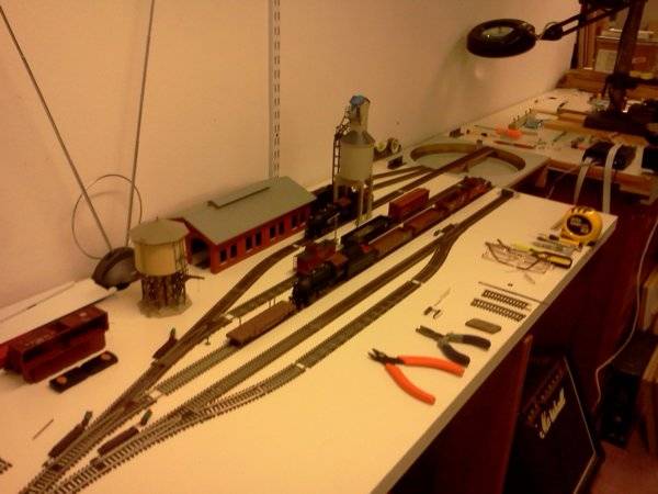

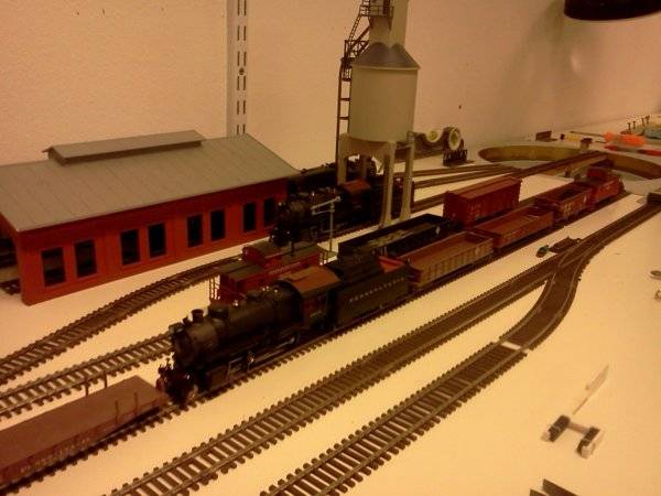

Here's temporary yard I put together, basically to test my new turntable indexer.
2 classification tracks, and an inbound/outbound track with a runaround.
About the minimum to actually operate.
Plus the service tracks to test the TT.

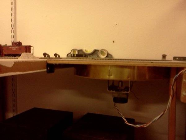

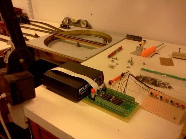

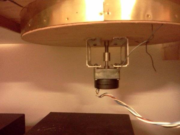

I just got done making the motor mount for the TT motor.
It's a stepper motor with a gear reduction head that has a final drive of .5 RPM and according to the MFG 65 ft/lbs of torque!
The breadboard with the push buttons selects the programmed track and the big button on the circuit board executes. The black box has the PROM with the control logic. I had to teach it where the tracks were.
Eventually that medium TT will come out, and a small pass station, maybe a small industry, and a passing siding for trains waiting on the helix will be constructed on those two doors. The TT will move to the top level, where the real permanent classification yard will be.

BTW post 11 is an M1 Mountain class 4-8-2.
There's a 1/87 version of one inside that engine house in the pic above.
That one set my pulling record at 68 cars...because I ran out!
The others are 2x H10 class 2-8-0 and L1 class 2-8-2. MUCH more suited to an environment the size of my layout.
They all have network cards (DCC decoders) with sound.
